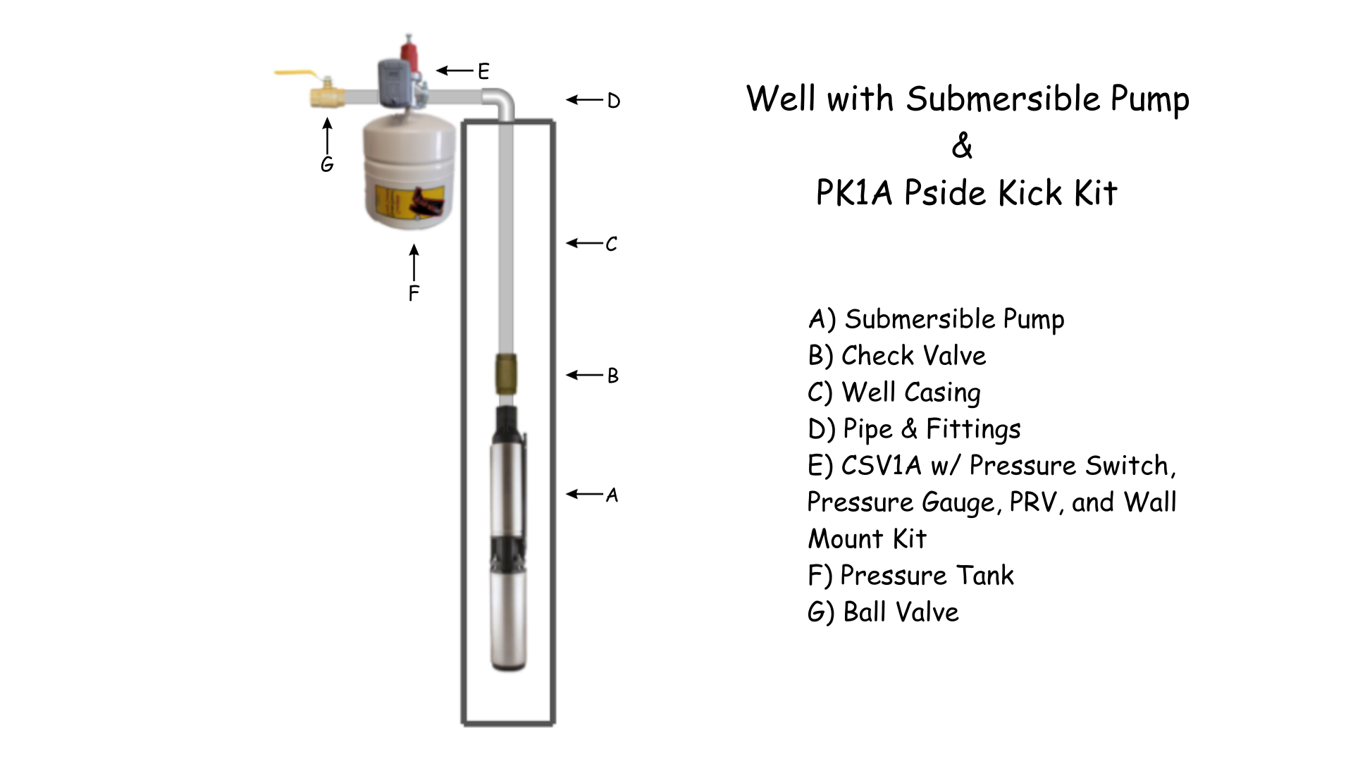

   / Well Pump Expansion Tank
#25
Well drilled in 2016
Production = 25gpm
Depth = 508 feet
Pump Depth = 485 feet
Static Water Level = 205 feet
Motor: Goulds VFD 3 Phase 3HP - 230 Volts – Range: 13GPM – 22GPM (max)
Drop Pipe: 1 ¼” Schedule 120 PVC with Stainless Steel Couplers -
3 Stainless Steel Check Valves @ Pump Head, 160 feet and 320 feet
So far so good on my well setup. No issues, good water pressure and good production.

Most pump manufactures build a check valve on top of the pump, but that's not a great place for it, it should be at least a foot above the pump, but that's not very practicle most of the time. One every 200'. If that's 4, then it's 4.
   / Well Pump Expansion Tank #29
I have learned in my many years of working with pumps, that recommendations made by the pump companies are for the benefit of the pump manufacture, which comes at the expense of the homeowner. What you can see on the pump curve is really the only facts you will get from the pump manufacturers. Product quality, run time, tank size, number of check valves, VFD's, and other things are recommended to maintain planned obsolescence.
There has always been a problem of a vacuum between multiple check. It is just a matter of time as to when a small problem with one check valve will cause the vacuum that makes the water hammer when the pump starts. Multiple check valves are just a Band-Aid for the problem caused at pump shut off. When a pump is producing full flow filling a tank or whatever when it is told to shut off, even 10 GPM flow will cause a 1" check valve to be in the wide-open position. The water in the drop pipe, be it 50', or 700' has to reverse flow for about 1" before the check valve closes. That much water slamming down against the check valve when it closes causes tremendous water hammer and damages the check valve. The best answer we had in the past was to install multiple check valves to split the water hammer load and backup each other when they fail. But using multiple check valves to prevent water hammer on pump stop, causes water hammer on pump start. Water hammer on pump start is worse than on pump stop as the check valves are open when the water hammer on pump start happens. The resulting water hammer is then free to travel all the way down and shatter the thrust bearing in the motor. It is also best to start a pump against high pressure as with a closed or almost closed valve. Multiple check valves cause a pump to start with very little load or even against a vacuum, which is not good for the pump.
Having only one check valve at the pump is the only way to stop water hammer on pump start and start the pump against full pressure. The problems caused by the check valve slamming shut on pump stop at the bottom of a 100' or 700' string can be eliminated with a soft stop of the pump. When using a Cycle Stop Valve the tank is only filling at 1 GPM when the pump shuts off. This means the check valve is only open the thickness of a piece of paper, and there is no water hammer when it closes, no matter if the pump is set 10' deep or a 1000' deep. I have installed single check valves on pumps that were set up to 2200' deep. You just need a check valve that is rated for the pressure and a soft stop to keep it from slamming. The pump will start much easier when there is only one check valve at the pump and no others in the system. A properly set VFD will also have a soft stop. However, VFD systems require special check valves with stems that keep them from spinning in response to the way flow comes out of a pump with reduced speed.

Many standard pumps, with extra-large tanks or other controls like the CSV, (not recommended by the factory) have lasted 30-50 years so far. I have one still working that I installed in 1982. You will never see a VFD system last anywhere near that long. I know, I know! "Look at all the fancy adds and marketing of VFD's by the manufacturers". Everybody that has a VFD wants to think they made the right decision. But eventually I hear most people say it was the worst decision they ever made.
So, 946 pounds of pressure on a single check valve??
You and I don't work in the same world.
Most check valves are designed to be operated int he full open position, not partially open. VFD check valves being the exception, but who uses a VFD check valve with a Cycle stop?

Yes, and 946 PSI is nothing for an oil field type check valve made for 3K PSI or so. Also, a pump set at 2200' needs to see 946 PSI on start up. Any extra check valves up the line would defeat the back pressure needed to keep the pump from upthrusting on start up.
You are correct a VFD check valve is not needed with a CSV. The varied flow rates from a CSV do not cause a spinning action at the pump like a VFD. Also, many VFD's like the sub/mono drive with the switch are hard on check valves as the check opens and closes every time the subdrive switch makes and breaks. This can cause a check valve to open and close 45 times a minute. For these reasons a better check valve is needed with a VFD system than a CSV system.
