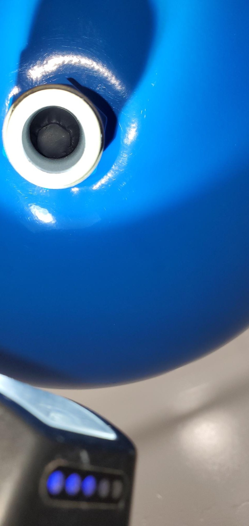

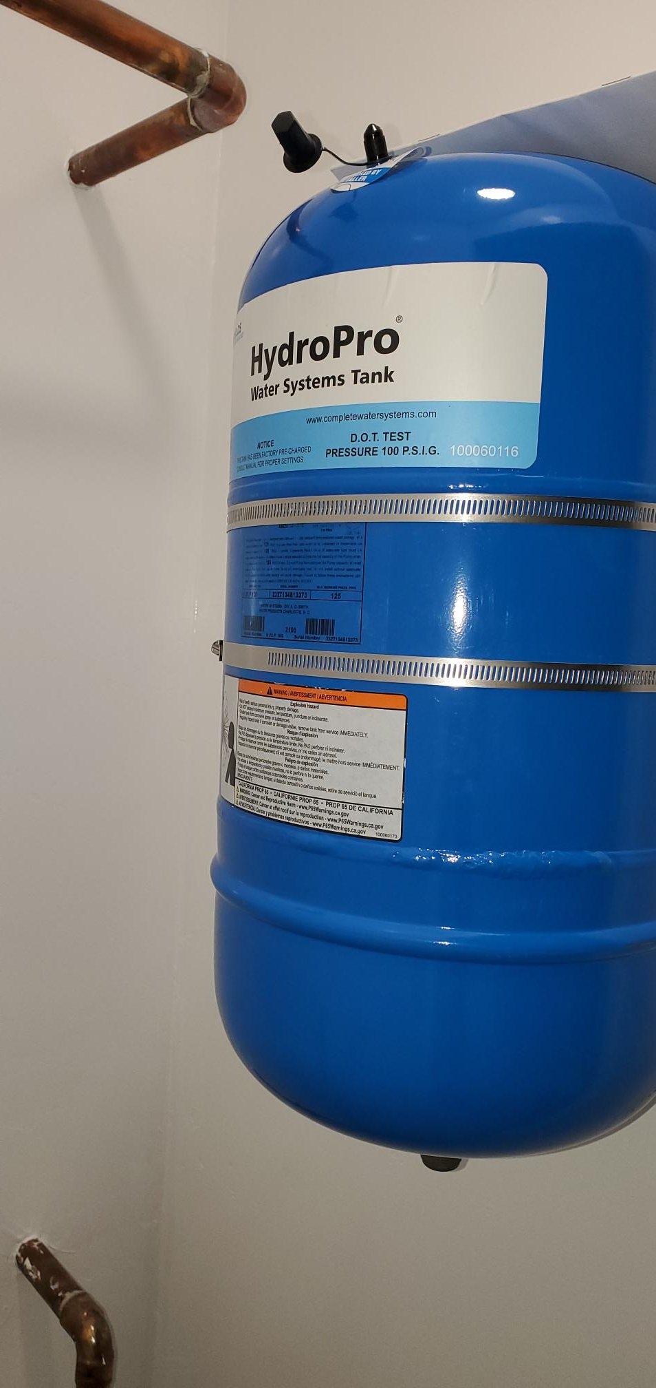

I got a new expansion tank for my well pump. Inside there is a plastic like cap and when I pushed on it, nothing happened. Is that supposed to come out or move? I don't want to install it and find out that I needed to remove the inside or something wasn't correct with it. It also looks like it's off center and not centered in the hole where the water line enters.
I took some pics to show what I am talking about.

You could go with Alan's suggestion. My pressure tanks are significantly larger than yours. At the top of mine is an air fill like you'd find on your car or tractor tires. The appropriate pressure before you add water is a nominal 30 psi. Actual preferred pressure depends on your system pressure, the tank instructions should clarify. The lower opening is the water input. Mine is a 1 1/4 pipe thread to mate with my supply.
/ Well Pump Expansion Tank #4
I think the usual setting is 2-3 PSi below low pressure cut on.
The op's picture is an odd one, least to me. I've never seen a pressure tank without a schrader valve to charge it. That second pic, is it looking down actually inside the tank?
/ Well Pump Expansion Tank #5
Yes, as Roadworthy said, there should be a Schrader valve there. And as mrmikey already noted, it should be charged to 2-3 psi below your well pump pressure switch cut-in pressure, when the system is de-energized.
I'm not sure what you have going on there, but a condom of some type over the Schrader valve is normal, to keep it clean, as these things go many years between re-checking in most applications.
Yes, the 2nd pic is looking inside the tank from the bottom, where the water line connects to.
These smaller tanks are for constant pressure VFD well pumps. They don't require large tanks.

The tank's minimal docs say they're pre set at 40 psi from the factory. I think I'd leave it alone.

That piece that you refer to is a reinforced piece at the bottom of the bladder or it's where the bladder was formed...possibly both. I presume it's there so that you don't wear a hole in the bladder and lose your air charge should the 1" nipple protrude into the tank too far or if someone starts poking things into the tank.
That's a normal way to deliver them, but doesn't imply they shouldn't be adjusted. 40 - 60 PSI is a very common well pressure switch setting, and it's easier for a plumber to relieve a few PSI during installation, after checking with a gauge, than to haul a compressor or pump down to the basement to charge the thing. And if you're one still running 30 - 50 PSI, also easy enough to let 12 psi out thru the valve.

The plastic thing in the bottom is part of the tank, leave it be.

Looks like a double cap on the Schrader valve. That other part should unscrew the same as a cap on the stem of a car tire. As was said, with most VFD constant pressure systems you want the air charge 30% less than the water pressure set point. It doesn't really matter how large the tank is when using a VFD. The slight drop in pressure needed to energize the pump means the pump will come on after using a cup or two of water no matter how large the tank is. That is just one of the many problems associated with a VFD constant pressure pump. The tank bladder probably went bad because of the VFD as well. The tank bladder doesn't move far but is continually moving a little as the VFD never really locks into a set constant pressure. Changing it out to a CSV constant pressure system will make your life easier and save a lot of money over continually replacing those expensive electronic VFD controllers. The Cycle Stop Valve is designed to make pump system last longer while delivering strong constant pressure. The VFD systems are designed to make money for the installer and pump manufacturer.
