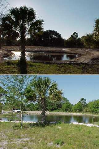

Amy, my daughter, and Zoe and Erin, my granddaughters, enjoying the filled pond.
The next project is to smooth out the banks and get grass established.

This view is from the other side, towards the spot where the kids were playing. Our house will be on the right, facing the pond. The float valve is in the foreground, doing its thing. The PVC support is temporary while I establish the "right" level; it will be supported from underneath when complete.
