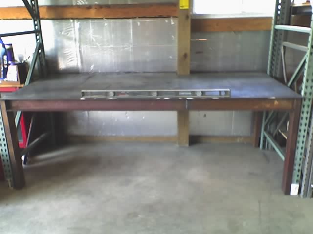

I have four lengths of six inch flanged ductile iron pipe just waiting for some I-beam and a thick plate to make a table. If and when I get some decent space to set up, I will set up one end with alternating square tubing instead of solid table. That is, open space equal to the tube stock so I can slip hold down clamps through the gap.
That limits welding to the table but I would still do that as required. I don't wax my tractors either. Heck, if I wax my vehicles once a year, it would be a "weak moment". LOL!

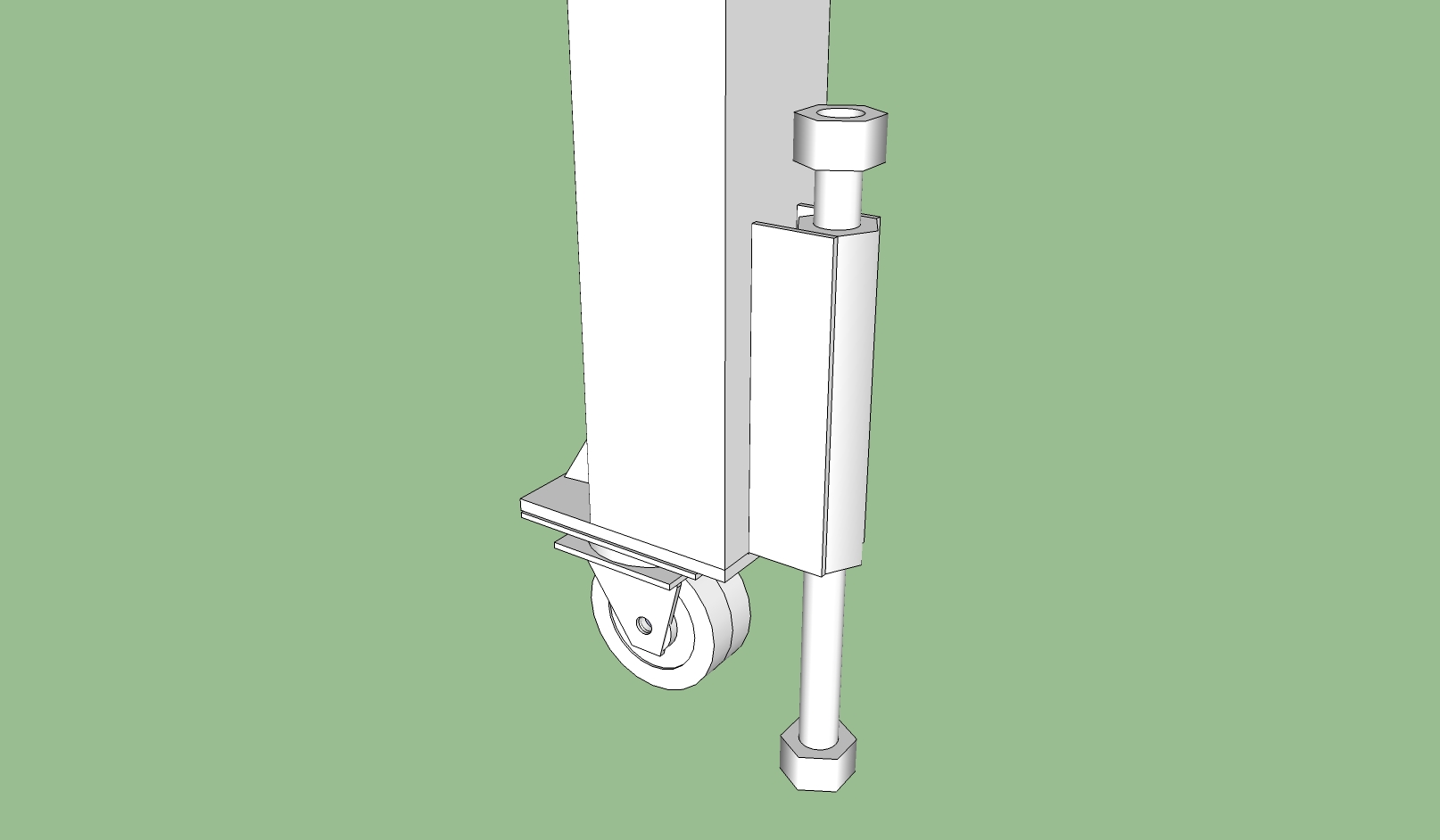

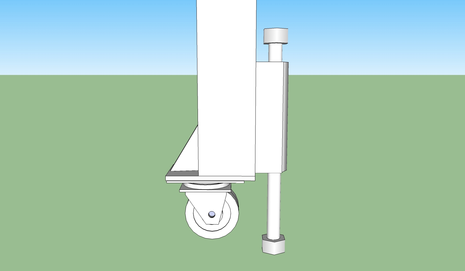

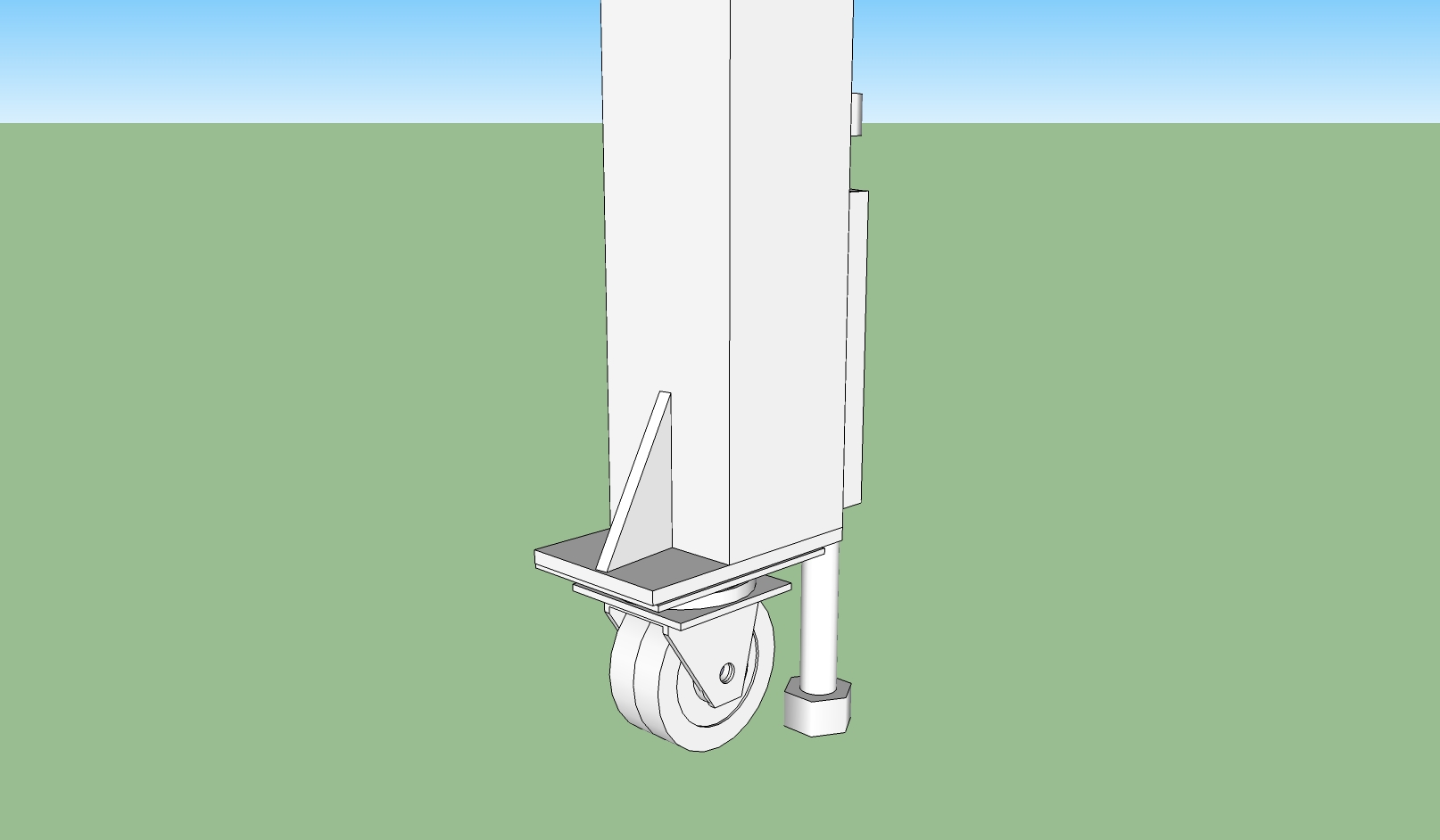

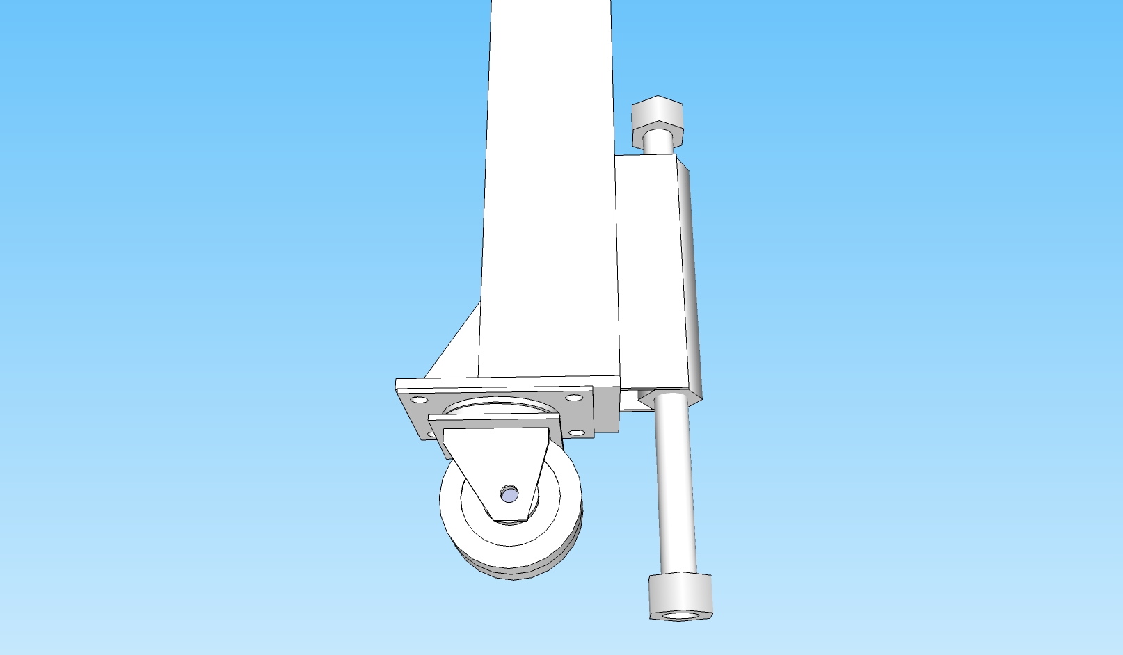

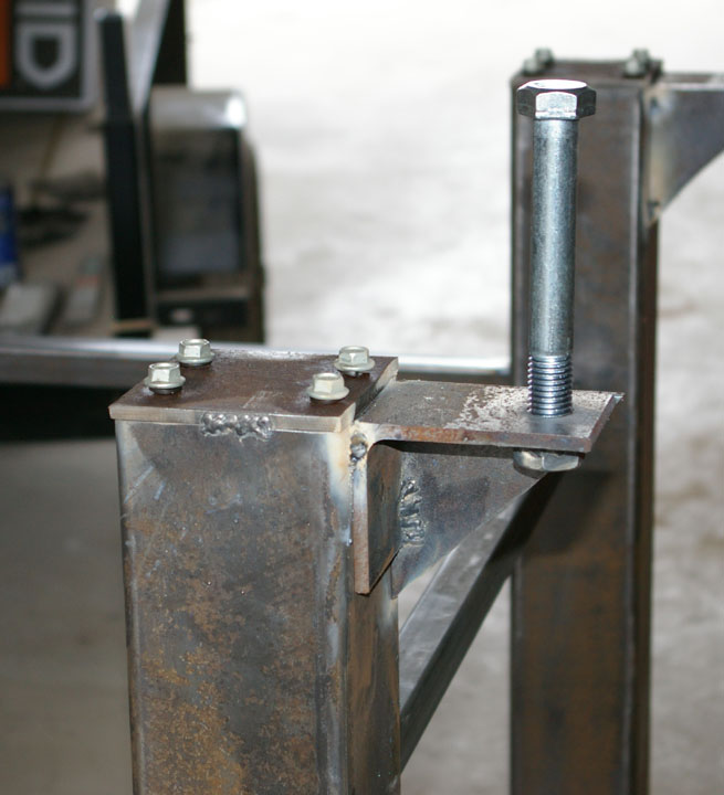

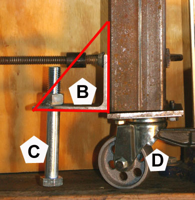

i like the looks of that setup a little better. i'm sure the angle with the bolt will also work fine, but i wouldn't be surprised to see it a little springy at times, and maybe even bend a little over time. just your table top weighs 500lbs, and with all the support pieces you must be coming in at around 1000lbs for the table (i'm too lazy to add it all up). then put a several hundred pound metal project up on the table and you're getting into some real weight being supported by those legs. like i said before, i'm sure it will work fine as the original poster envisioned it. maybe i'm just a little fussy. at the lest i'd probably put a small stiffener in the angle near where the nut is welded to it.[/QUOTE]
My estimate puts the table at about 700 to 750 lbs with nothing on it. I should be able to go as high as 1000 without damaging my casters.
Been thinking about that too. I'll probably put a gusset in there.

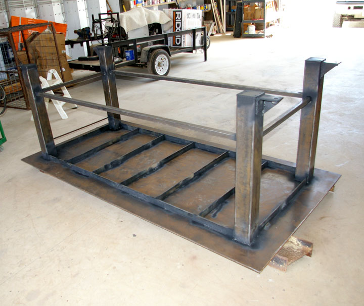

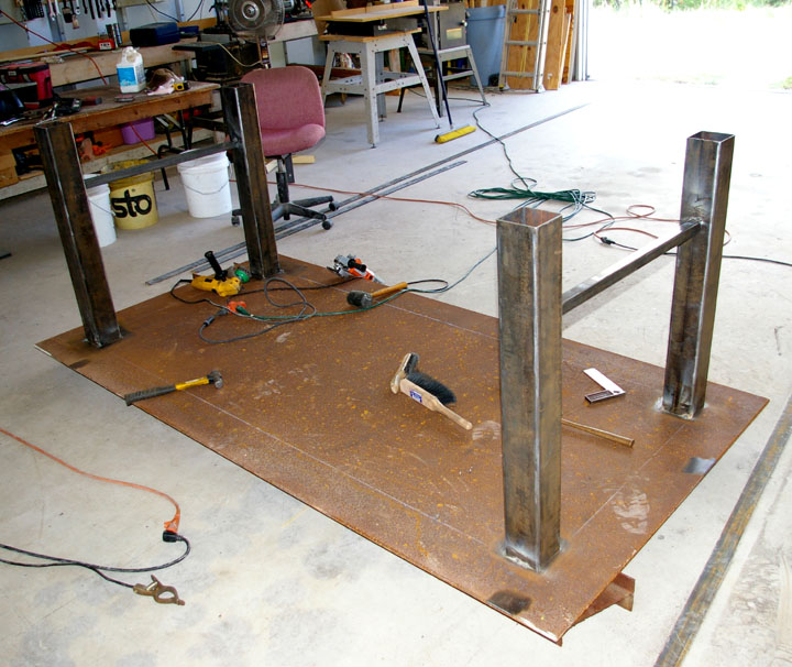

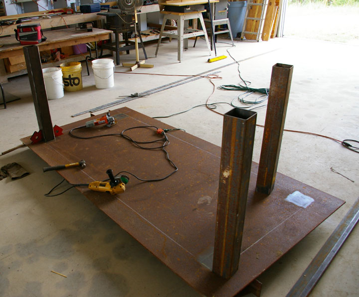

All of the steel is here now and the work begins. There have been a couple of changes. The place where I get my materials never got the order so a few changes were made, all for the better too.
The legs will now be made with 4"x1/8" square tubing.
Work began by cutting the legs, the table will be 38" tall since all the work will be done while standing. Once cut, they were tack welded to the top.

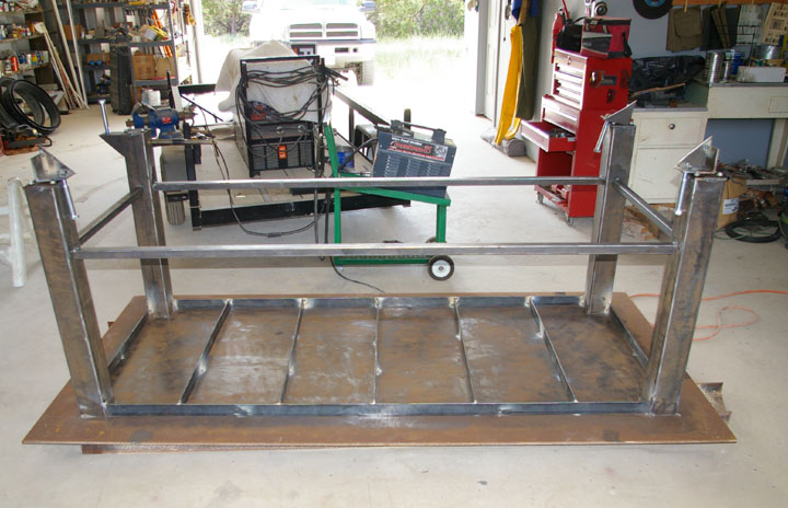

#25

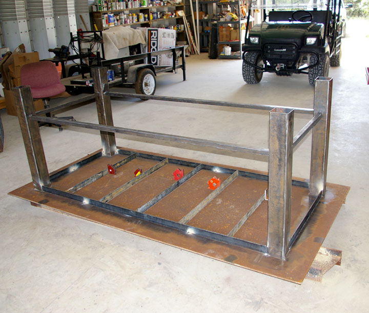

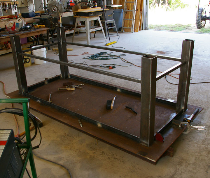

The spreaders were cut and tacked to the legs. They will be 13" from the floor.
Next came the external stiffeners.
/ Welding Table Build
#26
Once the internal stiffeners were cut, they were fitted into place. They will be spaced at 14" intervals for a total of five. The rust on the underside of the table top still needs to be cleaned off before they can be tacked in place. Had to knock off working at this point to go help out a friend with a computer problem.

#30

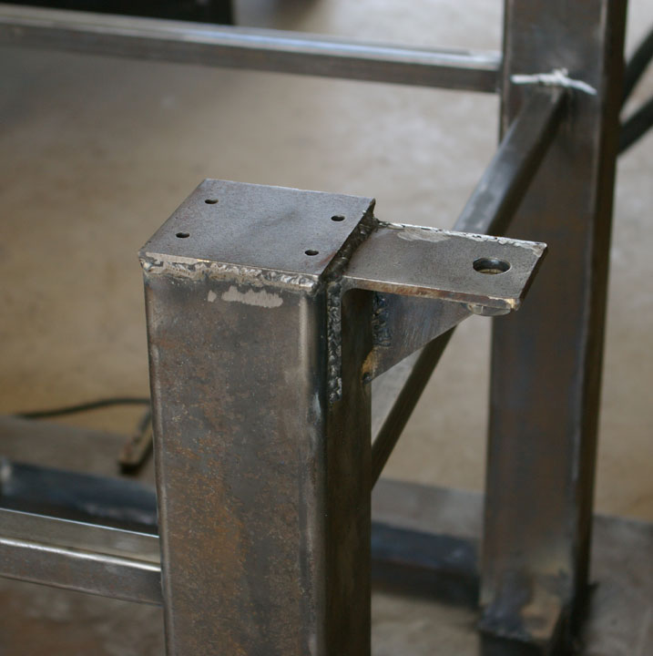

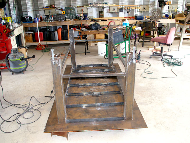

Had a good day in the shop today. Tack welded all of the internal stiffeners and added gussets to the leveller/brakes.

Finish welding began. My approach was to finish the legs one at a time. First the leveller/brake was welded in place, then the caster mounting plates, the spreaders and finally the external stiffeners.
The wire feed welder didn't like it to much when the temperature went over 90 and I exceeded it's duty cycle, so it shut down. Not wanting to waste time waiting on the wire feed recycle, I cranked up the Hobart and started finish welding the stiffeners to the table top.
You may notice that there are no close up shots of my welds. If you don't understand why. just go back and read the first post.
By the end of the day, two legs were finished and about half of the stiffeners. This baby will be finished this weekend. Waa-hoo!:thumbsup:
Still haven't figured out how I'm going to turn this thing over without damaging something or killing myself. Any suggestions?

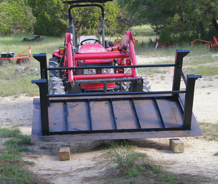

/ Welding Table Build #33
I like it.
I still would round off those corners and attach a flat surface to them to blunt the point.
I'm one of those clumsy types that bump into things all the time. So often in fact that I end up with owies and no explanation. This irriates the heck out of my wife because she believes that if you bumped into something hard enough to leave a bruise then you have to remember it.
As for turning it over, I think I would pick it up as is and take it outside, assuming you're using a tractor and forks. I would turn it over on soft soil, maybe the lawn if mama isn't the mower of it. Then I would pick it back up and haul it back in right side up.
If you're using a winch and the ceiling I would build a set of saw horses like I do using two and seven eighths and two and three eighths pipe a little taller than the table. I would then turn it over on the saw horses.
What I do is use a one foot piece of two and seven eighths. I weld two legs on to it so the one foot piece is a sleeve. I make two of these units and then I can place a piece of two and three eighths inside the sleeves and have a saw horse. I use these a lot on jobs when I've got two and three eighths posts. When I'm done with the sawhorses I've got some posts left to use.
Good luck and keep the pictures coming.

Once it is turned top side upside the corners will be cut off. I'm one of those with the unexplained bruises too. Guess it is being just plain clumsy.
The hay forks on my tractor can be used just like pallet forks. will go with the soft dirt method to turn it.
I like your sawhorse idea. Lots of possibilities that go with it. Thanks.

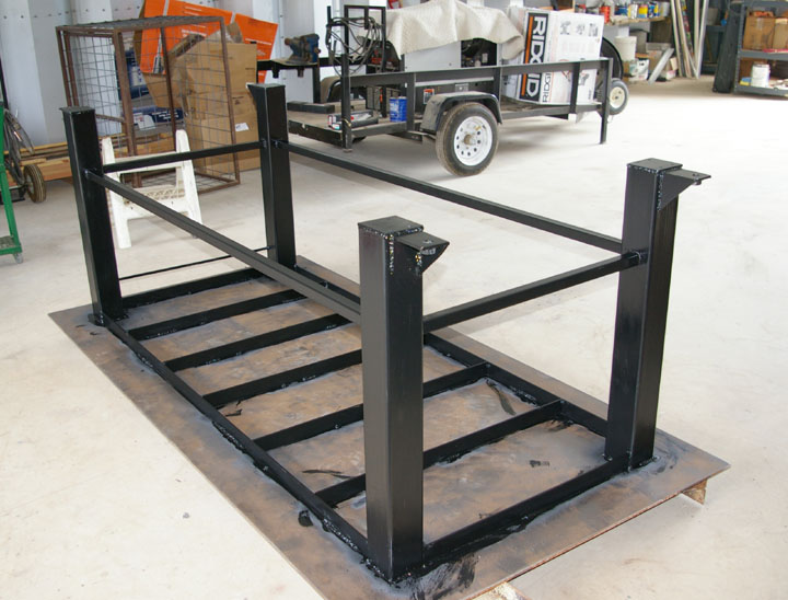

#37

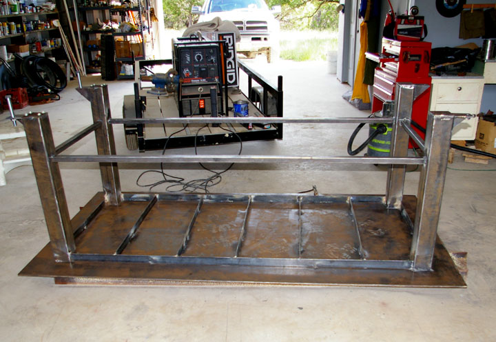

The welding is finished. Once the welds were cleaned they were primed and the frame painted with Rustoleum black, satin. Using the words of that great TBN philospher, Eddie Walker, "The grinder and paint really help a lot in hiding my lack of welding skills." ;) http://www.tractorbynet.com/forums/...81191-barebones-mule-your-suggestions-11.html
The bar to hang clamps was added and I drilled and tapped two holes to mount a six outlet extension. Then all I will have to do is run one extension cord to the table.
Tomorrow is the big day. SWMBO, the tractor and I will turn this critter over and we'll see if all that welding warped the top.
We are going to use Harv's suggestion and take it out on the dirt to turn it. Cross your fingers and wish us luck.

#39

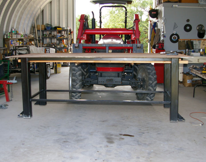

We managed to get the table turned today. Don't know what I was all that worried about, it went without a hitch. Of course, by backup was SWMBO and our Mahindra 4500. Piece of cake.:rolleyes:

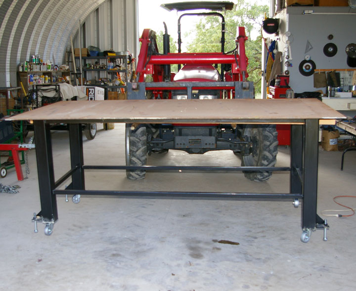

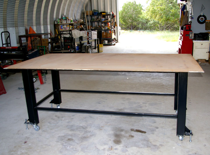

#40
While the Mahindra held the table, we installed the casters and 6 inch bolts into the legs. Then came the first test. We set the table on the floor and to our great relief, nothing collapsed or broke. :)
The next test was to see how easily it rolled on the floor. Again, to our great relief and pleasure it moved as though it was on ice. :D
Finally, we turned the leveller bolts down to act as brakes. With just a quarter turn more on the bolts after they made contact with the floor, the table was solid as a rock. :thumbsup:
