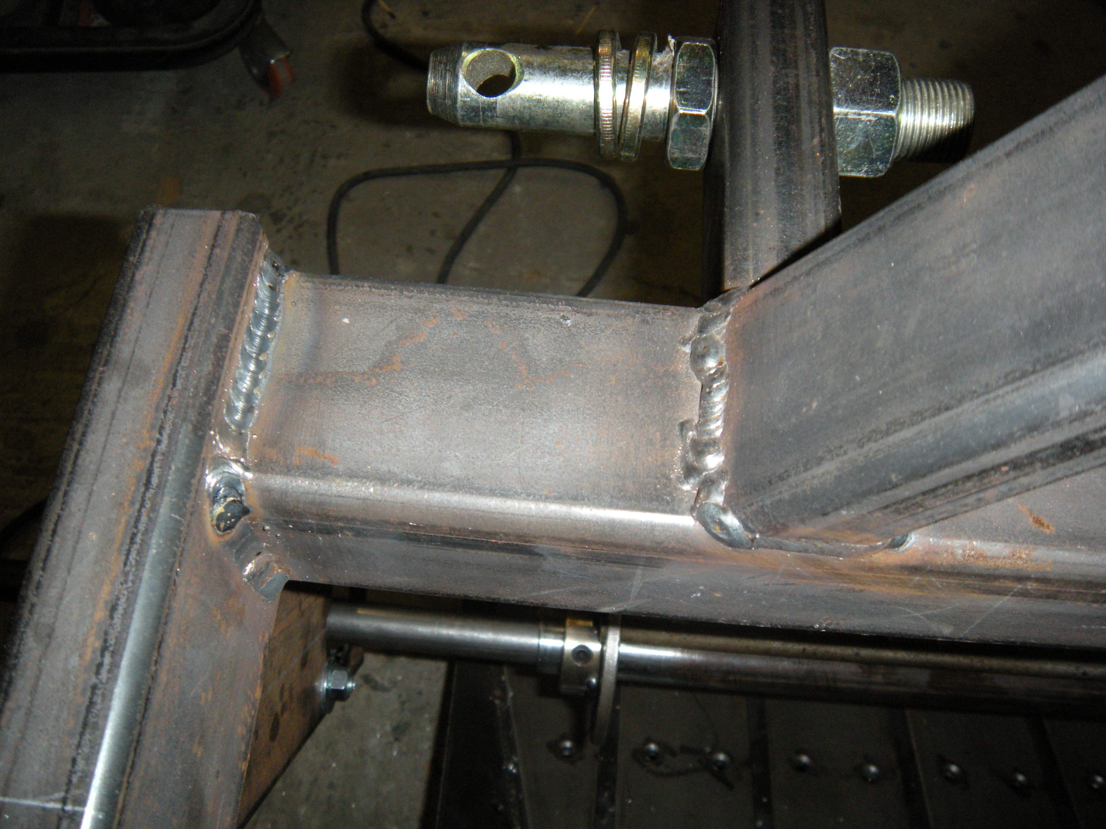

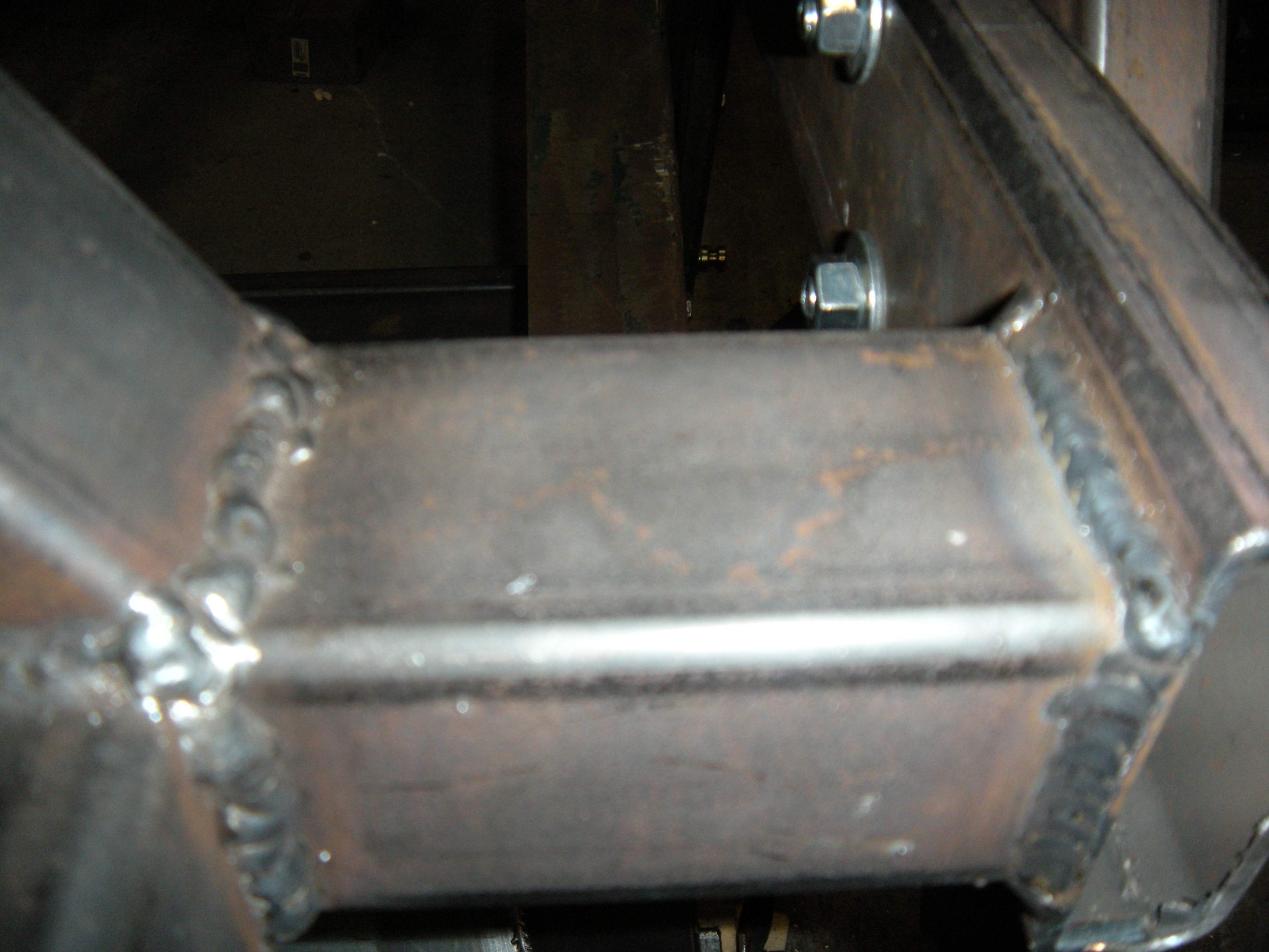

Hey guys, Im a self taught welder and kinda learn by doing. Sometimes I can make really nice looking welds and then the next bead will look like krud. I mean within minutes its like a three year old did the welding. I dont change the settings, wire speed, gas, or anything. Am I holding my mouth wrong, Thinking impure thoughts, did the planets mis-align. Im really baffled. See the pictures below for what Im talking about. These beads were done minutes apart. Oh, I weld with a miller-matic 135 mig welder. Its a little 125 amp 20% duty cycle machine. Any thoughts would be appreciated,,,,,,Thanks

What's your gas flow set at?
I'm certainly not an expert weldor like some folks, but I believe this is mostly a matter of moving the gun smoother. Maybe slow the wire speed down a hair and move slower, and support your gun hand on something. Also, on the upright piece on the right side of the second picture, your weld doesn't look like its got any penetration into the horizontal piece, looks like the gun was pointing too much towards the vertical piece. That's one drawback of the GMAW process, it can lay a bead that looks decent but actually isn't penetrating.
I'd work on how the angle of the gun as sell as holding the gun smoother. And try to move your work to make all the welds in the horizontal or flat position rather than vertical up or overhead. Here's some pointers I found that helped me http://www.millerwelds.com/pdf/mig_handbook.pdf

It could be several things, from old or poor wire. Looks by the pics that possibly the wire may be hanging up, check the feed wheel make sure its clean and snug. Hopefully there is no damage to the feed line. IE crimps or hang up's. You may try turning the amps up a tad and turn your puddles slower into each other. Also pay attention to the duty cycle, 20% is extremely light use, time wise. look in your manual on "duty cycle" for a good explanation. basically, out of an hour you can run her good for 20% of the time. (Thats a general statement)

The welds on the left side of picture #1 look very cold with little penetration. The weld seems to be gobbed up on top of the metal. The angle is opened up to greater than 90 degrees, this creates a lot of surface area to suck the heat out of the weld material. You might want to try a figure 8 weave when trying to apply wide welds in these large opened angle welds, it works well for me with stick welding to help keep the heat in the weld zone. It also seems that even your good looking welds have a slightly negative profile, you may need to move a little slower to permit more material to be deposited, that may also help in keeping the weld hot improving the penetration a little.

How thick is this metal? Are you beveling your metal before welding? Your likely maxing out your machine. While one weld looks fine, it may not be strong (especially if you wernt beveling your joints) this is one problem with smaller migs.
Besides the joint prep, i think the you were "jerky" with your hand. Maybe you were in a little more uncomfortable position. The joint looks cold and not centred. You can see how the bead is proud of the surface and not "melted" in.
I noticed that on the lower edge of the bad weld, where the factory bevel is, your weld looks better, this leads me to thinking joint prep (and undersized welder) is a major cause.

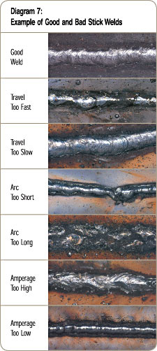

I attached a pic to help you diagnose your welding issues. It may give you an idea whats wrong (amperage too low, travel too fast)

Looks like the amperage and wire speed are ok for a thinner material. Doesn't appear to be proper penetration of the parent metal.
Try turning up the amps and increasing the wire feed until you hear a smooth buzz of the wire burning. A smooth puddle should appear that flows smoothly.

plus notice that the vertical down weld in the first pic (right side) is pretty acceptable. I going to guess you backhanded the weld. Thats probably the ticket with a small machine, concentrate the heat.
The "bad" welds are, as has been pointed out, "cold". Try to prep the weld areas a bit more, and try to use a backstepping/backhanding technique with the figure 8 or a "C" motion, but keep that puddle molten and moving. Don't overdo the motion of the gun.
