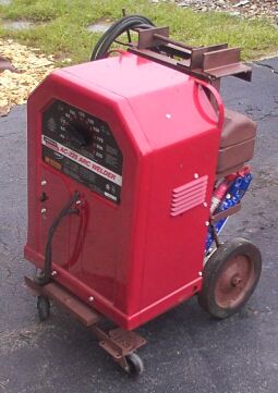

I made a cart for mine, using a couple of larger wheels and a couple of casters. If there is something too big for the casters to roll over I put my foot on the back axle and tilt it back. I eventually turned the toolbox around and mounted it further out, so it now opens back towards the welder (made it easier to see what you were reaching for) and the 2" or so gap makes it easier to wind the leads around the unit.
I use the little angle iron vise on top just about every time I go to use it...

I made one similar to Glyford's. BTW, I like your handy angle iron vise. I took an old 2 x 4 foot "four wheeler" dolly and made mine. Cut it down to fit the little tombstone welder. I don't have a pic but it is the same principle as Glyford's.
