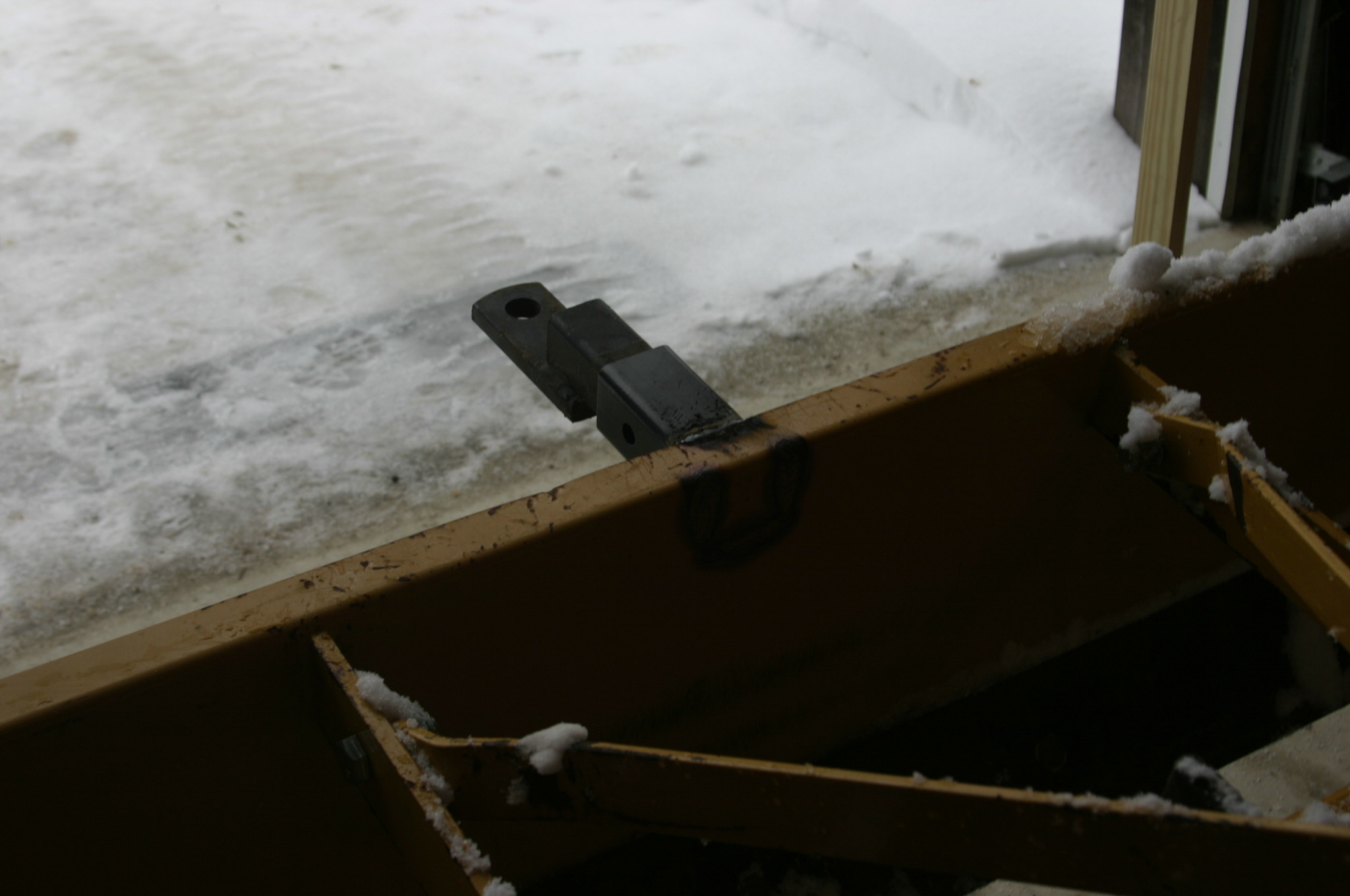

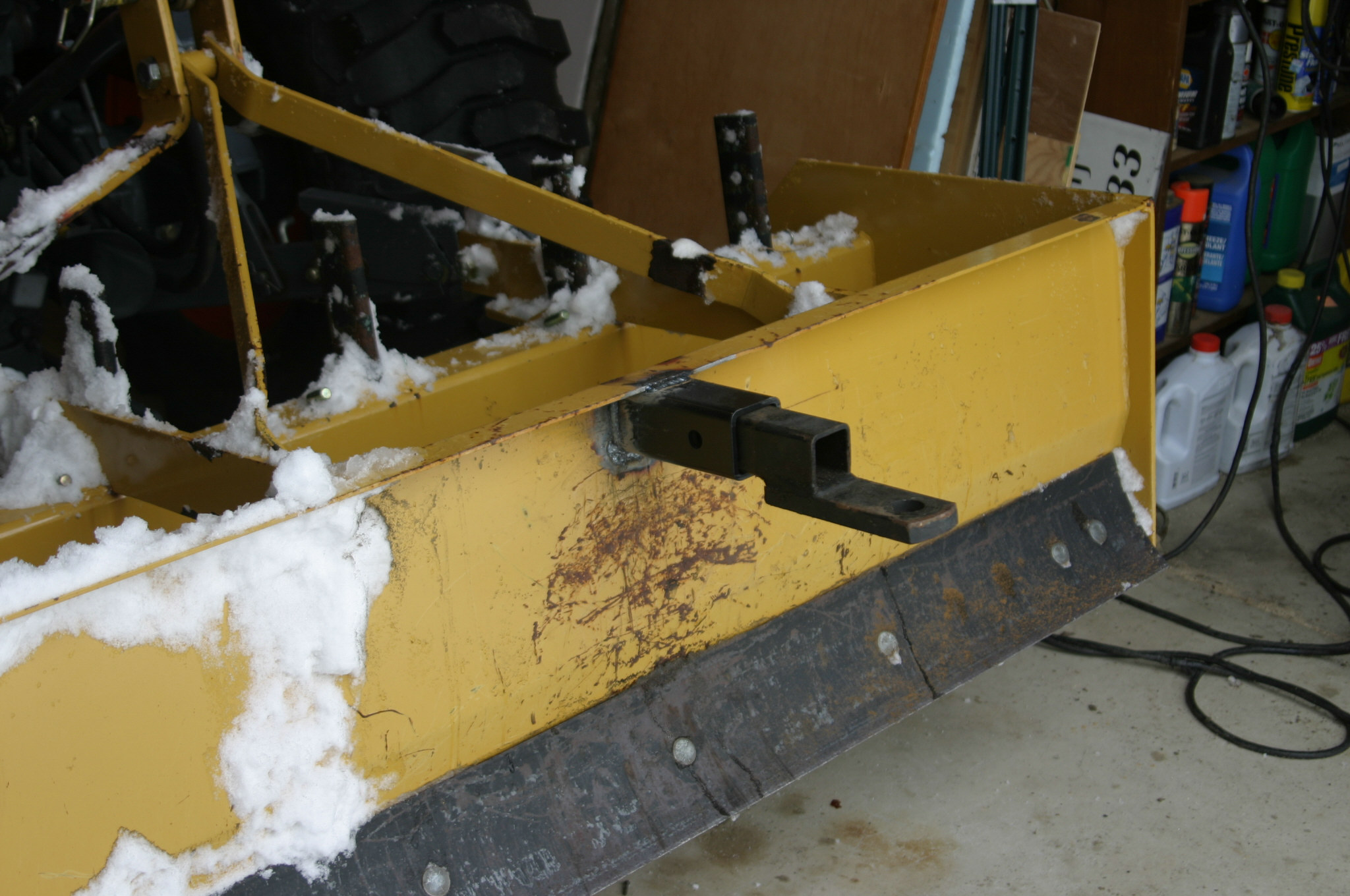

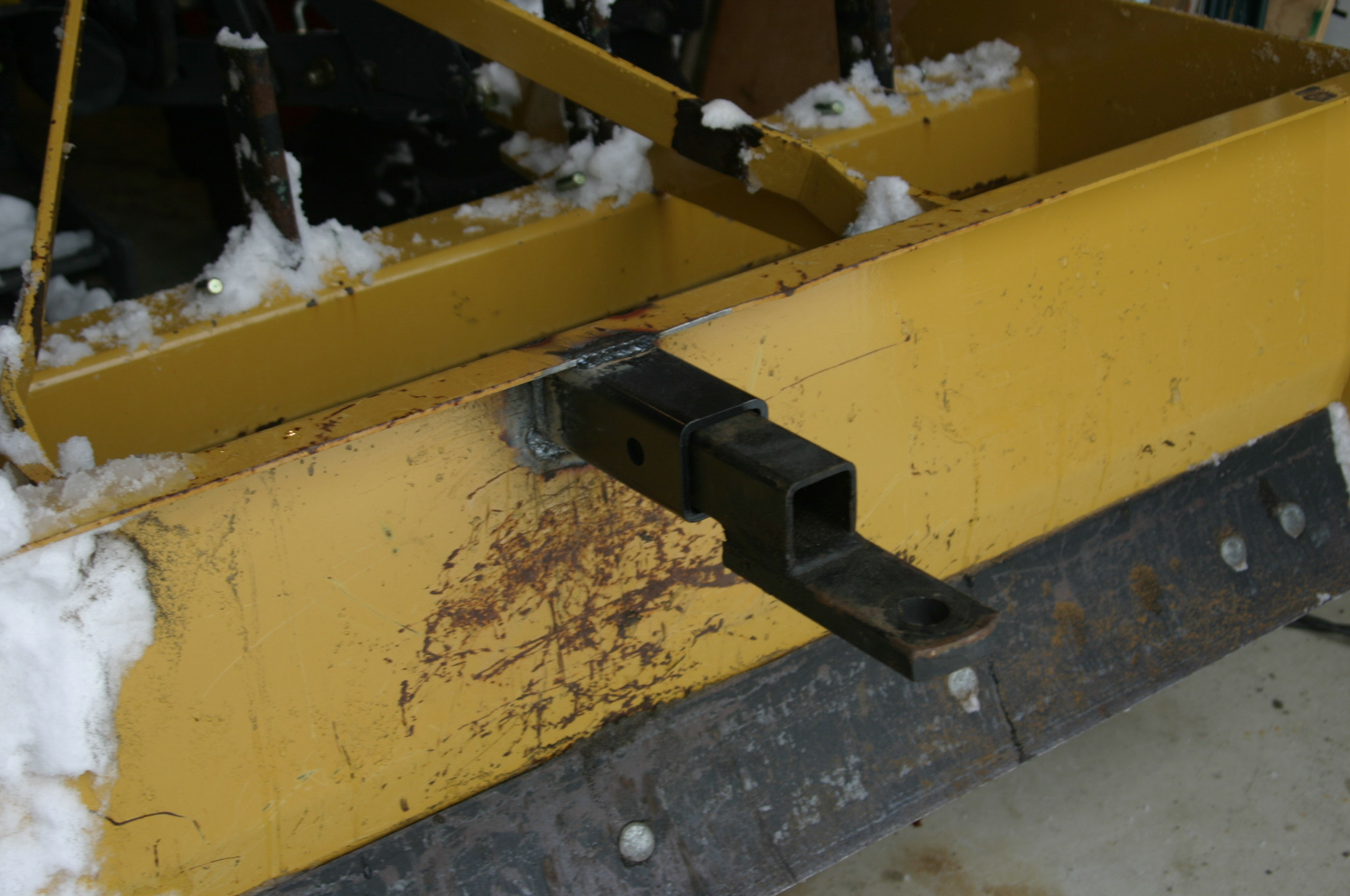

Well, just for the record, the tractor still works.
TSC had these box hitch reducers for under 10 bucks. I used 7018 rod and man, the stuff melts like butter. Had been using 6011 and I'm not sure if that's the whole difference, as I may have not had enough juice last time, but what a pleasure when it works right. :thumbsup:
