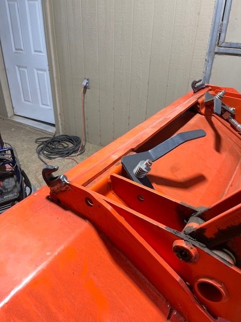

I have welded several times on my tractor without disconnecting the battery. I simply grind a bare spot for the ground clamp close to the work area to ensure the path way.
My work included some heavy bucket hooks.

/ welding on the tractor #12
My 'work' included wrecking an instrument cluster, esp the tach which now pins the needle at low idle.
PTO speed is now 'sounds about right'.
You guys go ahead & I'll wait to hear if you got luckier than I did.
