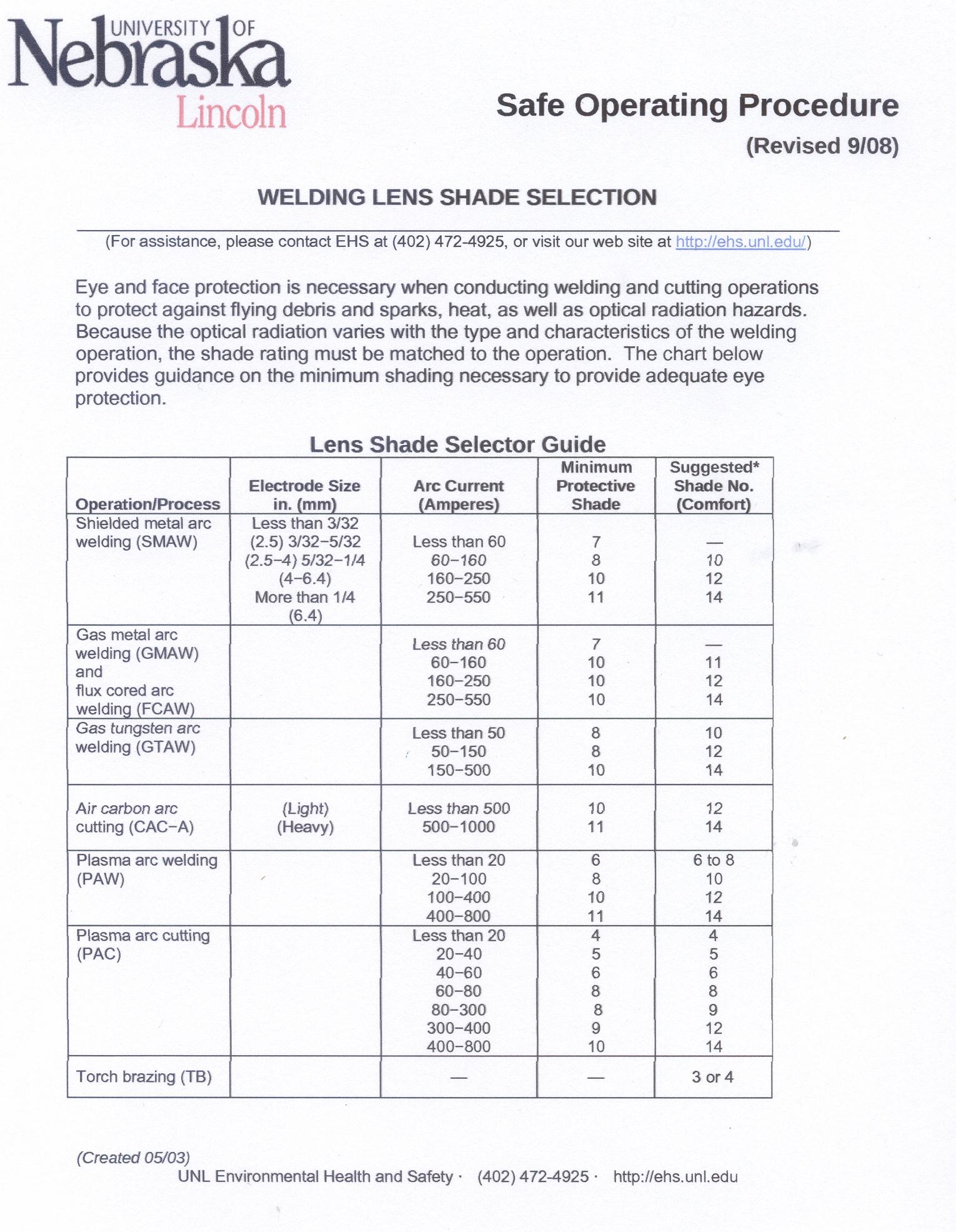

Personally I think this is the hardest welding question there is to answer. Because one person doesn't know what the other is seeing.
How does one tell if the arc is too bright for another person? I guess we wait until around 2:00 A.M. And if you head off to the ER then we'll know you need a darker lens.:)
I like to be able to see about a 3 to 4-inch circle around the arc, and also be able to tell the difference between molten metal, and slag. And not have itchy eyes a few hours latter, or worse the trip to the ER in the middle of the night. I have a selection of lenses ranging from #8 to #11, I change lenses accordingly.
Here is a link to some of the clearest lenses I've seen in years, do yourself a big favor, and don't buy cheap over the counter lenses from the local welding supply, they are a waste of money.
Welding Lenses - Laser Safety Glasses | Radiation Protective Eyewear | Bifocal Safety Glasses | Lampworking Glasses | Phillips Safety

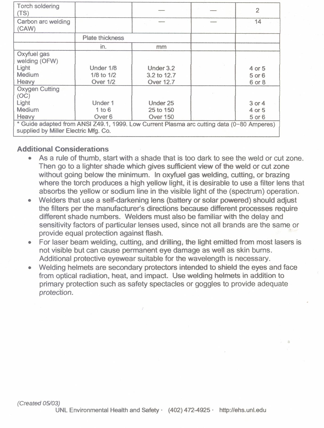

Here is a nice chart that may help you decide what shade lens works for you. But I suggest you buy a selection of lenses, or an auto hood that is adjustable.
Wow, I was surprised by your chart. With my welding, shades 8 through 12 should work. I guess my 9 is good enough but I think I will replace my worn out 10 and check out an 11 the next time I get to the store.
