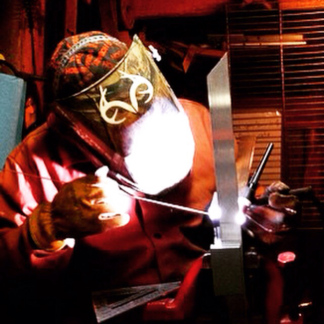

Thanks Jim- the heat Does get intense pretty quick with the general use gloves i am using now. Do you know anything about the (tig finger advertised on welding web?) wondering if it would be much help? reviews say it may be just fiber glass At one work place we had a pair of Nomex gloves - but don't see much mention of them on welding sites
I am good friends with the guy who makes the TIG finger and I tell you I love it. I use one all the time for plasma cutting and tig welding. Great little tool.
As far as gloves go, I want the least amount of insulation I can stand. For 95% of my welding I use the Tillman drivers gloves. They have a goat skin Palm with rough leather back and are super easy to weld in. Don't withstand a lot of heat but I like them.

I love my tig finger and wish the whole glove was made of it.
