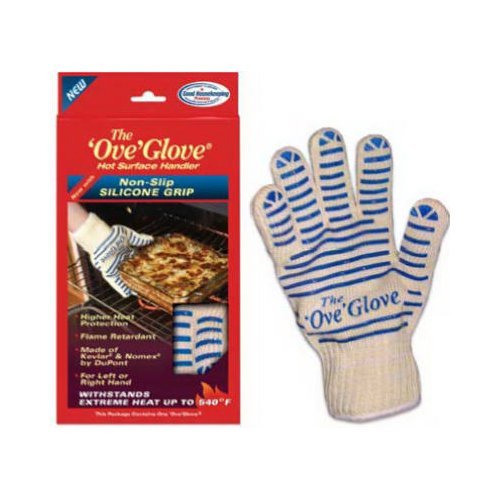

For Tig welding I like to use an Ove Glove on the hand holding the torch. Most of the time the hand feeding the filler rod I leave bare.
For all other welding I buy the gloves from the welding supply.
