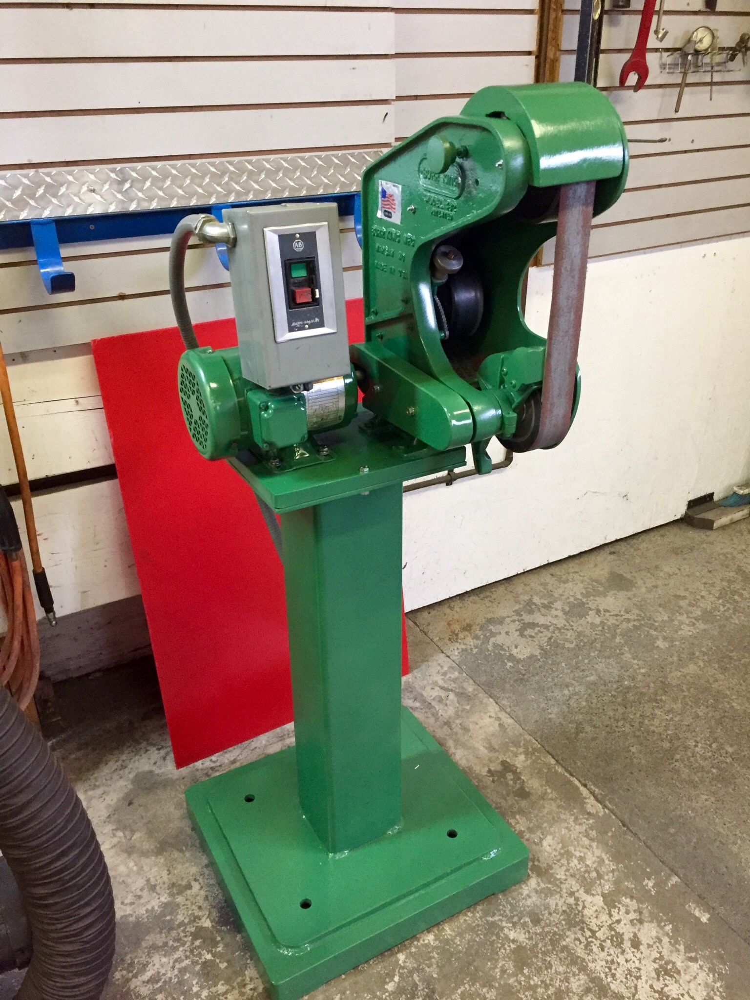

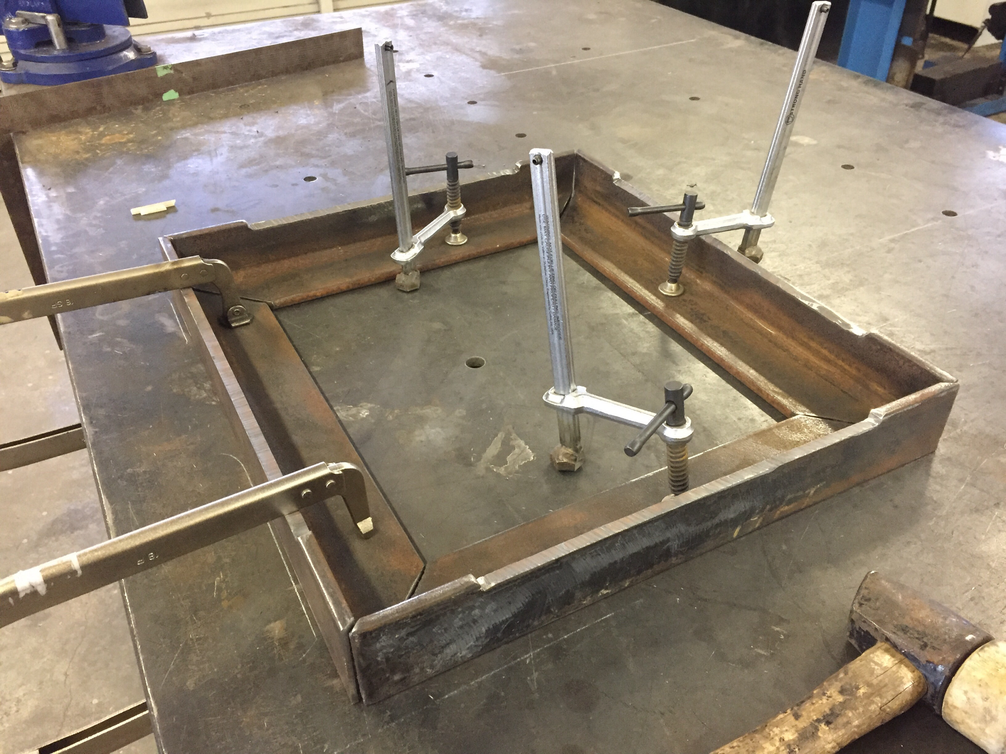

I welded 1/2" plate onto an angle iron base for my grinder. Photo shows the underside before welding.

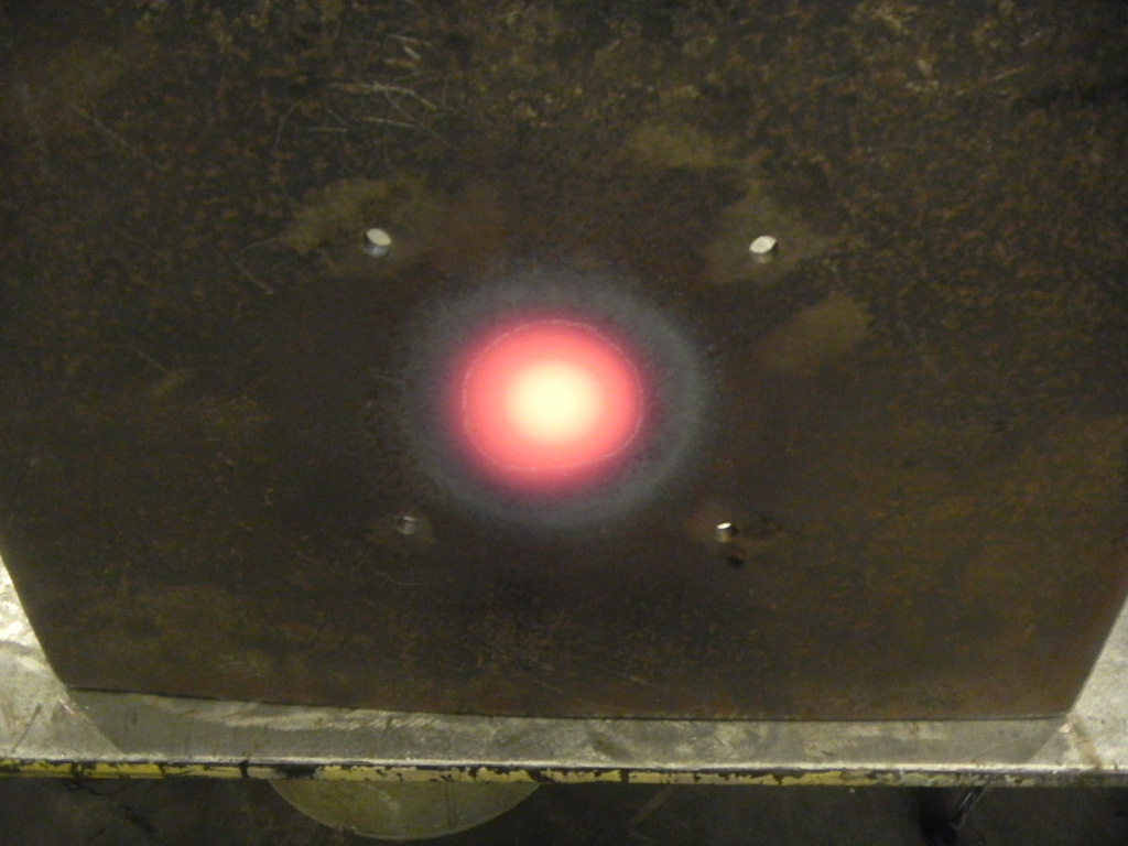

Perfect opportunity to play with some heat shrinking. :thumbsup:

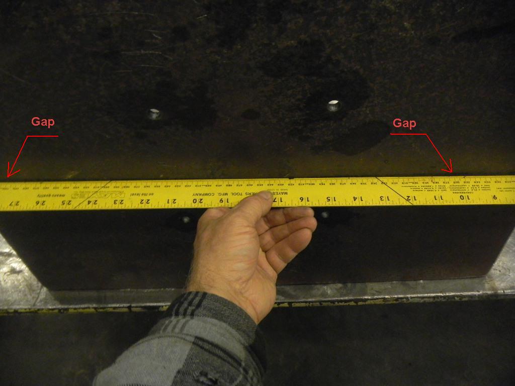

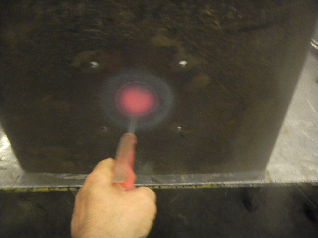

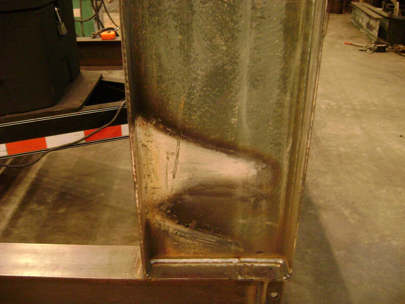

Done that quite a few times. Actually enjoyable when you're retired and have more patience.

Little heat in the correct place, then a little water. Heat = metal expands. Cold water = metal retracts. ;)
