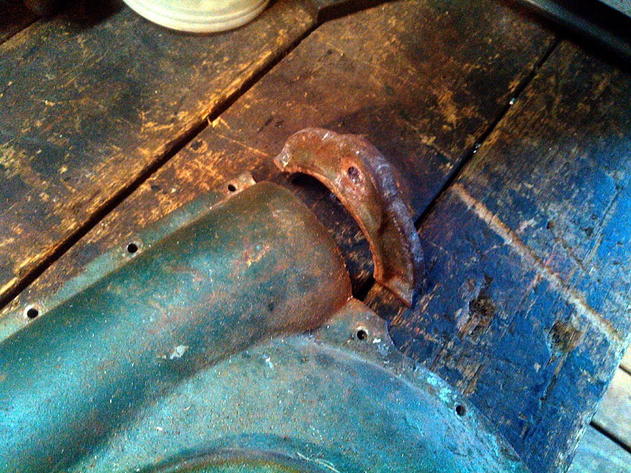

This is a forge blower that I want to fix. It is some kind of a cast iron, never welded it in my life. I was going to use a stick welder but not sure about the rod. Nickel 99? Should I grind it to make space for the weld? I don't have the capacity to heat it up, was planning to weld it cold.
What rod would you use? Any special settings?

Nickel 99 worked OK for me on my 1 cast iron repair.
You don't have a kitchen stove, or BBQ or camp stove, camp fire or electric space heater? They all work for pre-heating to various degrees.

If your not going to preheat it, use the back step method of 1" long beads and wait between beads until you can hold your hand on the previous weld. The 99 will work fine.
I don't know what the latest recommendation on peening welds are now. Used to always peen them, then it wasn't recommended.

Thank you, gents.
Should I just stick it together where it broke? Or grind it to make V weld?

It's going to move around on you when you are welding it. Sometimes it helps to bolt it to hold it close to where it goes. Slight bevel never hurts. If using 99 I like to peen it a little to relieve welding stress. I also like Nickel Silver brazing rod for things like this. Very strong and ductile. If you don't have 99 already you could also use Super 120 or Super Missile Weld 3/32. Good luck on this fun repair.
/ Welding cast iron #7
I would braze a gusset to the flange along with brazing the break. It's a blower so won't see brazing heat in use.

WHY???
Brass job at best, Everdur wid single carbon probably better.
(removed)'s Old School, NEVER grind cast, especially s#!t cast like dat. Guy who poured it had no idea what got melted fer dat run, you got none either. Chip or nap light and sand blast to clean up.
Bed it in pan of new kitty litter fer alignment. Better if fixtured to hold alignment. You dealing wid a flange. Gonna want to walk or kinkk, nature of flanges.
Run tackup from inside pipe, verify alignment finish job from outside.. Add couple gussets between bolt holes.

Unless a tractor part I'd rather see you weld it yourself, that way you can post pictures of how you did and may help someone. The cast that gives me the most trouble is stove parts, but this appears separated from high heat so should weld fairly easy, it's just that Nickle rods are very pricy but seem so 1 lb should fix it.
I recommend a little bevel, needs to be shinny anyways, I wouldn't worry about preheat I think post heat/cooling is more important. I suggest 3/32 rods and skip around in 1-2" welds, let cool very slowly when done.......... Nickel 55 ENiFe-CI Cast Iron Stick Electrodes Welding Rods 3/32" 1/8" Nickel 55% | eBay

Flange on blower in picture, we can all see it broke. Can I 'fix' it? SURE Before I start tho, what does flange do? Is it suport dat holds blower to bottom of forge or just connection between blower & tyre? Makes big difference in fix.
How I make repair? Depends. What flange does and what mate looks like kind of governs decision. How much $$$ you want to spend big part of decision too. Come to pick up and yell at me how you could have bought new for less and my 18 pound hammer make it real easy for you to go buy new. Truth is if casting stays below 400f, best & cheapest repair is JB Weld.
Choices = Brass, 309ss rod, high nickel rod, Everdur either gas or carbon arc applied, and ever present E70-s6 MIG wid Co2.
Which choice is function of end result required, nothin else.
BTW, casting in picture looks like real crap dat foundry cast cheap as possible. Flange was designed to fail.

Another fun cast repair alloy is cast iron itself. When I was working at JW Harris back in the day I played around with a product called Kastweld 111. Not sure they have it anymore but Weldcote Metals has it called CASTIRON. Uses a flux and is an oxy-fuel product. It is simply ground cast iron stamped into a rod. You can put it on as thick as you want to and it color matches perfectly. So in the end there are a dozen ways to fix this including tacks of 309L stick followed by spray powder. Go ahead and fix it one of the above mention ways. If it breaks just pick another process and fix it again. Soon you won't even need to ask for help. Good Luck.
