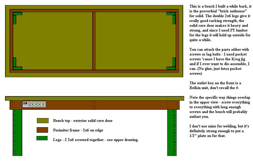

Daugen, here's an easy to make bench I did a while back - a guy gave me the door, it had a doggy door in the bottom and they didn't want it anymore. I whacked off the bottom, took a scrap 2x6, ripped it to slightly wider than the door thickness, ripped 1/2" slabs off of that, and edged the raw particle board (from cutting the door down) -
I built a "bridge" with shelves, doors, for the back last week but that's another story.
Anyway, the bench could be made pretty fast if you have/can find an old solid core, slab-type door.
The drawing says it all... Steve
