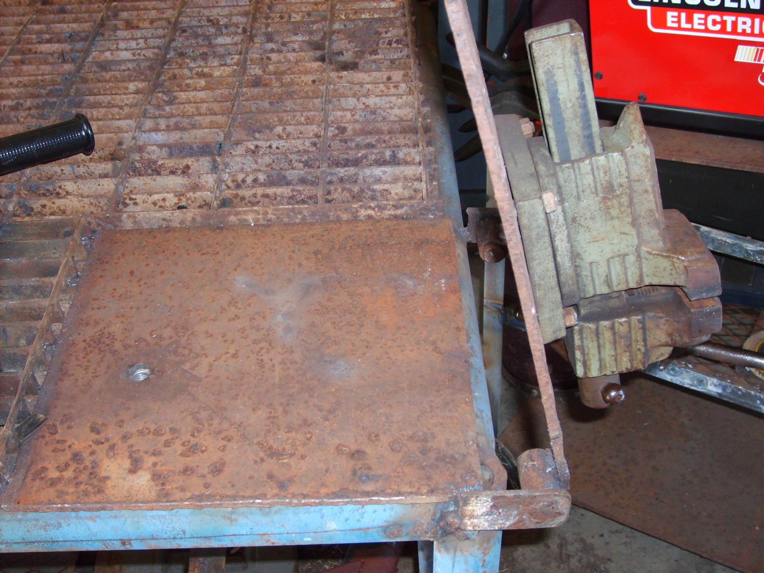

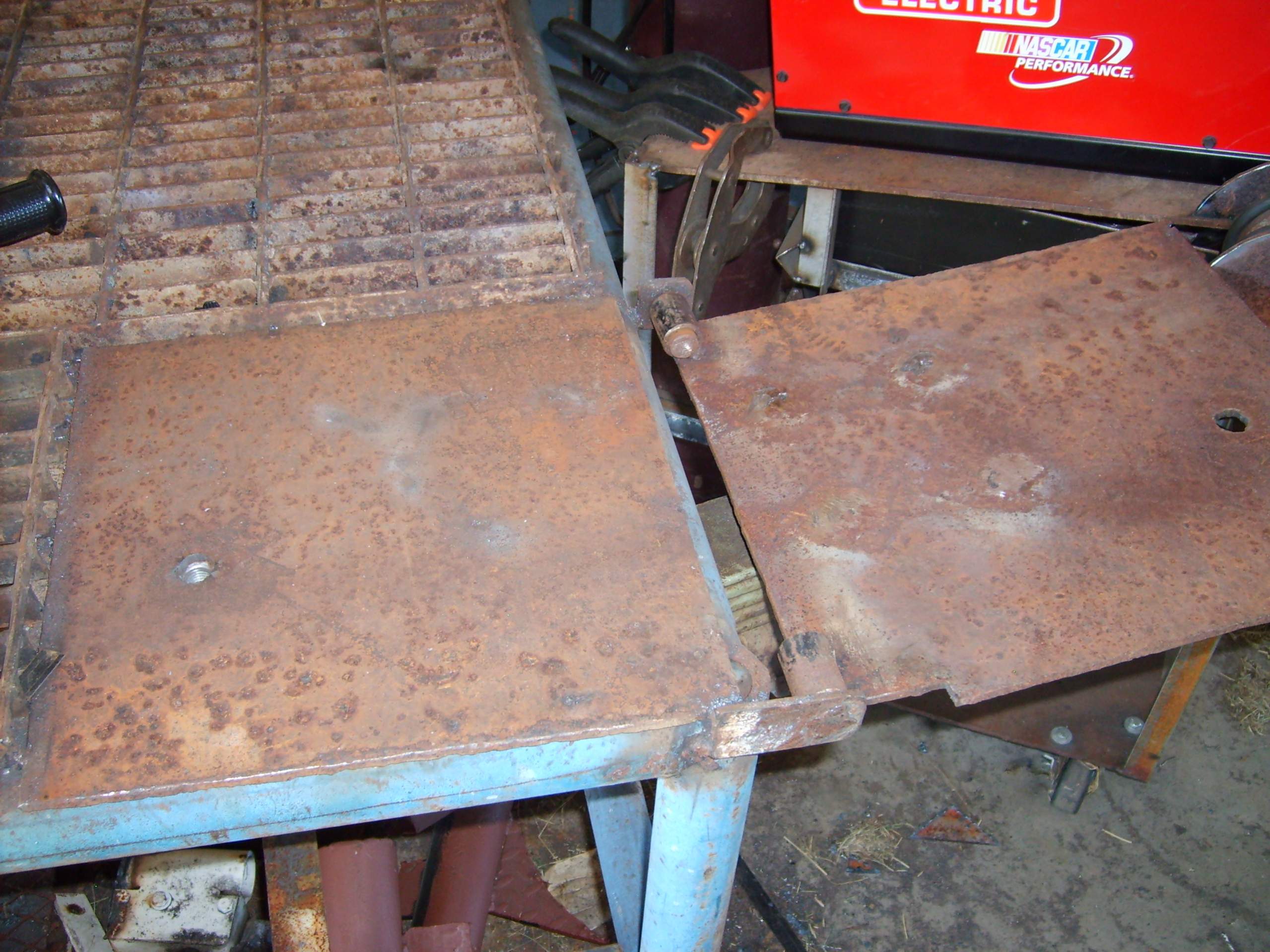

Jay, I like how your mount for the vise allows it to hang vertical out of the way when not in use. Keeps it handy without being an obsticle to bang your knee into. I may steal your design and mount mine the same way.
Steal away Jim! Truth be known I probably saw it somewhere and forgot about it. When It occured to me to build it I probably thought it was an original idea!:confused2:

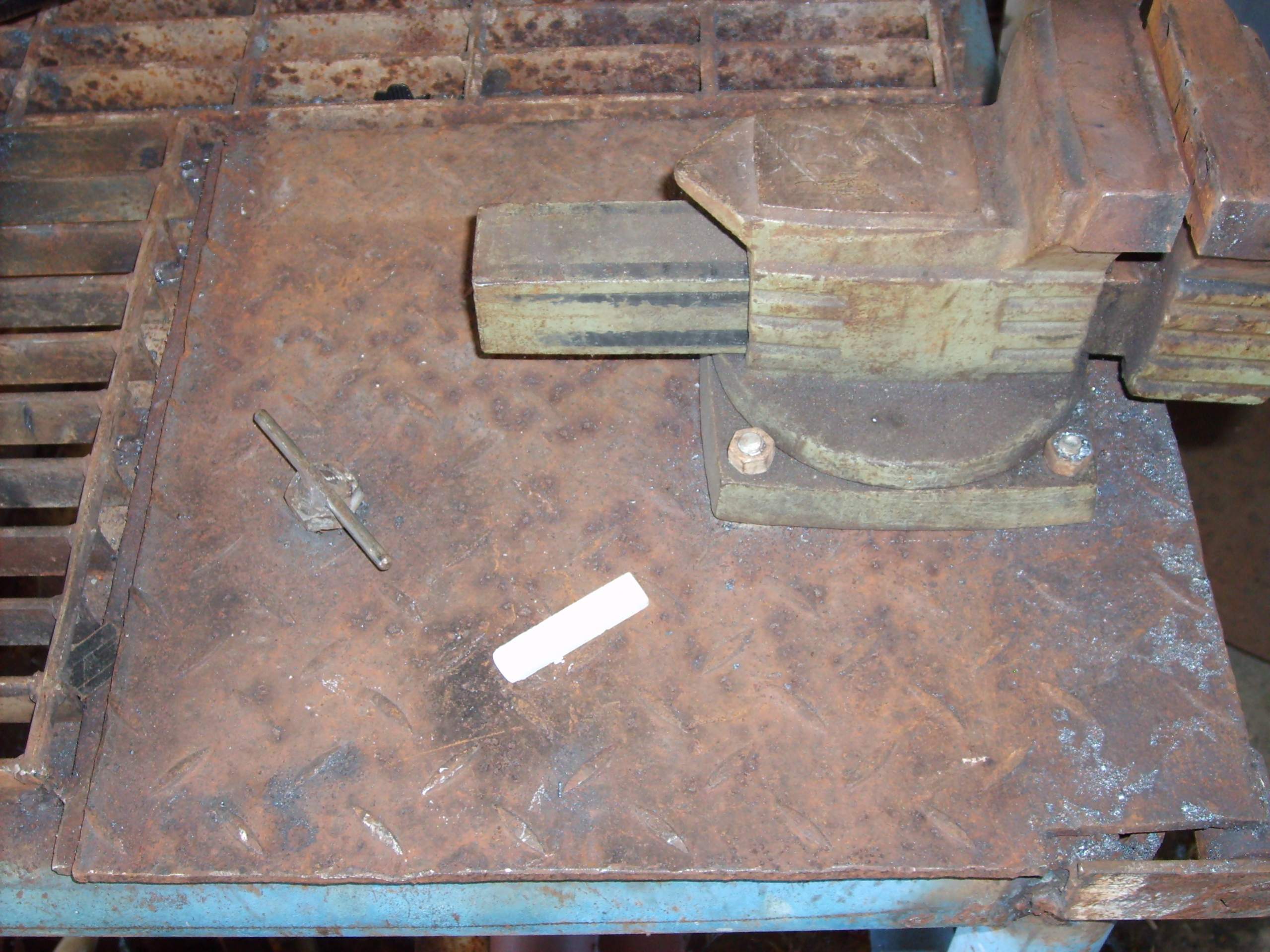

BTW, if you can't tell there is a nut welded underneath to screw the "tee bolt" into to hold it down when you really want to do some torquing in the vice.:thumbsup:
