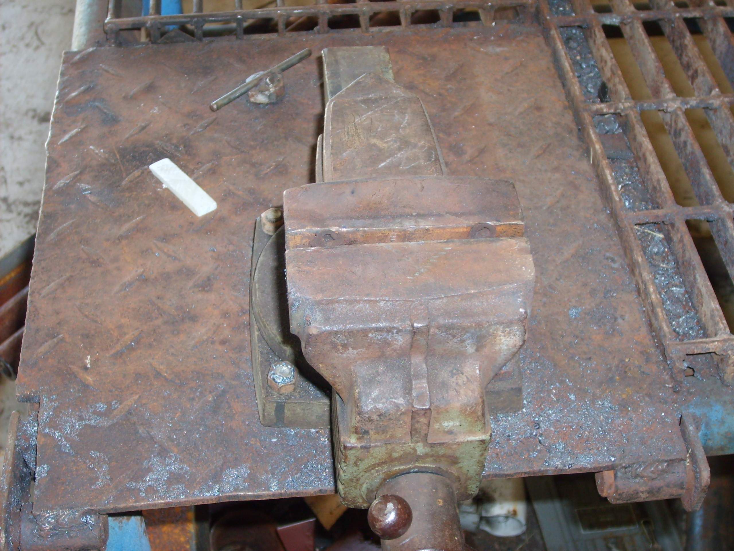

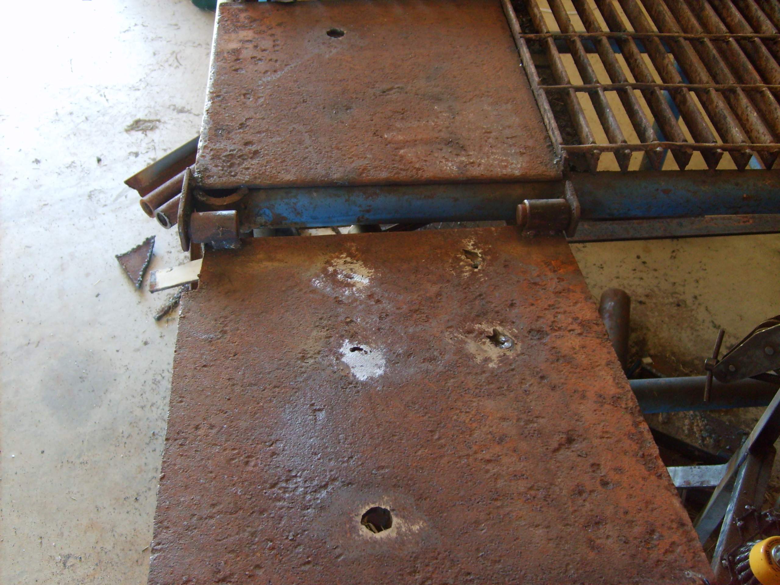

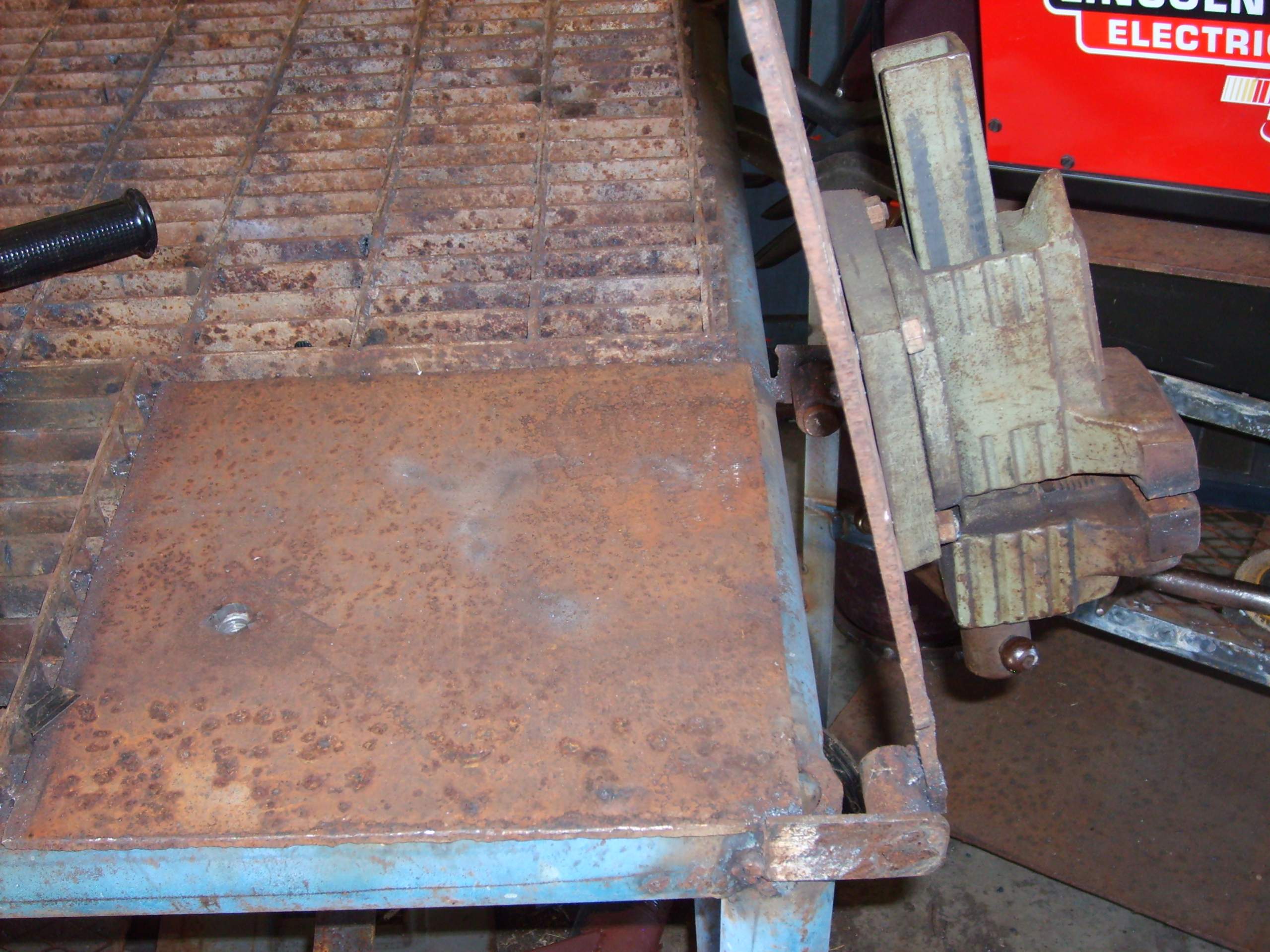

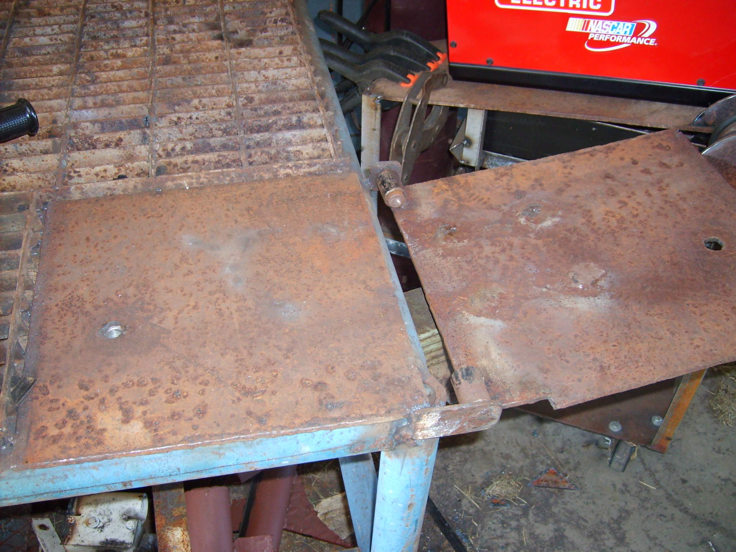

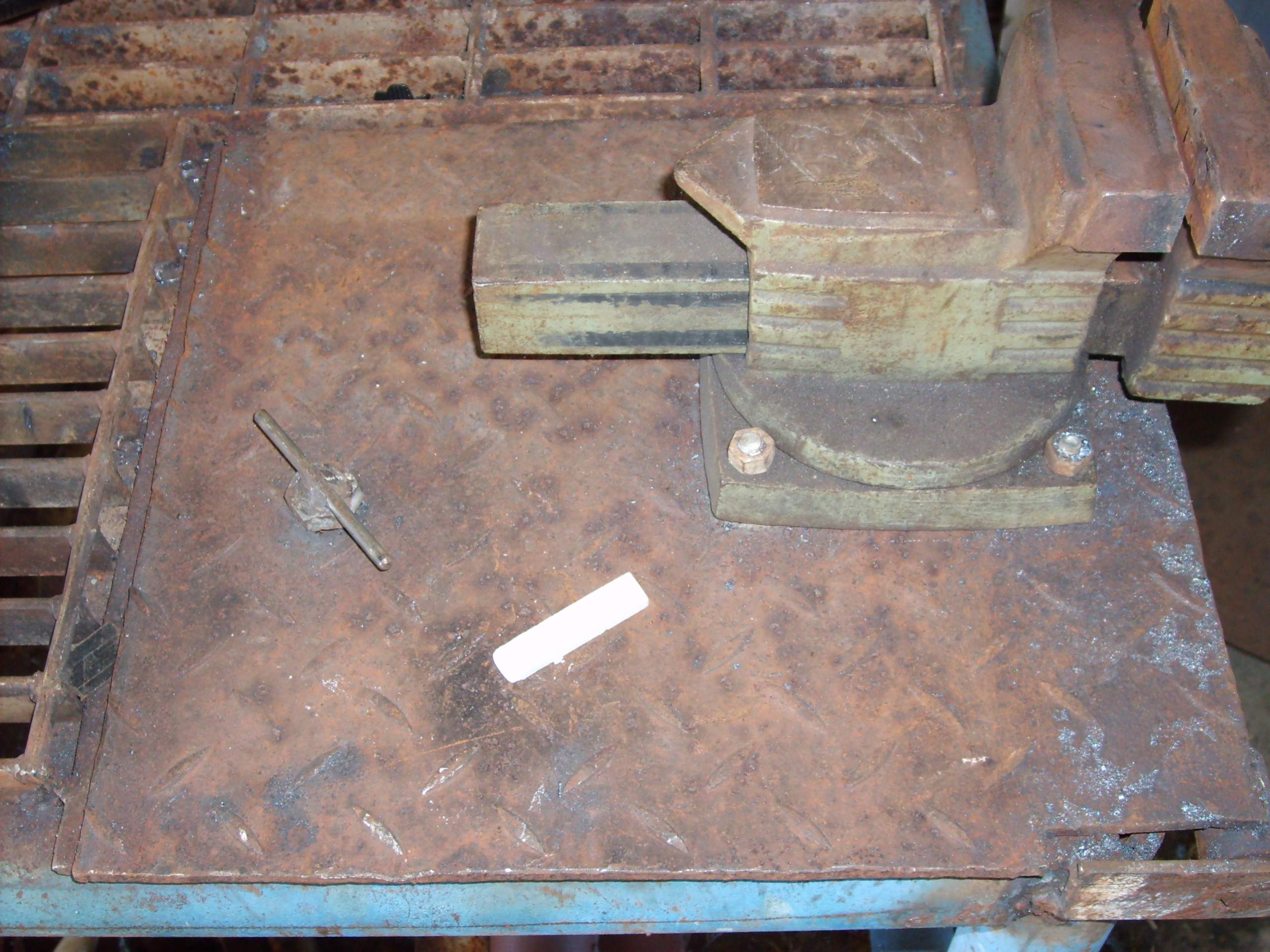

Here's a few shots of my welding/cutting table. A while back I wanted to attach my vice but didn't want to permantly attach it. I was concerned that I might want to utilize the whole top without any permanent fixtures in the way. I ended up making a hinged plate to mount the vice on. It's not painted yet and may never be at this rate.:D

Jay, I like how your mount for the vise allows it to hang vertical out of the way when not in use. Keeps it handy without being an obsticle to bang your knee into. I may steal your design and mount mine the same way.
