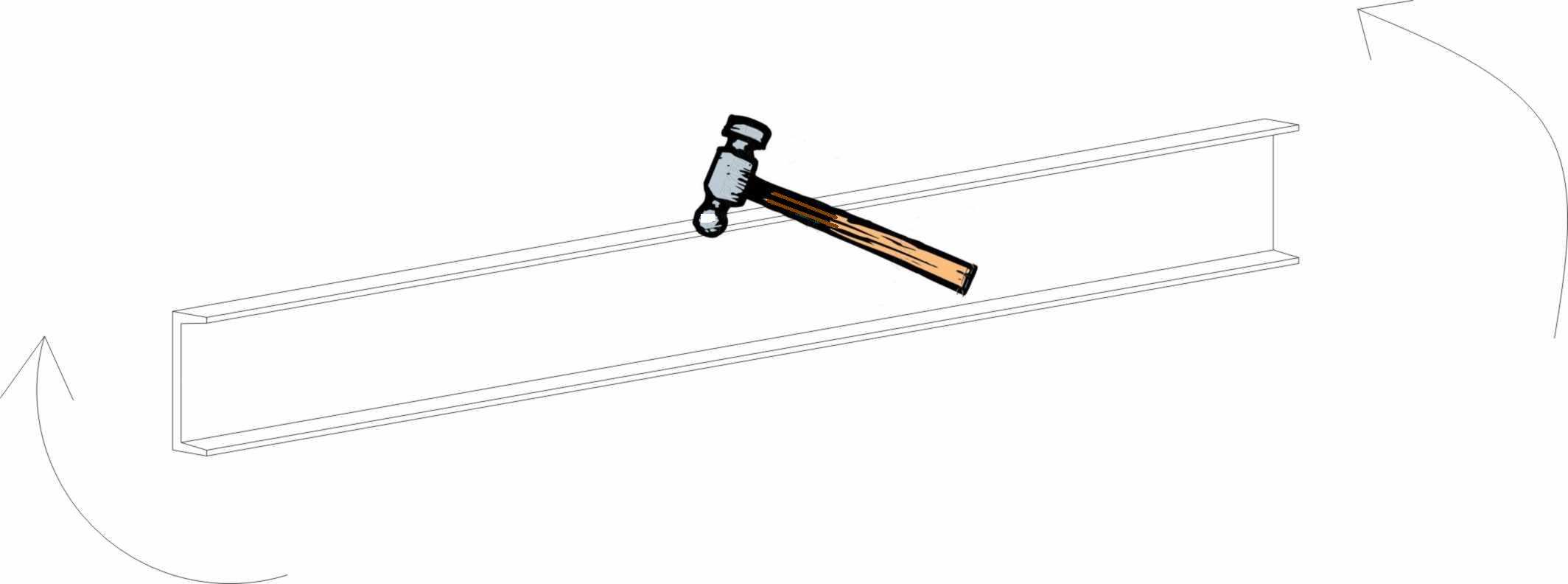

true, but when it cools, it will shrink smaller than it was before it was heated.
so, when using heat you actually work on the side you want to shrink... unless you are using a big hammer and heating all the way around the pipe.:)
going the other way, particularly with flat plate, to stretch it just hit it with a hammer. metal plates are often used in conjunction with flooring or serving flooring functions. an edge will get caught and peeled up... the natural response is to try to hammer it back down... but that will just stretch the metal and make the hump worse.

I think that adapter weighs right at a 1,000 pounds. Those are 12" x 15 pound beams.
It is amazing what can be done with a ball peen hammer. Other than all the little dents, a ball peen hammer can move material pretty fast. Take a piece of C-channel and beat on the flanges and it will bend.
