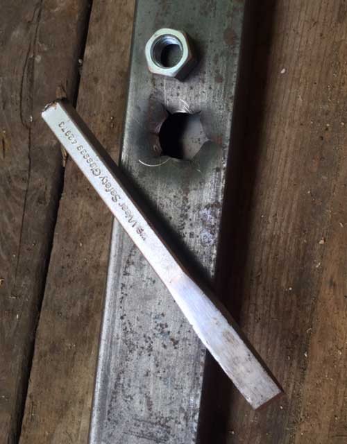

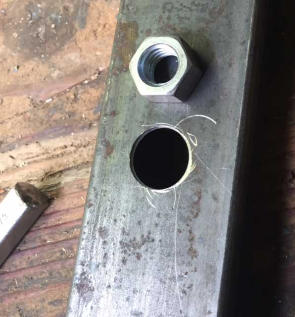

Here's a way I figgered out to weld a small nut into thinwall (3/8 nut into .065") steel tubing.
Drill a hole about the size of the wrench. For example for a 3/8" nut, which uses a 9/16" wrench, drill a 9/16" hole.
468887d1463463603-welding-nut-into-thin-wall-nut_thinwall1-jpg
With a cold chisel, cut the six corners
468888d1463463603-welding-nut-into-thin-wall-nut_thinwall1-jpg

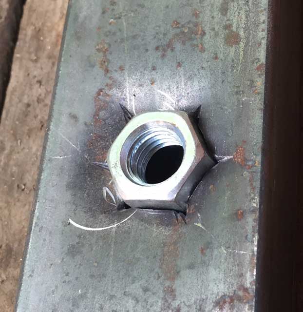

Pound the nut into the hole flush, and weld it up.
468889d1463463603-welding-nut-into-thin-wall-nut_thinwall1-jpg
Sorry forgot to take a pic of it welded and now it's all "somewhere else". But at this point you know what to do.

Cutting those six corners is easy, fast. And it holds the nut for welding. Agreed, chisels are old-school. :) The only thing about this method that might be a challenge is drilling the right size hole.
For a 3/8" nut I don't think you want to grind away any metal, you need all you can get. I found a finished pic.

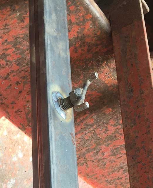

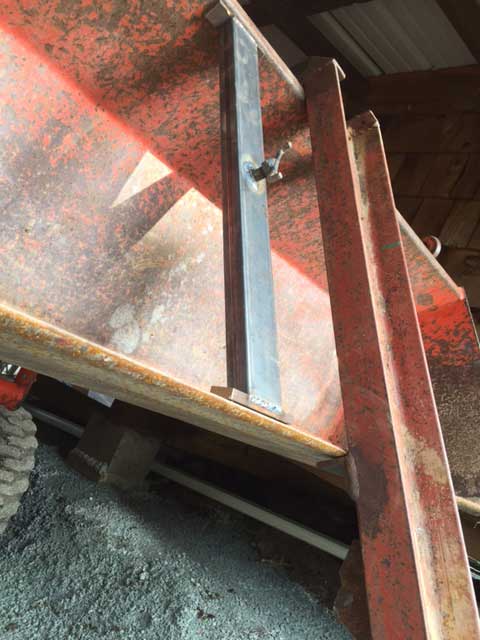

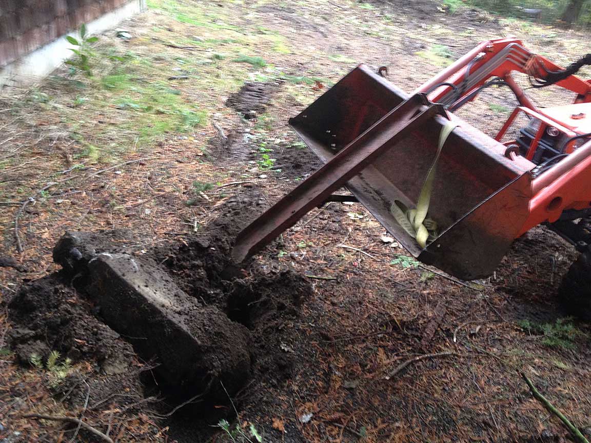

Here's a pic of where it's used. It's for a wingnut to hold a spreader to prevent bending the cutting edge on a "bucket spade". Bucket spade is just 7" channel with some brackets to be held on by a cargo strap.
468920d1463501138-welding-nut-into-thin-wall-bucketspade1-jpg
Spreader bar slides in behind the bucket spade and there's a hole in the channel for the wing-bolt.
468921d1463501138-welding-nut-into-thin-wall-bucketspade1-jpg
