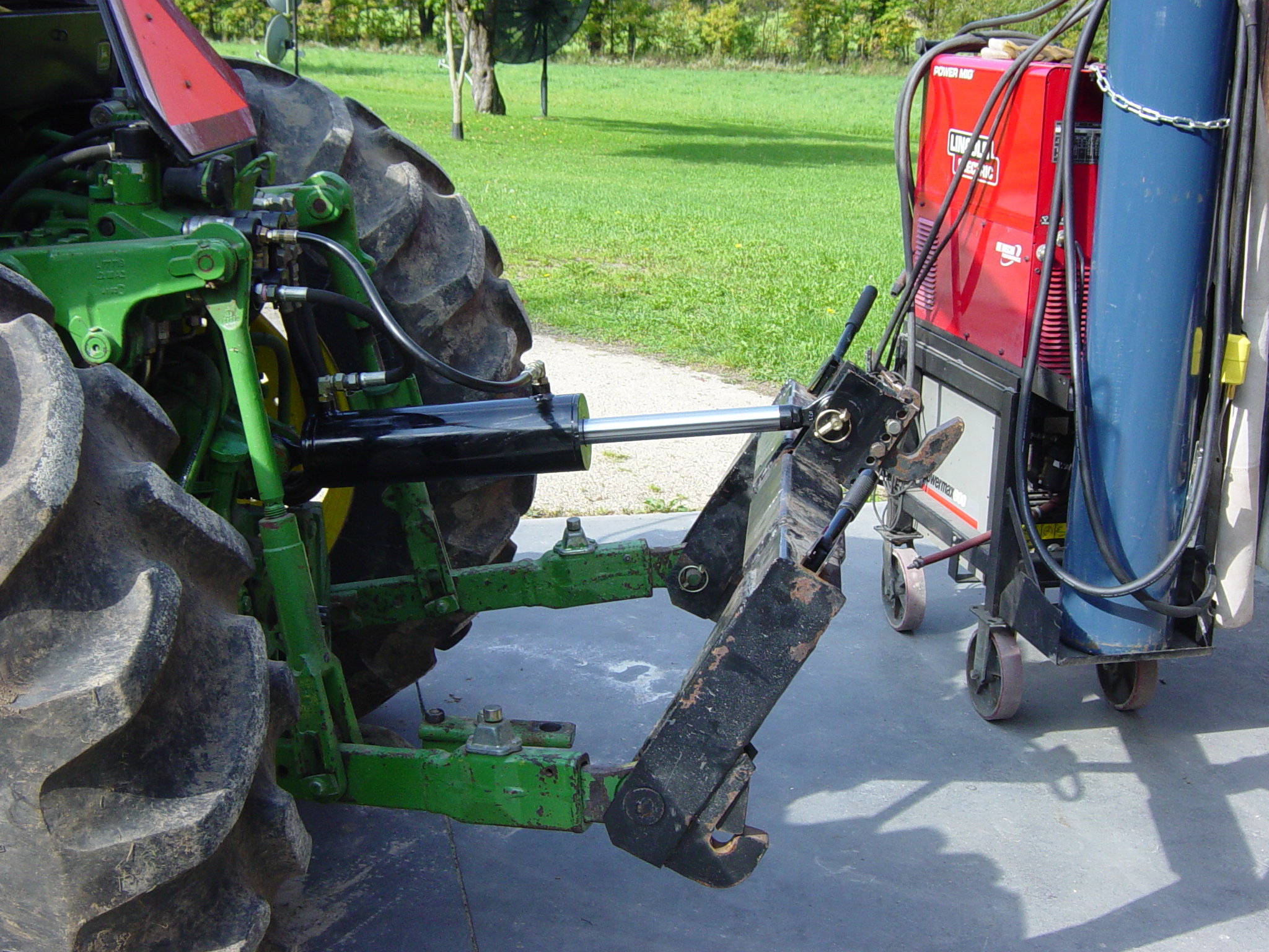

I might just try and get the Mig into the project but it's difficult. I have become quite good at repairing my welding screw ups, like burn threws, with the mig and have not used the buzz box in years.
I bought the welder on that cart. Surprised it was allowed in a Big company, in that unstable configuration. I mounted the Plasma below for convenience and single plug power. Plus, despite having lots of security in place (but no insurance) , this thing would be difficult to throw into the back of a pickup.
So if I can figure a way to get it stable on forks, I could drive it up to a window adjacent the fire place.
Too bad you don't know someone with a 115v mig unit to use. It would be adequate for the job.
