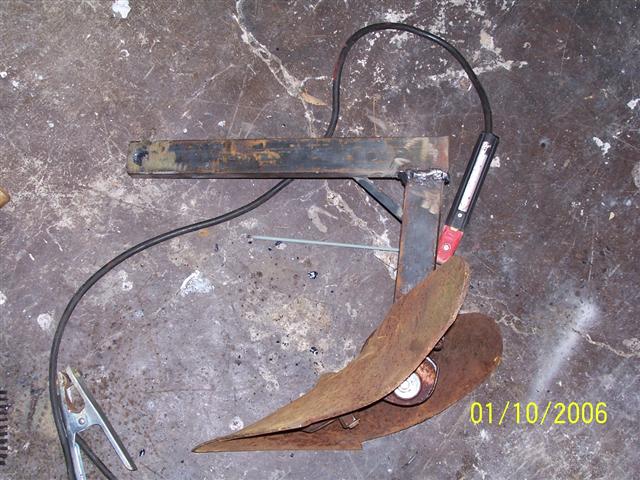

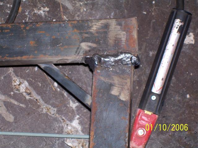

It is pretty ugly but it does work.
Speaking of welding I did some last night, thought I would share a nice example (not of my pretty welding). I'm making sort of a utility bar where I can slide in some cultivators, busters, trailer hitch and who knows what else I'll come up with. I needed to make a plow arm by butt welding some 1" to a piece of 3/4" steel. Ground and beveled (very important) I welded it with the mig on high range. It's a 220v HF. Seemed to penatrate ok. Well some clay with iron ore in it told me it didn't penatrate that well. So I brought it home, ground it and let it have it with the stick. Nice thing about the stick is I can force some heavy penatration. Also just seems easier to build up a bit. The weld isn't that pretty but it's deep. I also added a 1/2" bar for extra protection. Good thing is where I'm actually going to use the plow it's a lot softer.
pics...

/ Welder Recommendations #29
more of the project..

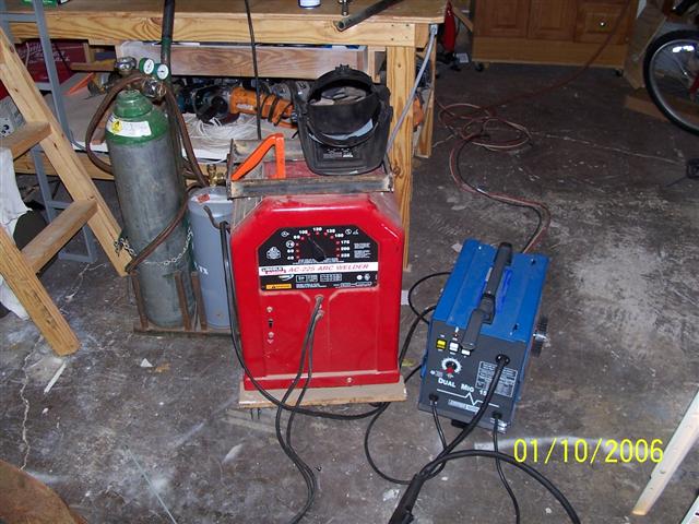

And what I consider a good small working setup...
oxy/acte - B acet tank and a 80 oxy, Uniweld regulars, I bought the set originally back in 1989 at a pawn shop. I've had the regulators rebuild once. I have the cutting tip, brazing, and a rose bud (heater upper thing).
Lincoln 220v stick, AC only, the cheap one at HD, $225
Harbor Freight 220v gasless mig (can add gas). $179. I've run 5 pounds of wire through it so far, no problems. It is cheap but it works. the tip hasn't clogged up any more than an expensive mig. Just pull the sheild, unscrew the tip, clean and replace. I've love an $800 gas mig but not in the budget.
Rob
Oh the frame on top of the Lincoln was for the HF 110v mig welder, I keep it at the weekend place now. The lincoln is on wheels so it was easy to roll around.
