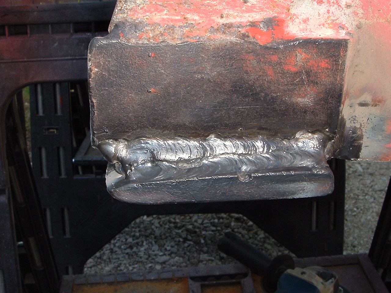

This is my welder. Everlast PA160. It cost me $265 bought thru Mark here on this forum. It is a stick welder. It was the second machine I have owned. My first was a Lincoln 225 AC only so called "buzzbox". They are called buzzboxes because they buzz when you weld with them. They do OK, but the quality of my welds improved 100 percent when I went to a DC machine like my little Everlast. It weighs about 20 pounds or so. The Lincoln buzzbox weighs well over a hundred. My trusty buzzbox got sold as soon as I made a few welds with the little inverter DC machine.
Below is an example of the kind of welds it can make with some 7018 rod. Yes stick welding takes longer to learn. I taught my self totally. No one around to help me or show me anything. My first welds were NOT very good. But I did put the AC machine to work pretty quick gluing my old mower back together many times. The mower was totally outmatched to the job I was asking of it. Rough ground and lots of it.
Stick vs. Mig (and its cousin flux core) . yeah, kinda like the perpetual arguments about .45acp vs. 9x19. AG vs R4, Chevy vs. Ford. And on and on. There is room in the world for both processes.
Which is cheaper to buy? Stick (except for a few Harbor freight things) . Which is cheaper to operate? Stick. Which is quicker to set up? Stick. Which has less mechanical complexity? Stick. Which will give good penetration EVEN in novice hands every time? Stick.
Which is harder to learn on? Stick. Not many people will argue these truisms. Although you could write a book about the advantages and disadvantages of each process, and many such books have been written. Welding is not a simple subject, and many men and not just a few women have spent a lifetime perfecting their skills on the various processes. It can't always be boiled down to a "which is best" and "what should I buy/" type of question. It is complicated. Like most things in life.
Good luck on your welding journey.

Stick welding is the cheapest for welding plate. And there are always used Lincolns on craigslist for a little over $100 all the time. You just don't use stick for sheet metal. A stick welder 220v is going to weld 1/4 inch plate better than any MIG 110v and will be cheaper to buy.
Don't worry about 7018 rods as you need to store those rods in a rod oven. You can not leave 7018 rods out in the air. If you are running an AC stick welder you need to buy AC rods. There are AC and DC rods. You need to match your welder.
