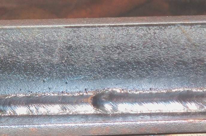

Yeah it's an older machine, I bought it in 1998-9 iirc, Still welds though and has outlasted a miller and hypertherm plasma. Looking at prices for knew ones and I hope she last awhile.
   / Welder/Plasma supply wireing, need homework graded #12
(removed) might know a bit more about the older ones than I do as I was kind of a late cummer to the wire world. I barely fumbled around on them as I worked about the first 10 yrs Ironwork and only really got on to them in my carousing days when I started slumming around smaller job shops. I was skeptical but I soon learn the gap filling potential and I have always kind of understood fusion, I get it we sposed to melt it in and not lay it on top. If I was really welding more would go to Co2 for cost and a bit of dig,,,, I wanna add that while it crossed my mind but I see guys from welding school can never seem to get a stick bead not to roll on, obvious as daylight but not everyone see it.
Anyway I can be a good welder, after running 6010 and really 7018 for a decade the wire was on roids to the max. Same for Innershield. I was almost good enuf on sticks, it looked good to everyone but me but the wire is the bomb.
A welding regret I have is never pipelining. It seems everytime I got the notion something jumped up. I still really dont like rolling around in the dirt and barely tolerate much grease which I have somewhat concurred with hot wash but the mud, yuk, all cold and dreary in a ditch. Iron is a lot that way too, cold bitter winter and I should have absconded to someplace about 4 months to some competitive work. That JT on the forums eludes to this.
Reason I mention it was a minute remis about the learning curve. That 185 would be a nascar building machine.

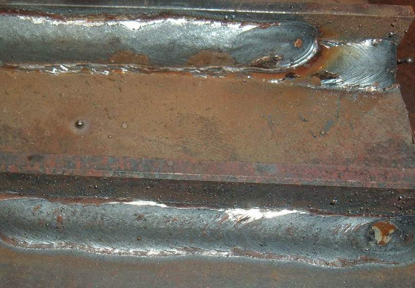

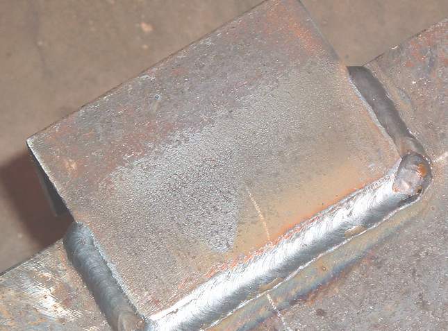

Something didnt load with the 2nd pic above. The first pic is what you can do with the 185 and maybe a pinch more. This is short circu9it but note how close it is to turning in to something else in a sense that there is a total lack of a stack that there are no ripples. The 185 will do this as good as a crap 255 I got. I stop in the middle and tune a volt to try to get the spatter out.
