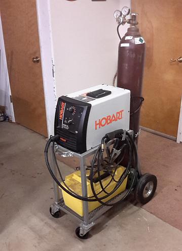

At home is nuthin, you most dangerous at work where the code tends to assume that everyomne is under compentant professional supervision. I do think they limit 240V to a single recept upder some other building code and it would change some aspects of wire sizing for multiple machines. I put 2 on a 30 for a welder the other day, used 2 sets of 12 to a 30 listed and designed for 2 connections. While the outlets share the same breaker they do not share the same wire. It was a garage for a Hobart 175 and the guy bought some new 200. Properly terminated could hook both wires to a 6 with 50A and run both machines at once.
