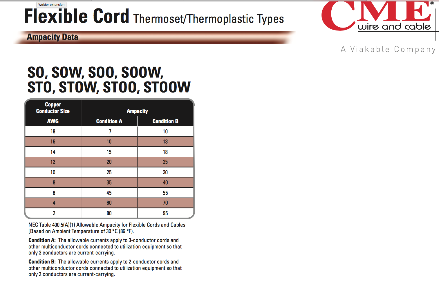

Single or three-phase? Their website says 60A single phase.
Power whips off the machine follow different sizing rules than building wire or extension cords.

/ Welder extension #7
That is single conductor wire for use in conduits, gutter and panduit only.
/ Welder extension #8
You need at least a 10 gage SJOOW cable like this.
You can find it online sold by the foot.
The same type of cord is available in 8 gage by the foot from this source.
/ Welder extension #9
What amp breaker are you running? 30A 10g, 40a 8g, 50a 6g, I would build one out of 6g, that way you could use full amperage if you have a 50 amp circuit. CJ

Without looking up that welder......does that welder have sensitive electronics? Or is it a basic transformer machine.
Also keep in mind that you will pull a MAX of 46 amps. So that would be having the welder and the wire feeder cranked to the max.
8 gauge will keep voltage drop under 3%......what you want if it has sensitive electronics. 10 gauge would keep it under 5%.
Would help to know what you are starting with from the power company. My "240v" service is actually 246v coming in to my panel.
Why does it have to be a portable cord? That would be strung across the floor and rolled up every time? If this is the new home for the welder, consider a permanent outlet. 8-2 w/ground for a permanent install is like 65 cents a foot. 8/3 SOOW portable cord is like $2/ft.

LD1, what code book are you looking at? My 225A AC/DC welder has all #6 wire from panel to receptacle and through short SO cord to machine. The SDO cord gets warm with sustained use at 200A DC weld output. Voltage drop is one thing, heat is another with undersized wire and both are related to each other. I would not under sizing just to save a few bucks. Continued heating causes insulation to break down quickly. Even Mark from Everlast states that the manufacturer recommends a #6 50A circuit. That is code compliant.

No code book, just looking at the voltage drop calculations.
There are some special things that come into play if wiring for a dedicated welder. The wire is sometime allowed to be smaller than what would be called for in a circuit for other things, because welding is not continuous duty.
There is never anything wrong with oversizing the wire. I even mentioned using 6ga wire, to keep the voltage drop below 3%. That would be well within requirements for the welder to deliver 46a at the end of a 100' run. Sure, 8ga, if the welder is pushed to the max for the duration of its duty cycle for an extended period of time, the wire will get warmer. But not beyond what the wire should be capable of

If you want to go by the NEC, you have to understand the difference between designing a branch circuit (panel to outlet) and an extension cord.
What you really need to take into account is the maximum current draw in Amps, and the welder's duty cycle.
As an example, if you have a welder that draws a maximum of 40A with a duty cycle of 50%, you would use the multiplication factor of .71 (from NEC Table 630.11). The calculated current draw, taking into account the duty cycle, is: 40A x .71 = 28.40A. From Table 310.15(B)(16) - a 10 gage conductor has an ampacity of 35 Amps at 75F.
Therefore, for the imaginary welder drawing 40A with a 50% duty cycle - a 10 gage extension cable would be adequate.
