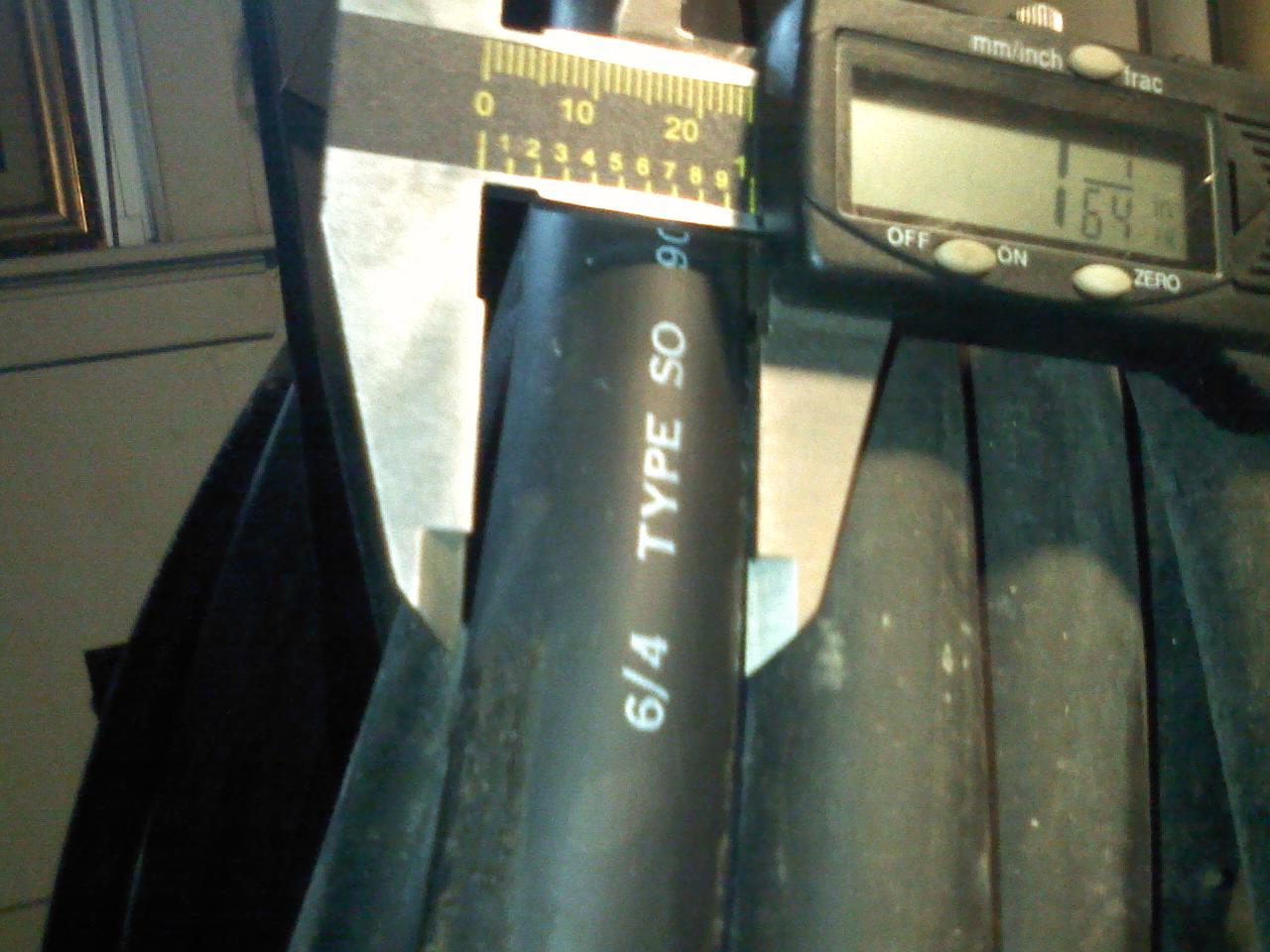

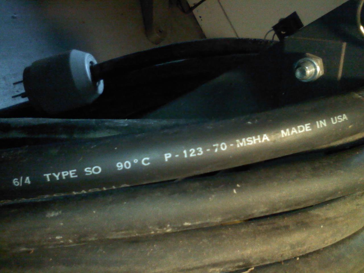

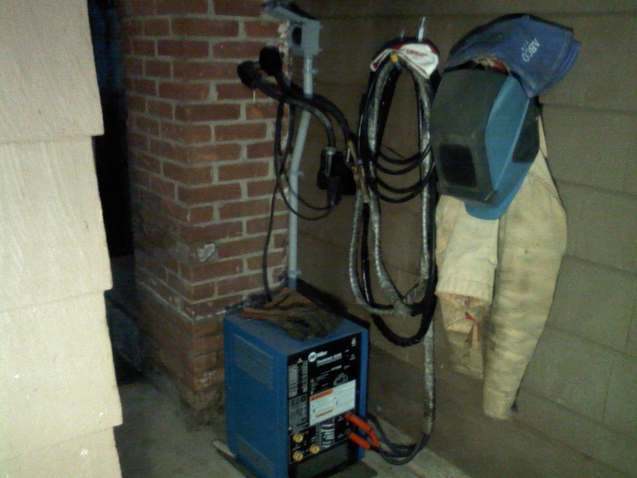

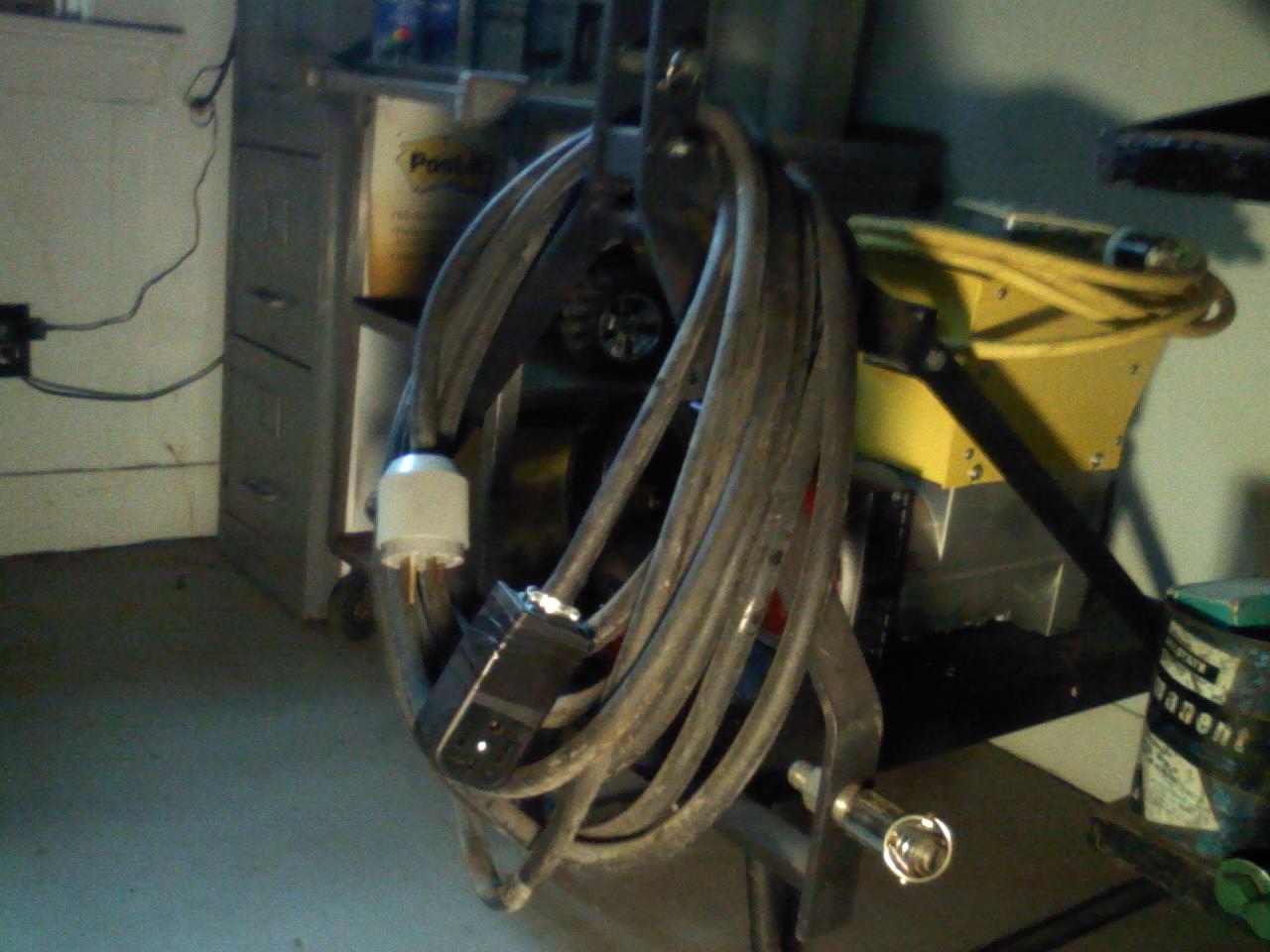

Well I can understand how this topic has caused some division.
I checked my Miller ac/dc machine today, I knew the power cord coming out of the box was fairly small, but was shocked to see it's only a 12/3 wire :confused2:
Says right on the front cover it requires 47.5 amps, so of course I wanted to do the circuit legit and have a 50 amp breaker with 6 gauge wire to the 50 amp outlet. So I guess you could safely use a much smaller extension cord, probably get away with a 10Ga if not going to far???
Like I mentioned I have a monster 50+ foot, 6/4 cable, I got it for free, but if I paid what it would really cost, I might feel kinda foolish finding out it is way overkill. Mine doubles as a whole house generator feed, so I do need the heavier cable. My genny now is 10kw and has a 40 amp breaker, so I guess that 6 ga cable could handle 12kw or maybe more generator.

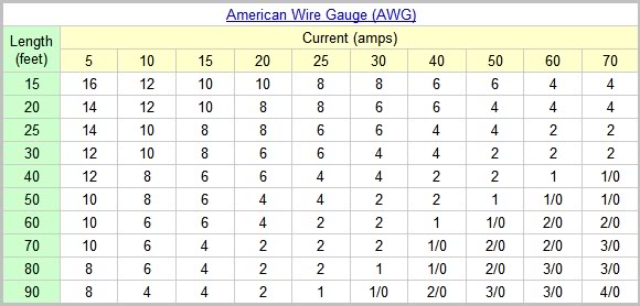

I saw this wire gage chart, does it have any value?
/ Welder Extension Cord #58
I don't know, But it shows 6 ga wire needed for 20 amps at 30 feet :confused:
This chart is at the other end of the spectrum from what you referenced before.
Maybe I'm not reading it right???
JB
/ Welder Extension Cord #59
Every power tool/welder these days has a similar chart in the owners manual telling you acceptable extension cord sizes by length. Easiest thing to do is use that. It would be different for 120v vs 240V as the voltage drop would be worse on the lower voltage.
/ Welder Extension Cord #60
.....Ampacity is ampacity, regardless of voltage. The insulation on the wire must be rated at or above the voltage being used, but an amp is an amp and it doesn't matter what the voltage is when determining the wire gauge.
Sorry, that's just plain wrong. A watt (=volts x amps) is always a watt , but an amp is only an amp at a specific voltage. Ever notice that the 13.5kv line that feeds your entire neighborhood is smaller than either of the 120v lines that feed your house? Same with a welder, the 12/10/8 guage power cord is much smaller than the welding leads. That's because your welding with 1/10th the voltage so a much bigger lead is necessary to carry the increased amps. Otherwisw how could you get 180 amps from a machine on a 40 amp breaker???
Wire charts assume the reader knows that the amperage numbers are all given for the same specific voltage. JJ's chart may be being presented out of context for a purpose. If this chart is for 12 volt automotive work it makes more sense. For example 30 amps x 12 volts =360 watts or .48 hp, whereas 30 amps x 120v =3600 watts or 4.8 hp. #6 wire x 20' will carry either load( according to that chart) but 3600 watts at 12 volts is 300 amps which #6 will not carry for very long...MikeD74T
