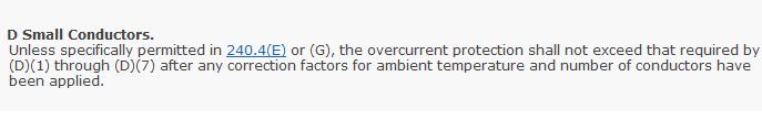

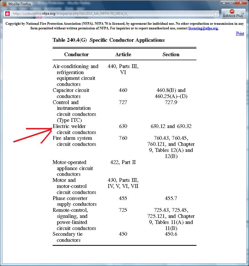

Some of the sources being used to find the data are questionable. A copy of the NEC or a $14 copy of Ugly's is the way to go.
Ampacity is ampacity, regardless of voltage. The insulation on the wire must be rated at or above the voltage being used, but an amp is an amp and it doesn't matter what the voltage is when determining the wire gauge.

Sorry, that's just plain wrong. A watt (=volts x amps) is always a watt , but an amp is only an amp at a specific voltage. Ever notice that the 13.5kv line that feeds your entire neighborhood is smaller than either of the 120v lines that feed your house? Same with a welder, the 12/10/8 guage power cord is much smaller than the welding leads. That's because your welding with 1/10th the voltage so a much bigger lead is necessary to carry the increased amps. Otherwisw how could you get 180 amps from a machine on a 40 amp breaker???
Wire charts assume the reader knows that the amperage numbers are all given for the same specific voltage. JJ's chart may be being presented out of context for a purpose. If this chart is for 12 volt automotive work it makes more sense. For example 30 amps x 12 volts =360 watts or .48 hp, whereas 30 amps x 120v =3600 watts or 4.8 hp. #6 wire x 20' will carry either load( according to that chart) but 3600 watts at 12 volts is 300 amps which #6 will not carry for very long...MikeD74T
