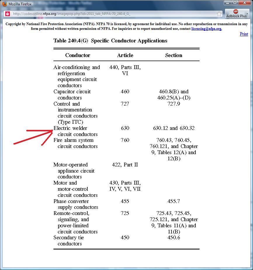

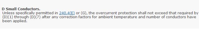

Yes it does apply to welders. The pictures attached are from the 2011 NEC and the same as in the 2008.
Riddle me this............how did I get by with running #10 to my 50A welder receptacle attached to a 50A breaker? Because Section 630 in the NEC allows it.

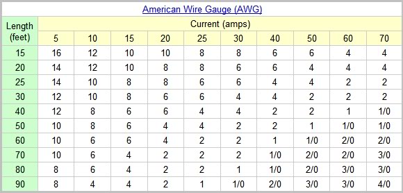

I saw this wire gage chart, does it have any value?
/ Welder Extension Cord #58
I don't know, But it shows 6 ga wire needed for 20 amps at 30 feet :confused:
This chart is at the other end of the spectrum from what you referenced before.
Maybe I'm not reading it right???
JB
