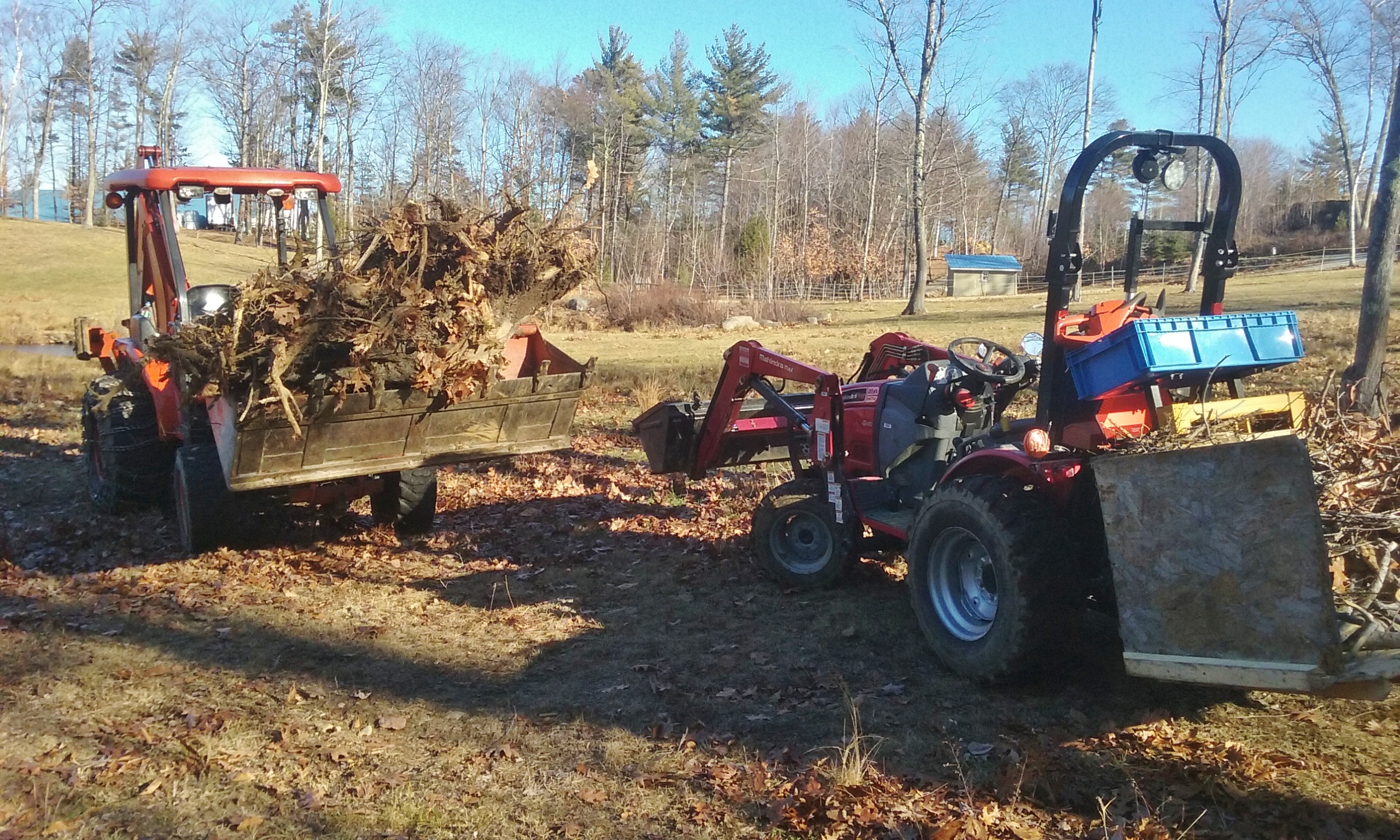

/ Weld on bucket teeth #33
Re: Weld on bucket teeth, Esco Teeth on L39
Esco Teeth on L39

Take a close look at the photo.
Those are replaceable ESCO teeth, with weld on shanks. The ESCO seem much better and durable than CAT teeth. (Like on my excavator.) They were welded with the same rod that welds Sub hulls, done by a pro, not me. ( I "weld" lawn mowers etc. with 6011 or 7014.) The cutting edge is a Kubota cutting edge for the HD bucket, not mild steel, but Its is not AR400 or AR500 hard.
