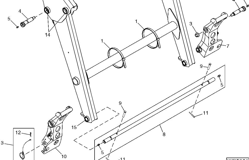

Can you buy one of these or did you make it?
/ weld on brackets for quick attach buckets #31
The 'hook and pin' like I have on the back of this ?
If so, you get them straight from Deere.
(hook #W43359 pin #W47211)

Get the Artillian fork system, then you can add thier receiver hitch. It's all the perfect fit for your 2032.
/ weld on brackets for quick attach buckets #34
I saw that, but I already have forks. The price w/out forks is a bit steep. I need to see what the hooks and pins cost and maybe I'll weld something up.
