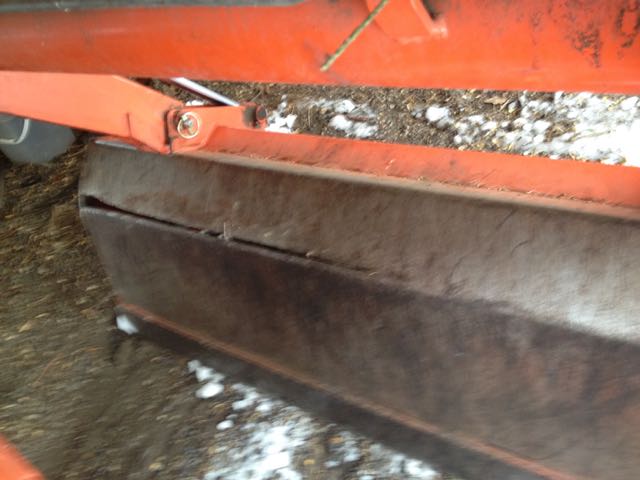

Our tractor bucket has a split along the horizontal bottom seam (along the back). I'm not sure if Dad had literally GROUND the seam down, or if it was a combination of rust and whatever. I'm going to call around for a guy to try repair it with a welder. Can a guy just lay a strip of angled iron along the horizontal edge and weld it on? I mean, i'm not looking for cosmetic brilliance here.what's the best way to fix this?

Yes, that can be done. Or even a strip of flat iron, depending on angles involved. Since you are mentioning rust, I'd be worried about simply welding the crack. Probably isn't enough good metal left at the edges of the crack to hold a weld.
All pure speculation until we see the picture Shane mentioned. :)
/ Weld on a bucket #4
Most farmers would simply weld her back up as best they could and it would last for years. Wouldn't be pretty but it works fine. My old 54 Farmall has several of those types of repairs.

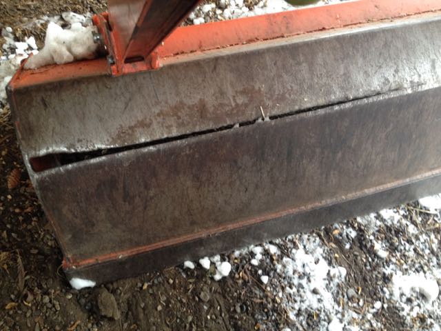

OK...hopefully I've sussed out the attaching-pictures thing.
As a non-welder, is that gap repairable? Can we just slap a piece of iron with the correct angle over the whole corner and weld it down? Or just a few vertical strips to strengthen it?

Weld on a nice heavy piece of angle iron it will be real handy for back bladeing and fix the bucket.

Well I am sure you will get lots of answers, and I can't quite tell where the metal went on the left end, but I am assuming, since I can't look at it sideways that it is curled up, making the left side of the rip much wider.
I would drill a 1/2 inch hole on the far right about 1/2 an inch inf front of the furthermost rightward travel of the rip. This should stop the migration of the crap/rip.
I would beat back down the furthermost left upper sided of the rip and make it meet as best can with the lower side.
I would start a nice bead on the bottom of the rip, clean, and keep laying beads on top of my first bead until I encompassed the upper piece of metal, making sure I got good penetration for the tie in. If metal is just gone on the left and you can't make the crack come anywhere meeting, then yes lay in some metal piece and burn it in. until you are satisfied. 1/8 7018 at 120 amps or maybe a bit less is where I would start, looking at how it is burning in on that thin materiel as you might have to back it off.
Clean the bead well after each pass with a wire wheel so as not to trap any slag. and weld up the 1/2 inch drilled hole.

No problem, I believe the bucket is very repairable by someone with even my very modest welding skills. It would not be much of a job for a pro. Good luck in getting things put back in order...

With the information given,,,, I'd repair this from the inside of the bucket. Using the single piece of flat iron I referenced before. This will reinforce that area and prevent a crack later on. Happy welding!!!! :)

If it were mine I would get 2 pieces of flat metal and cut them the length of the bucket. 1/2" or 3/4" thick if you want to over do it and 3" or 4" wide if you can fit it. Since the angle isn't a 90 degree bend it will be hard to fix it with a piece of angle iron. The angle will wear fast on the corner and you will have the same problem you have now. The two flat pieces would butt right up against each other on the outside of the bucket and weld them to the bucket and then to each other where they meet. It will give you a good wear strip and it will be a while before it happens again.
/ Weld on a bucket #14
It looks like that bucket has spent a lot of time back dragging with the heel of the bucket. I agree with Shaneard to weld on 2 full length pieces of 3-4" wide flat steel.
/ Weld on a bucket #15
Shaneard X3. A welding shop might be able to add a little hard facing to make the patch last a little longer.

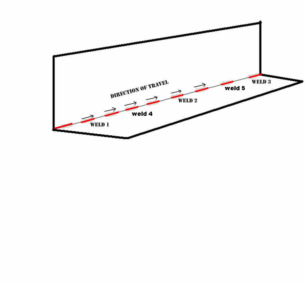

Shaneard has a very good plan!
This is how I would weld it, so the heat from welding doesn't warp the flatbar, and bucket. You must skip around a lot!

Koua's method is exactly what I was thinking before he posted .

I'm on board with Shaneard as well, but SA, I lost you after weld no. 6! :laughing:
