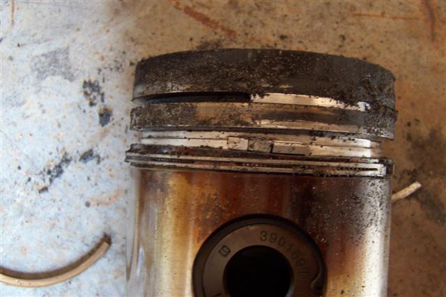

Dave,
The attached picture should help with understanding how the sleever works. Basiclly it is the cylinder wall for the pistons. It is completley surrounded by water, thus it's a "wet" sleeve.
The bottom of the sleeve sits of four prongs. I drew a red circle around one of these.
The middle of the sleeve is a perfect fit into the round ring you see in the picture. This is a machined surface that is the bottom of the stroke for the piston.
You can see above this ring the water cavity inside the block. This is the aread around the combustion chamber.
The top of the sleever has two levels. One is flat with the deck of the block. Then the inside portion of the sleeve is taller and slides into the cylinder head.
These two heights combined with the head gasketp and 148 lbs of torque on the head bolts holds it all together.
From what I can tell, there is absolutely no rust or pitting of any kind inside the block or on the sleeves. I've always had lots of anti freeze and will put 6 gallons in when I refill it.
Eddie
PS. When I get it runny, I will post plenty of pictures of it in operation. I have way too many projects for it to accomlish!!!
