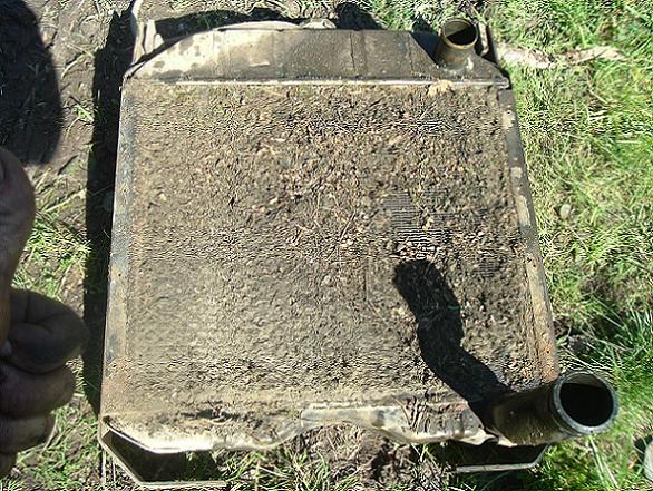

Eddie, You mentioned the radiator mess, If the radiator is still good which I assume it is , I would take a pressure washer to it with a wide spray after soaking it with a degreaser..
I would also do the valve job while the head is off, cheap insurance... and shouldn't be too expensive...

Please don't use a pressure washer on the radiator fins. The washer will flatten the fins and damage the radiator beyond repair. Don't ask how I know this /forums/images/graemlins/blush.gif. Take it to a radiator shop and have it boiled out.

Dozer, You bring up a good point, I have an electric one (1650psi) and with the nozzle set to wide fan the pressure is reduced quite considerbly... I would just start in from a distance a work in gently, Aren't dozer radiators a little heavier in construction in the finned area? but like you say it could be detrimental if to powerful.... Just thinking...I tried /forums/images/graemlins/crazy.gif
