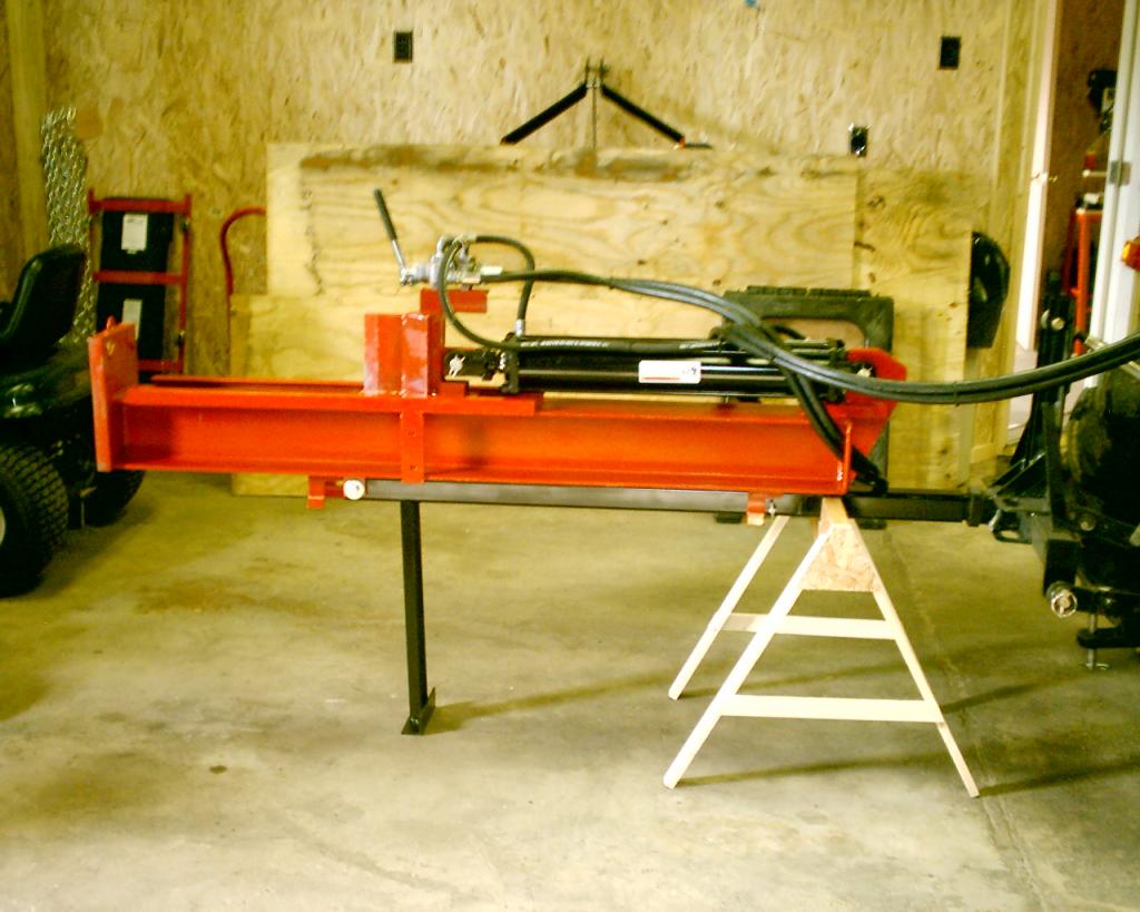

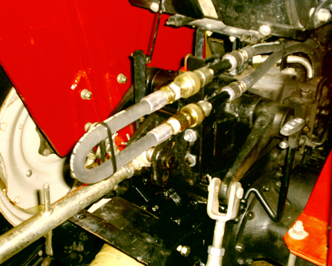

I have the same setup as you do with the 24" piece of hose completing the circuit on my power beyond as described. Here is a pic. I can use mine for things like a backhoe and I also use them for the log splitter I made.
Like stated before, never remove or try to start the tractor with the jumper hose in place or a open center hydraulic accessory attached.
