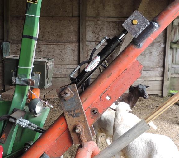

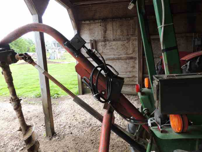

A better idea is hydraulic power down on the PHD. More controllable, less work, not terribly difficult to fabricate.

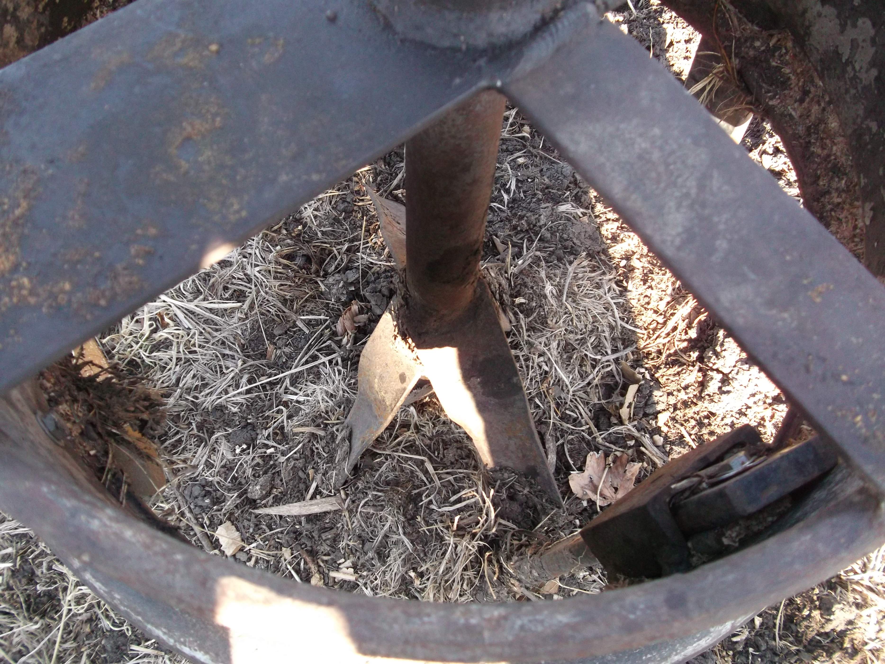

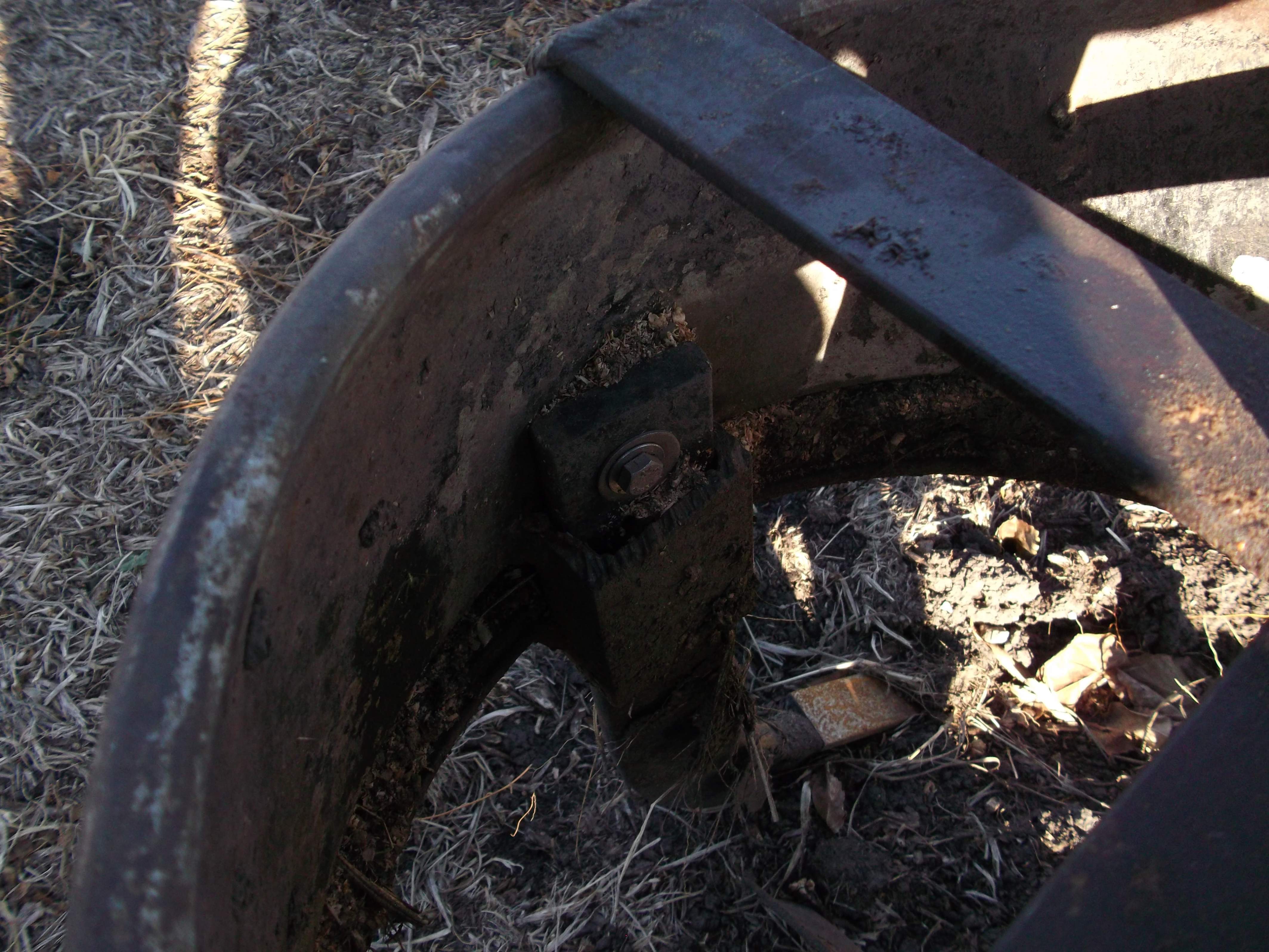

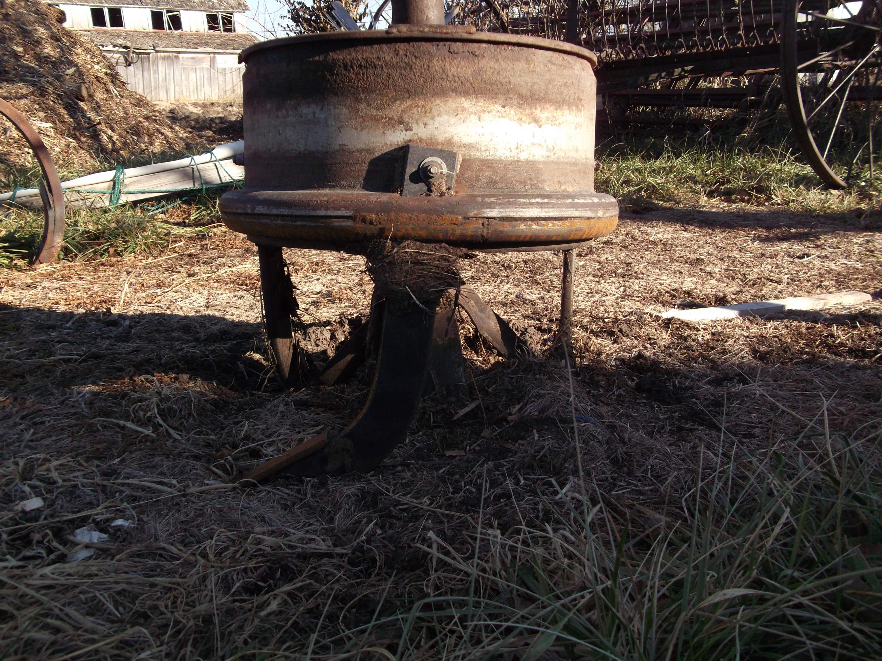

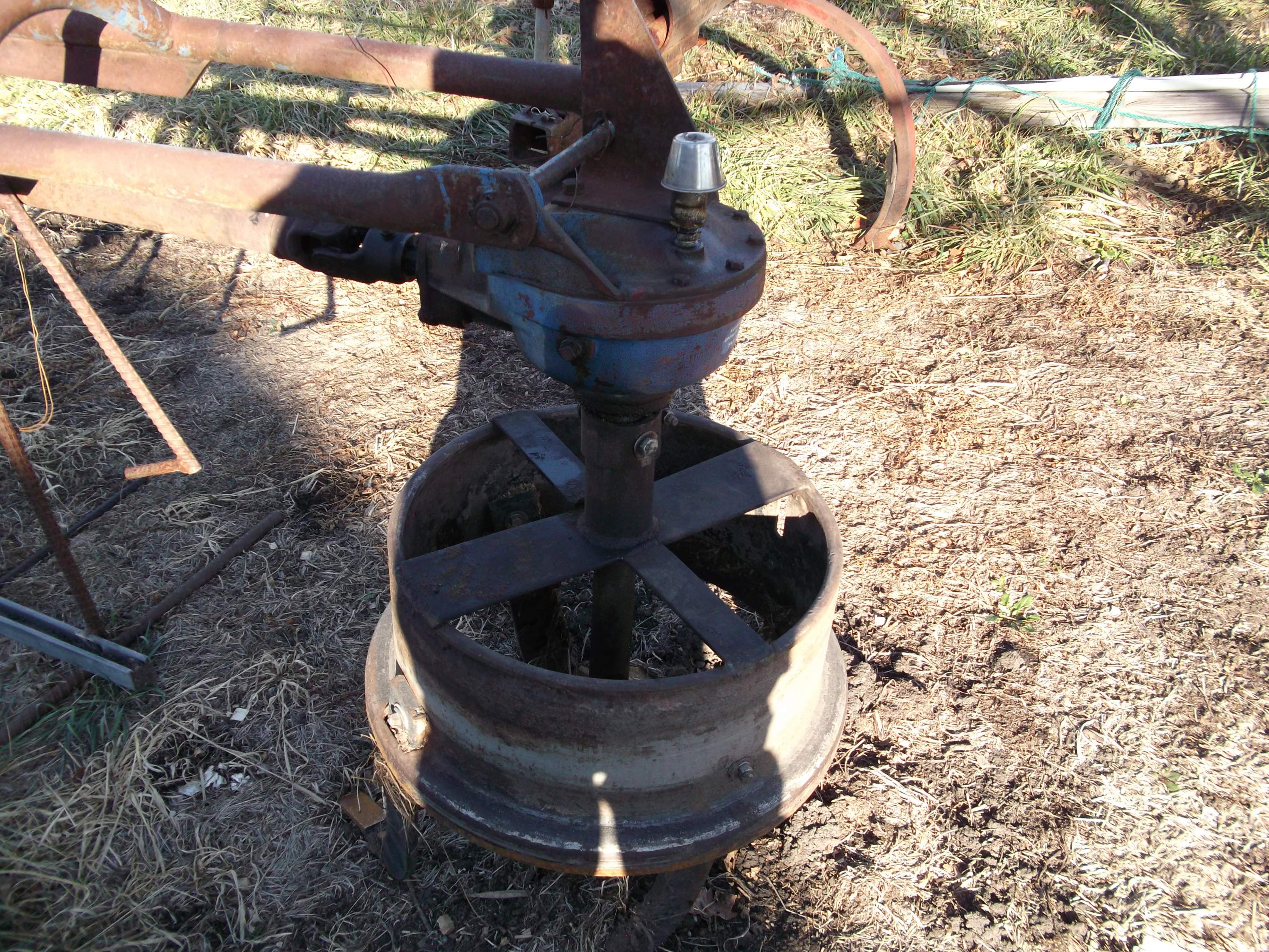

I do the same thing and use my PHD for tree planting.

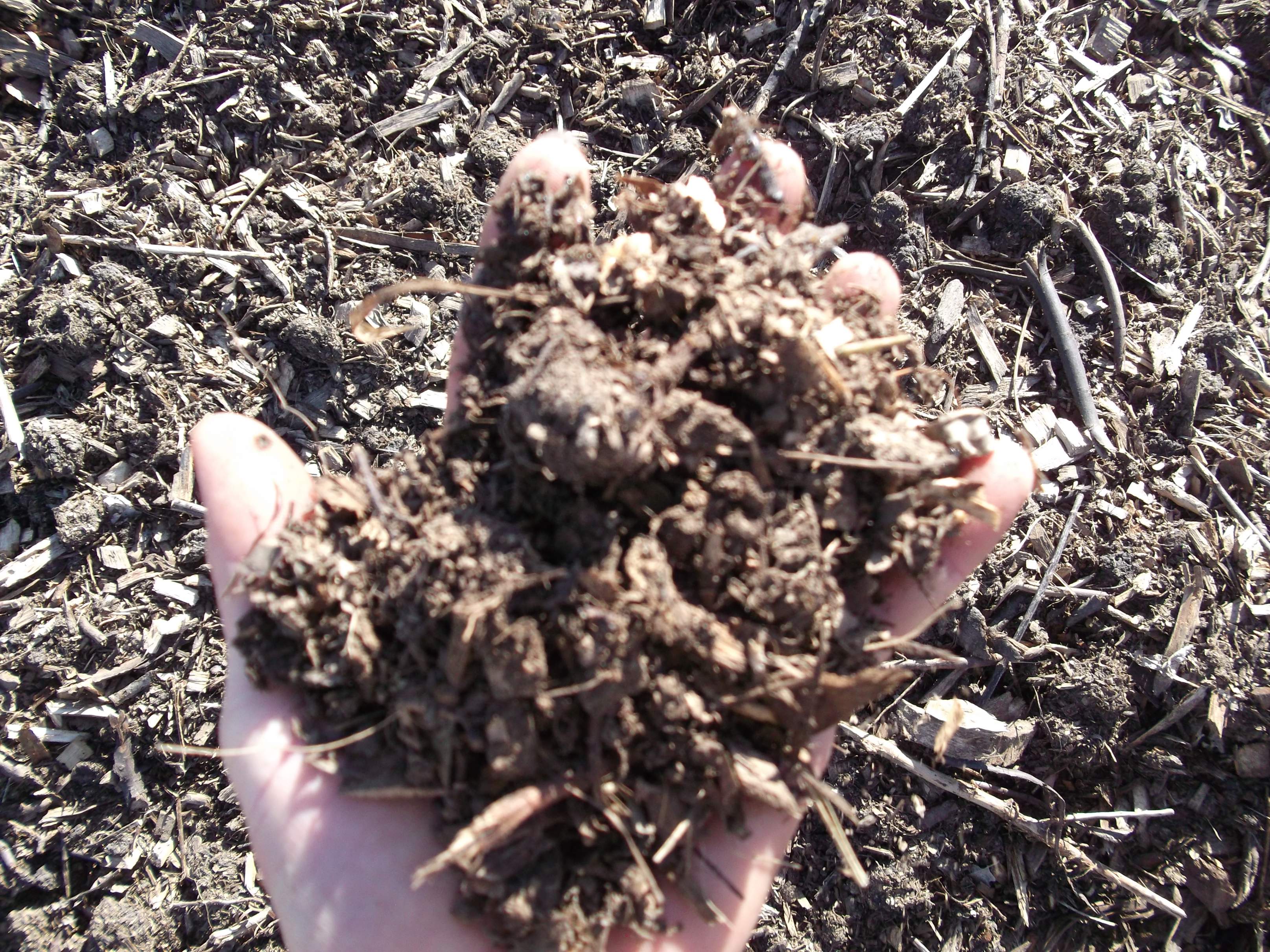

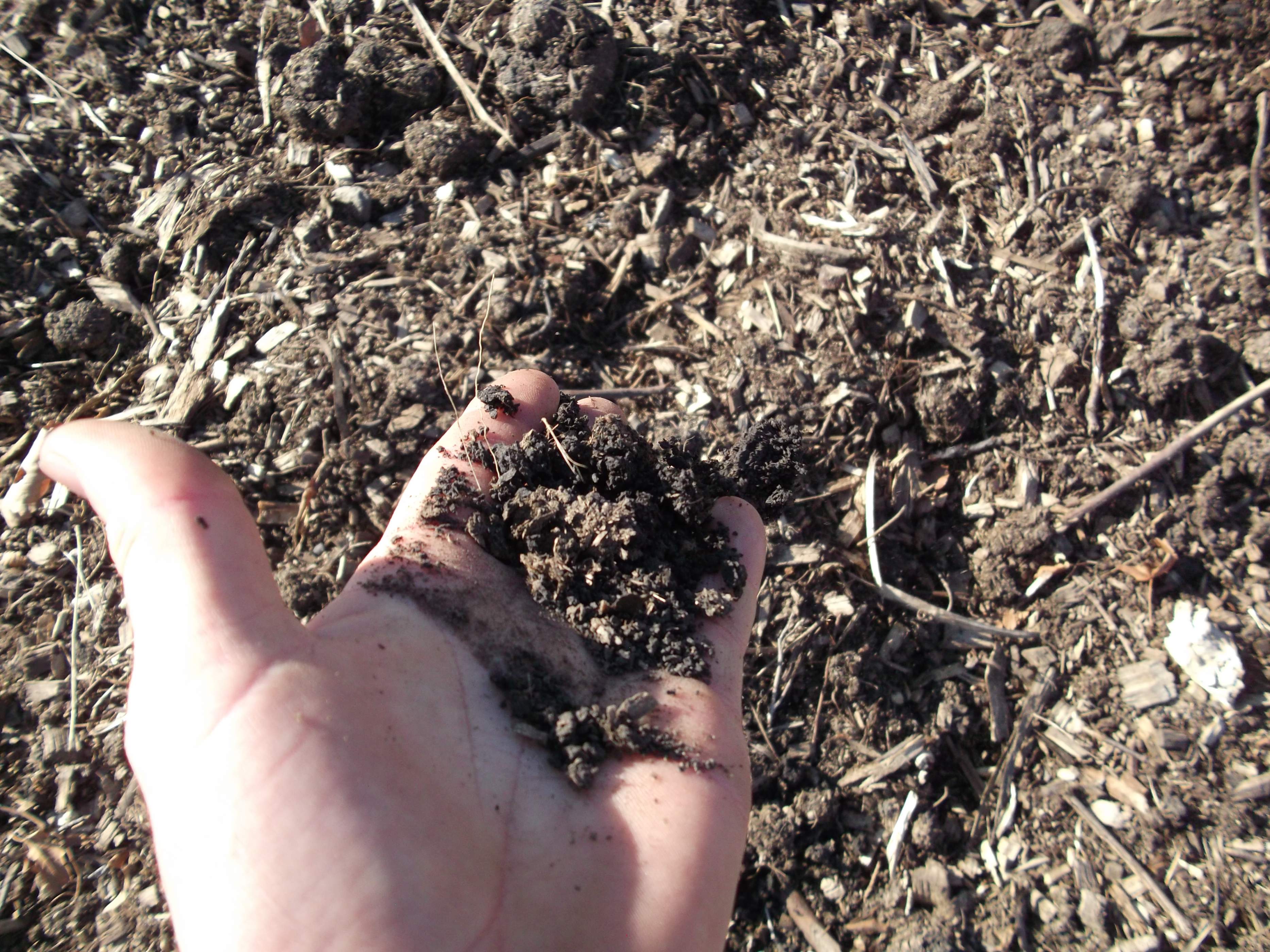

Instead of using the auger I built a bit out of an old rim(maybe around 24") some pipe and I bought a replaceable auger tip from Tractor Supply that is threaded and welded a nut into the center of a piece of pipe and threaded it in. I then used ripper teeth from my box blade welded slots into the rim so I could pin 4 of them in across from each other 2 on the inside of the rim and 2 outside. Then, the old lawn mower blades I welded on the center pipe at various angles downward. It cuts the dirt up very well but if the dirt is moist and sticky it can turn the clay into round balls so as I am drilling I take saw dust, leaves, and wood chips and throw them in to help keep the soil broke up and loamy. (Note: grass clippings do not work well as an amendment as they just catch on everything and do not mix in well)
Just an idea if you have a good amount to plant.
I know it has saved my back a lot of dirt work.

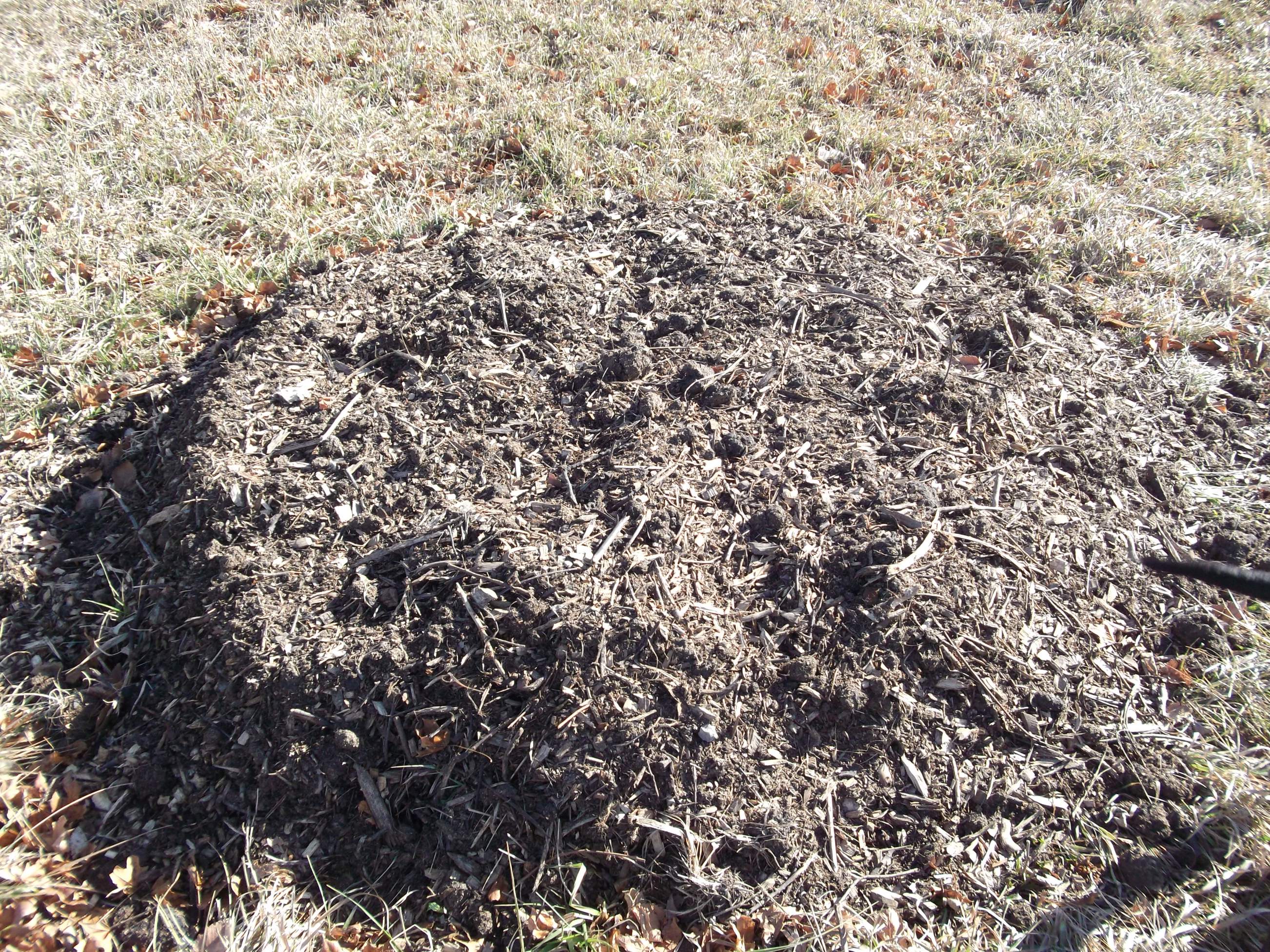

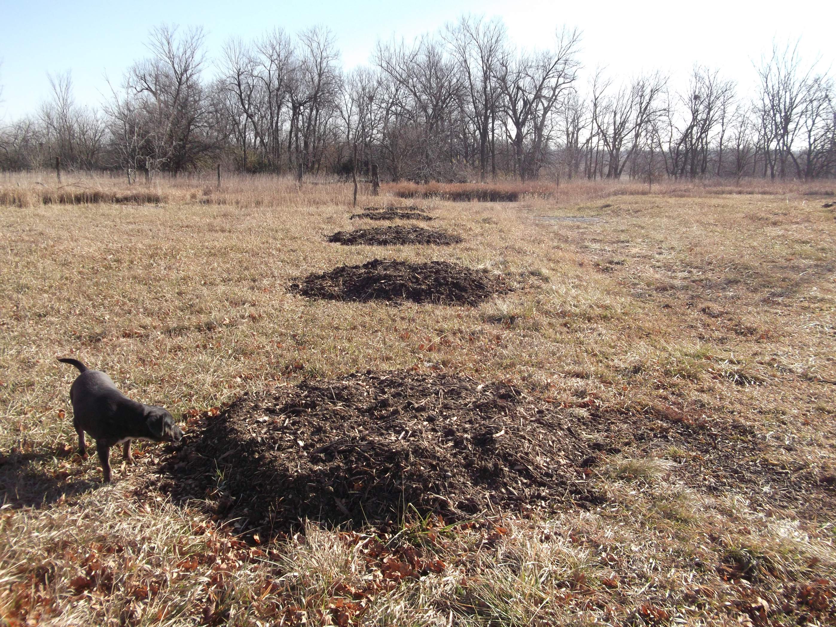

Here are some pics of the PHD/ Tree planter and some pics of the soil afterwards.
DSCF5153.jpgDSCF5154.jpgDSCF5155.jpgDSCF5156.jpgDSCF5157.jpgDSCF5158.jpgDSCF5164.jpgDSCF5165.jpgDSCF5166.jpgDSCF5167.jpg
/ Weight position on PHD #11

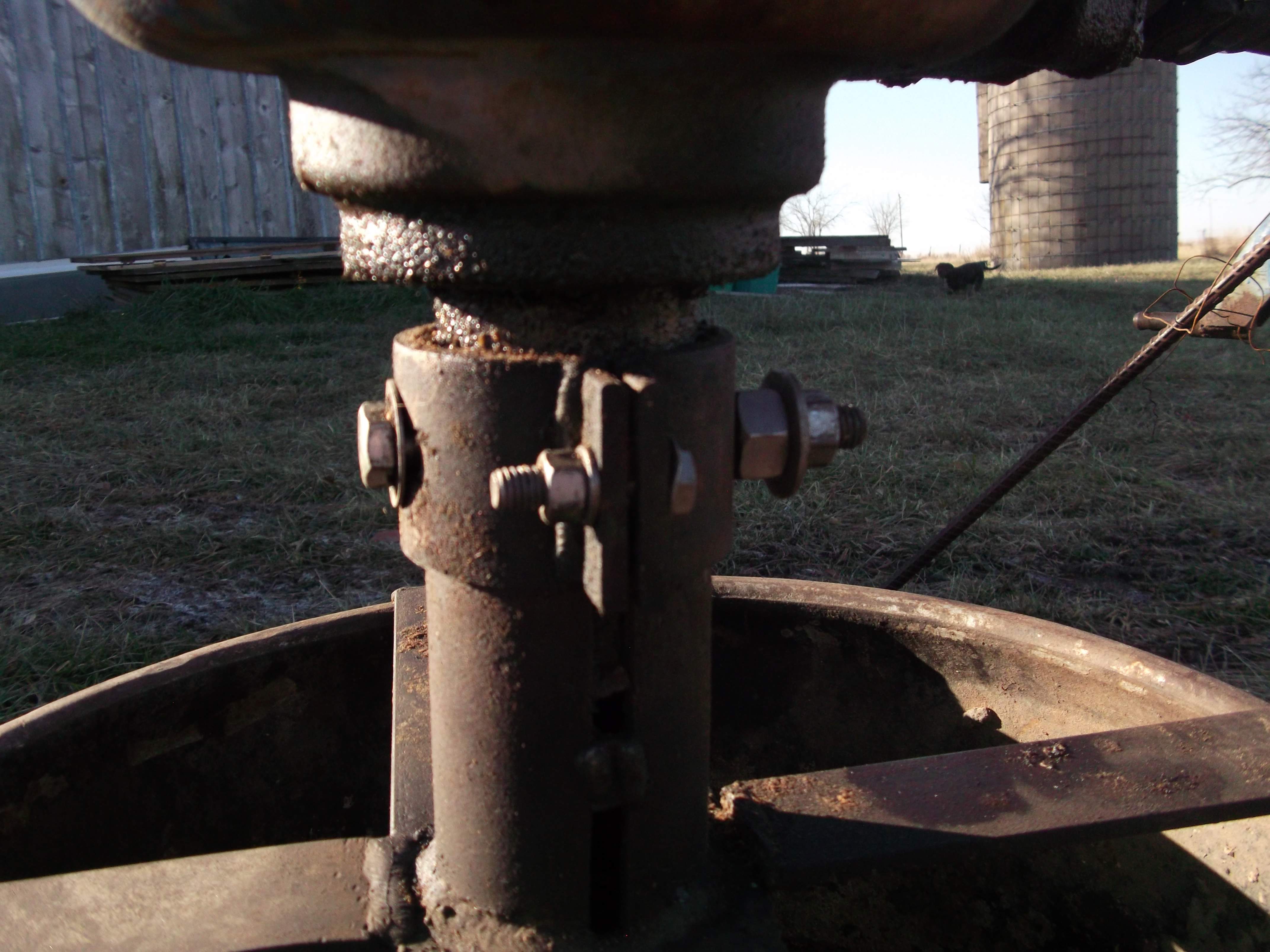

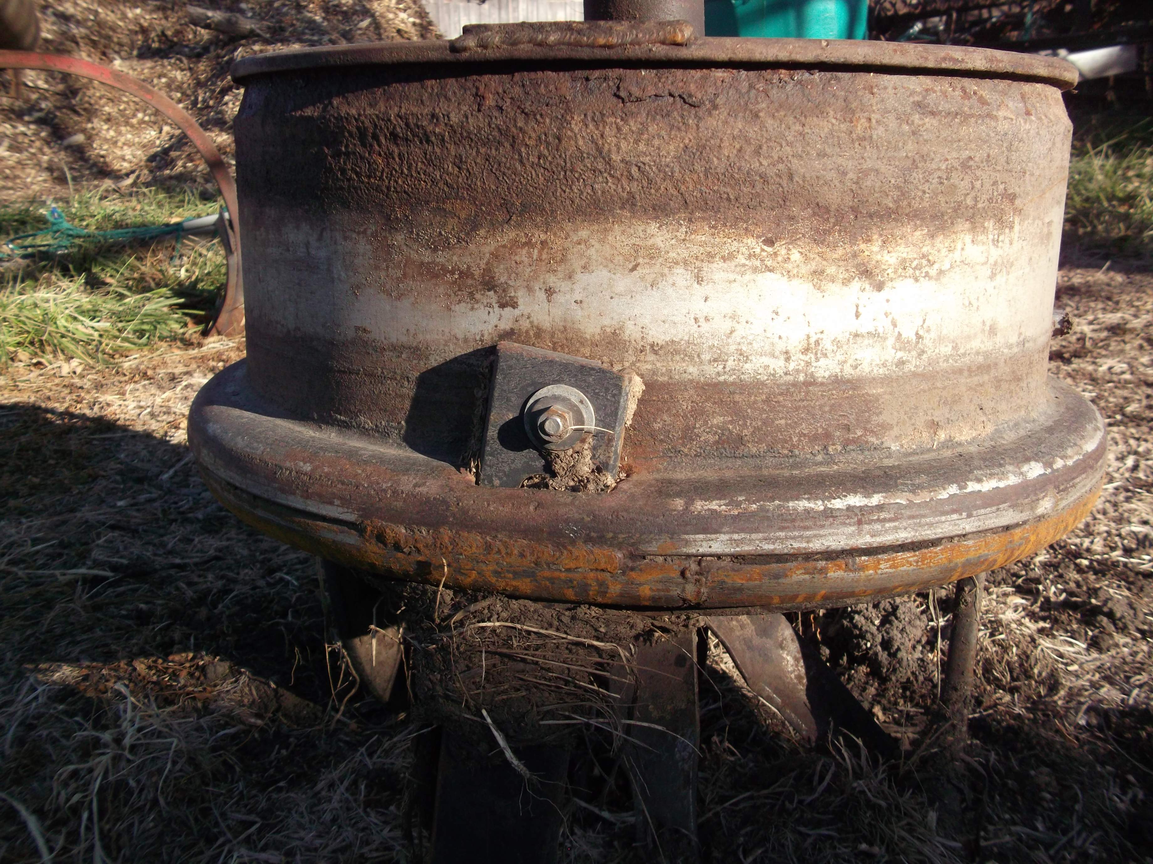

NOTE:
The sixth pic is showing a small but important part on the bit. On my phd the shaft has nothing but a sheer bolt to secure the auger and with this size bit the twisting stresses would break the bolt since the diameter of the pipe on the gearbox shaft is not a tight enough fit therefore it does not hold snug to the shaft. Hence I made a collar clamp and it keeps the sheer pin from breaking.
For the pipe around the phd shaft I took a piece that was a little too big sliced it and formed it as tight to fit as possible. Just didn't want to wait another weekend to go find a piece that fit. As this build only took about 3 hours I was not interested in perfection but in production but if you can find the right size for your phd you might not need the collar but I recommend it.
