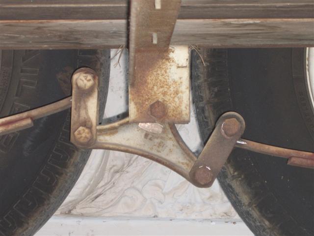

just having leaf springs on it does not mean it has equalizers, on the unit, equalizers are the middle part that pivots and the springs are attached to.
I have seen trailers built with out of the equalizer. (why I do not know)
