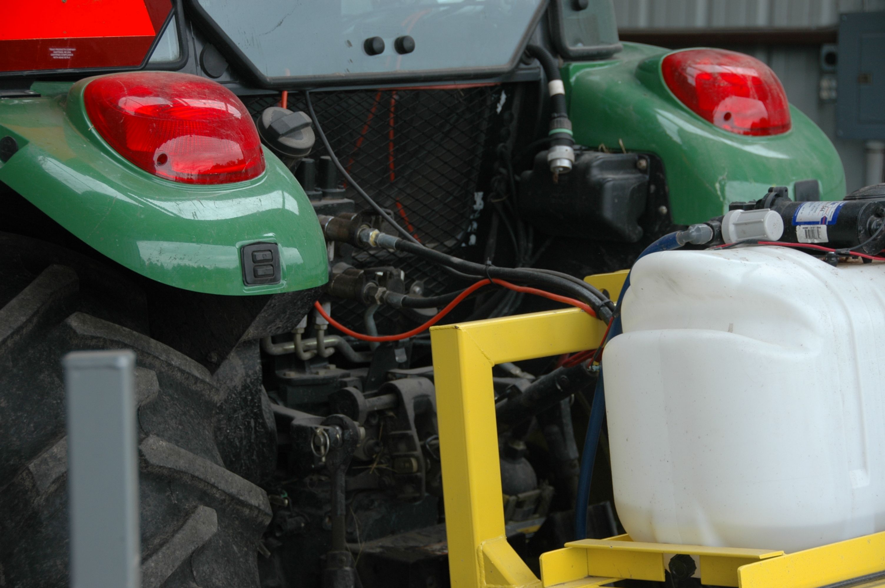

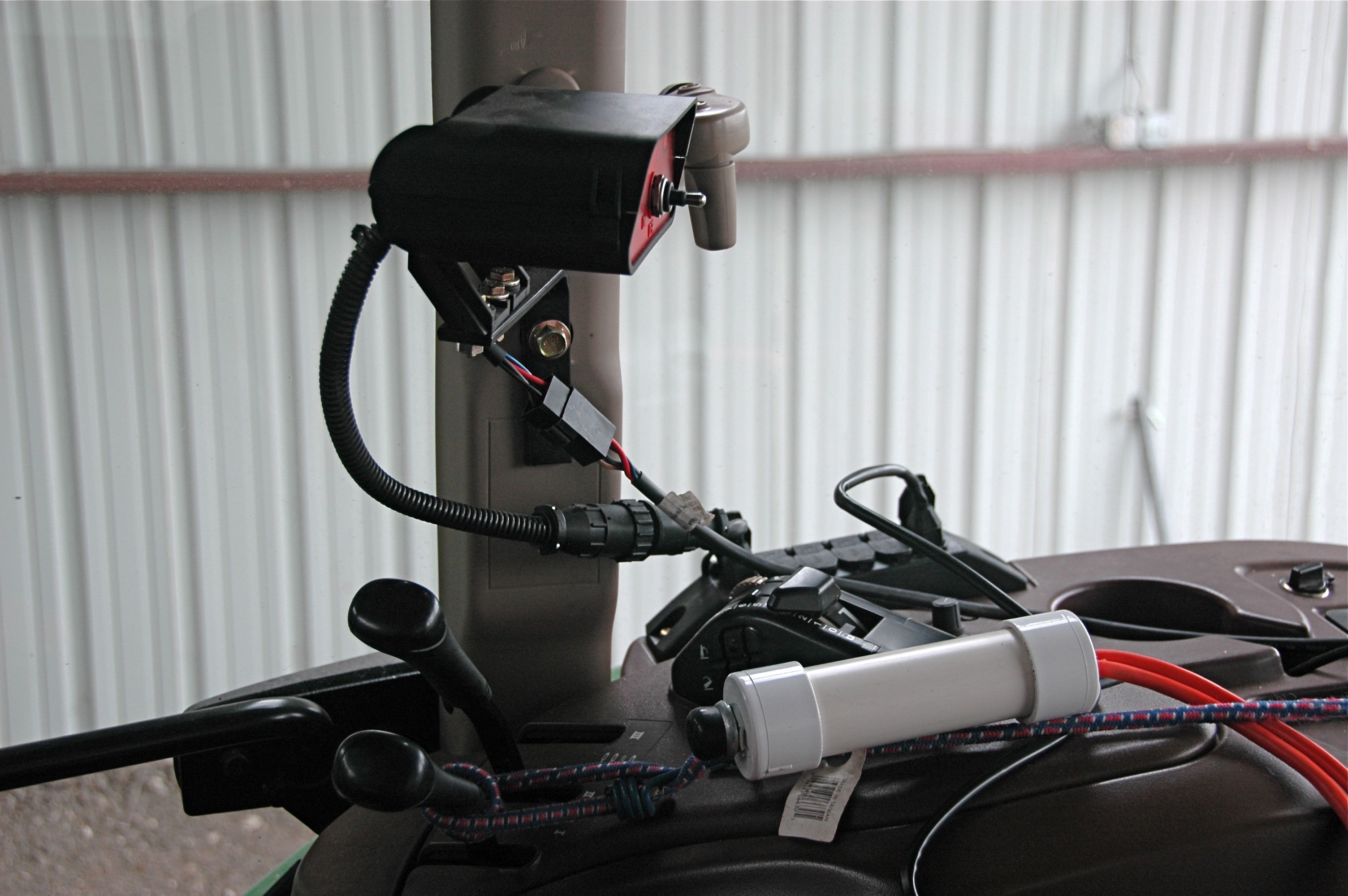

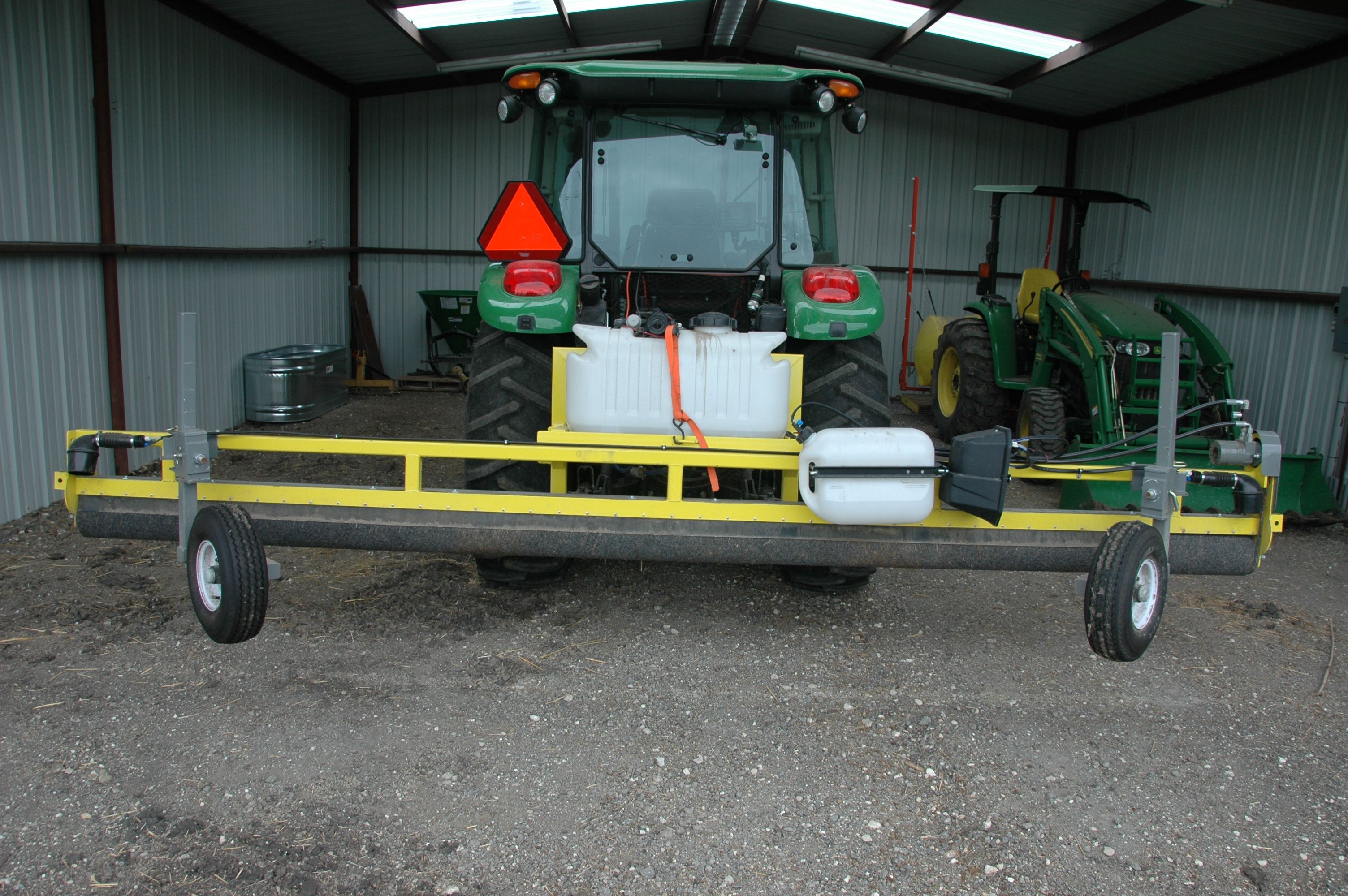

/ Weed Control - What is everybody using?
#25
Here are some pics. The first one is a pic from the rear. Middle tank is 25 Gal sprayer. The one of the right is the foamer 2.5G. The foamer pump is to the right of the tank.
The second pic shows the hook up to the tractor. 2 hydraulic lines, black cord for the foam marker, and the orange cord is for the sprayer.
3rd pic shows the in cab controls. Red faced mounted box is for the foamer - left and right. White PVC piece with the switch is for the sprayer and the bungee cord is to hold the lever in the run position (wish I had the deluxe valve package).

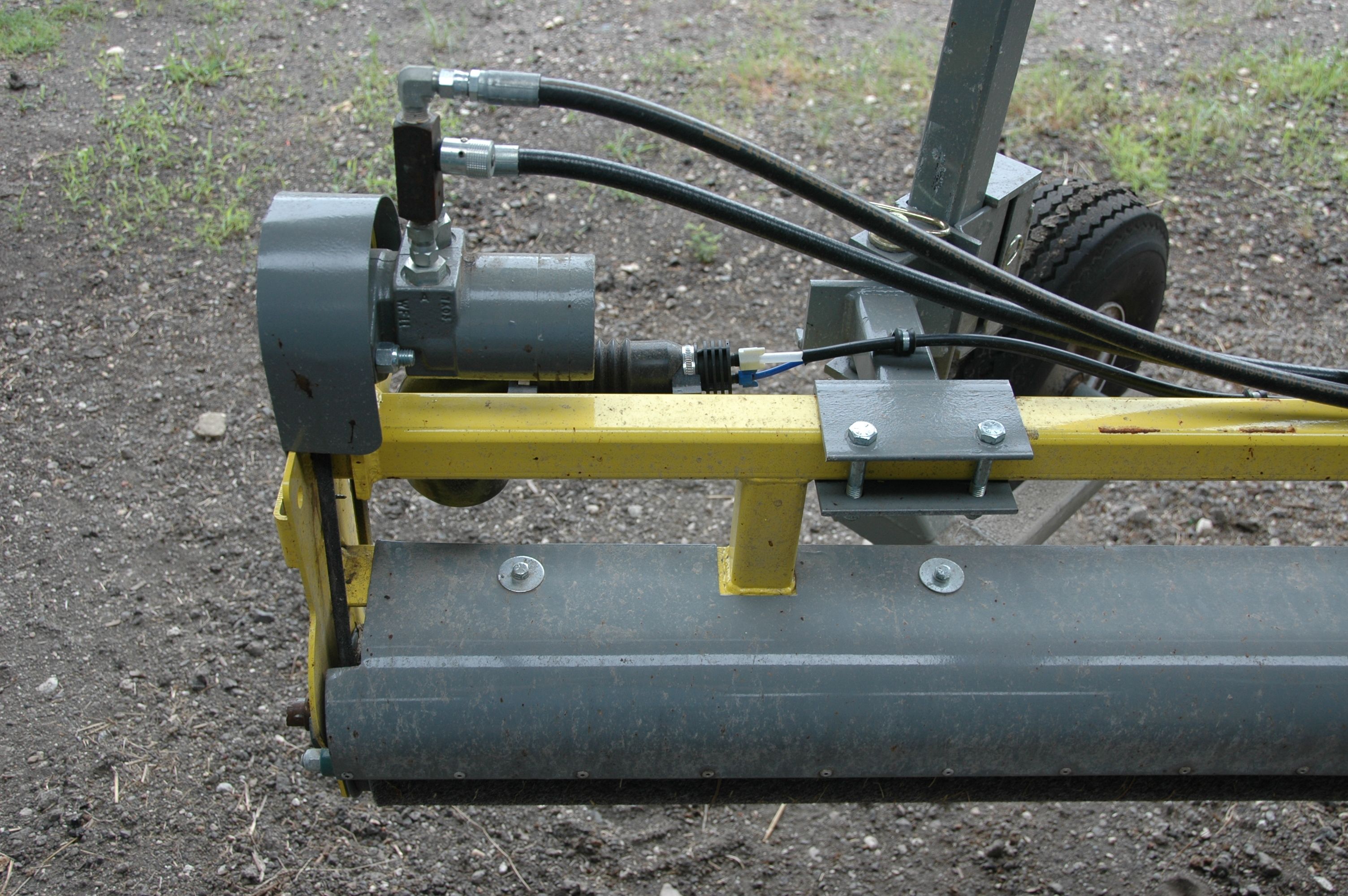

#26
Some more pics.
1st pics shows the carpet roll pretty well. Note the rubber piece missing. It was too long and got caught up in the belt. I just cut it off - looked like too much work to replace.
2nd pic shows the hydraulic motor and belt setup.
3rd pic - the ray shield covers the spray nozzles, etc.
4th pic shows the gauge wheels. They don't mess around - very well made. I recommend these. It is something to set the machine down on (it does come with stands for storage). Also, in uneven terrain it will keep you from messing it up.
D.

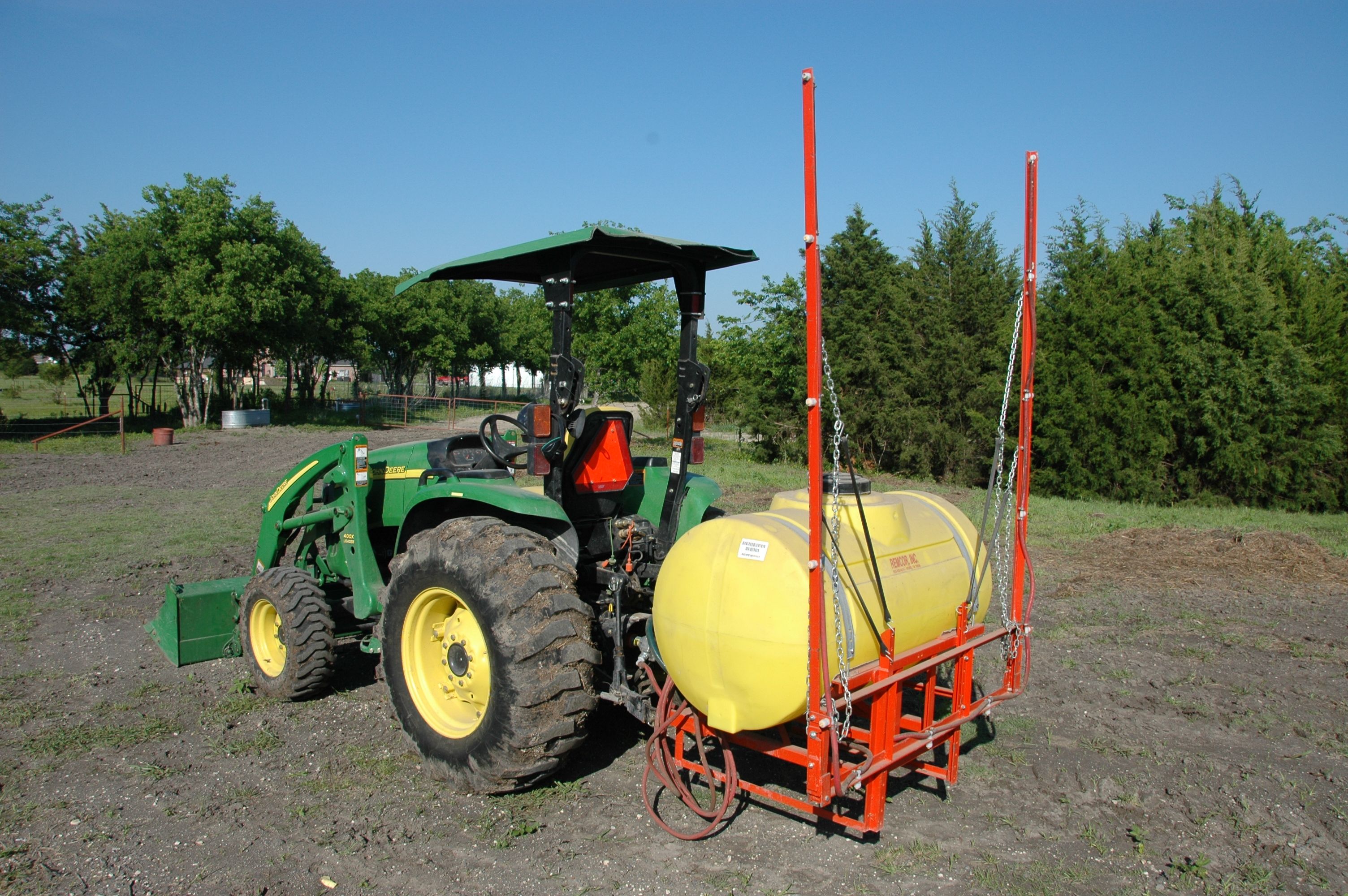

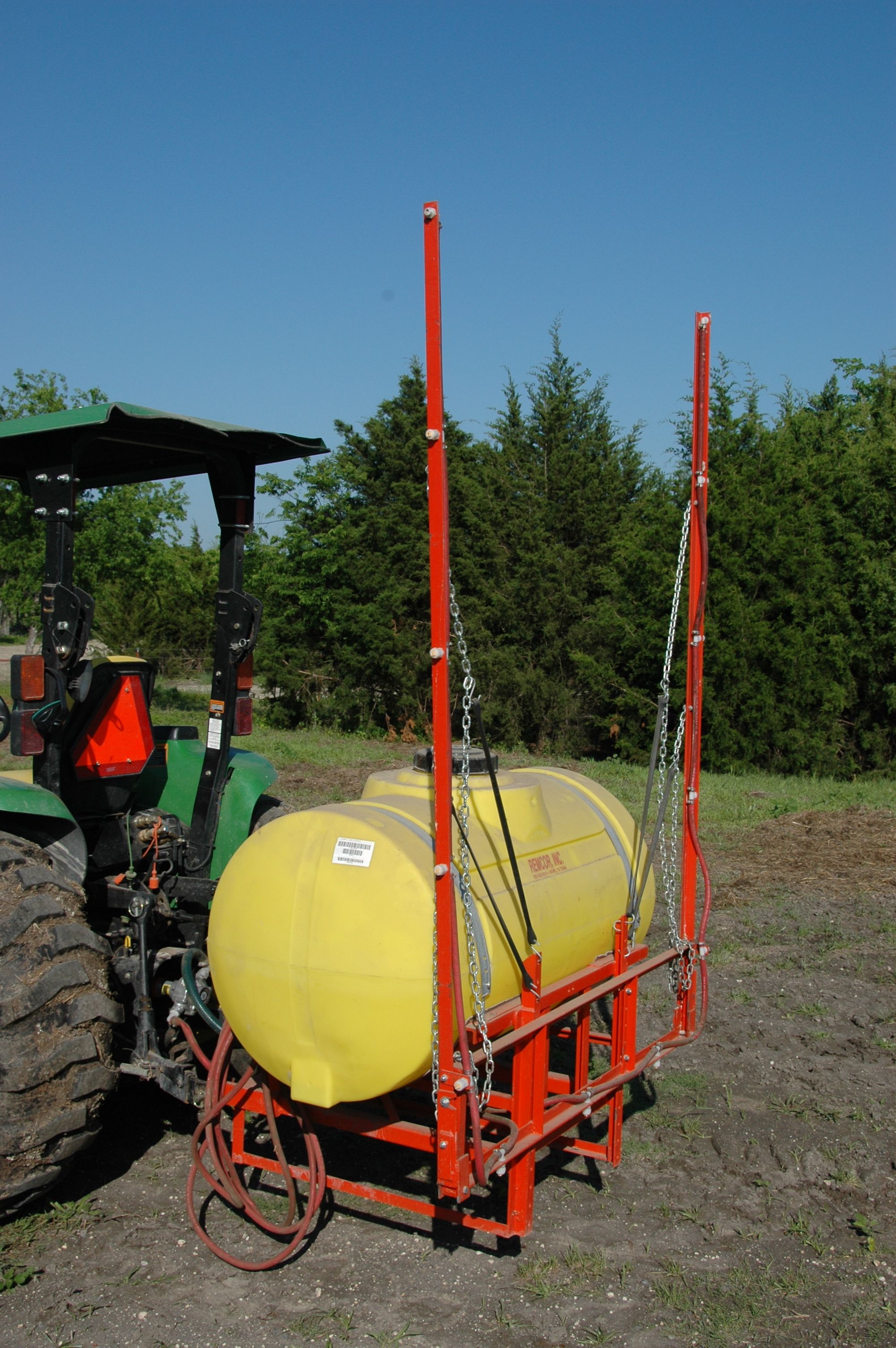

#40
Here is my smaller spray rig with pics.
150 Gal
Boom
Gun
PTO powered
Can do left, right, or both booms and gun anytime.
Made by Remcor, bought thru my JD dealer.
D.
