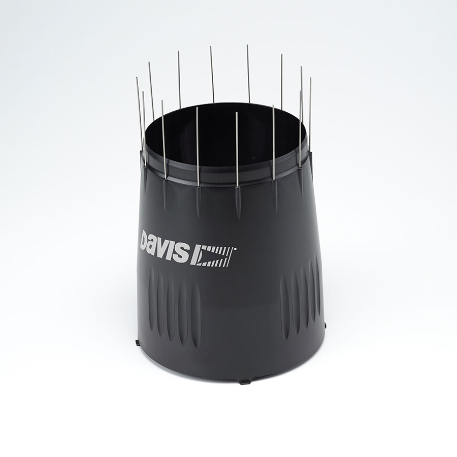

$425 is bare bone station. If you add solar illumination , UV and soil temp sensors it would cost over $1000. Make sure that the rain collection cup is the newer style with bird protection. Otherwise they will crap in it and plug the port.
