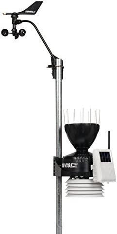

As a meteorologist and general weather nut, the truth is that there are 3 categories of weather station.
You have ALL of the box store type stations grouped into one category. Ambient, Oregon Scientific, Accurite, all of them. Doesn't matter if they're $50 or $250. They all use the same grade of sensors, communications, and power type. Your temp readings will be inaccurate on sunny days or if you mount it too close to the house. Your wind readings will be too low because you can't mount the anemometer separately. You'll likely need to change batteries often. Transmission range will be weak. And you will be very lucky to get 5 years of service out of the unit.
Then you have Davis Instruments. Their Vantage Pro 2 system is a huge upgrade. Typically $500 and up depending on options but WELL worth it. High quality temp/hum sensors. Fan aspiration to keep readings spot on even in summer heat. Very long transmission range. Batteries last years. Tons of upgrades and options (soil moisture, UV sensors, radio repeaters, mesh systems together, etc.). These stations will also last 20+ years. The performance will be very very close to official mesonet sites.
Then you've got scientific grade/official stations. These are the ones universities use, as well as government agencies like NWS, etc. You're talking way out of budget for a home owner. Not to mention station maintenance costs.
I personally rock the Davis VP2 with 24 hour FARS and LOVE it.

Been considering a Davis to replace my Ambient. Can you comment on how easy it is to connect to the web / computer / iphone ? I have not been able to get a manual to determine the steps and would like to know more about it. Also, I have an existing pole, do you know what the size/s can be to mount the unit ?
I am slightly confused about the mounting. Why would the rain gauge be so close to the pole? Seems if the rain was falling from the opposite side, it might block some/interfere?

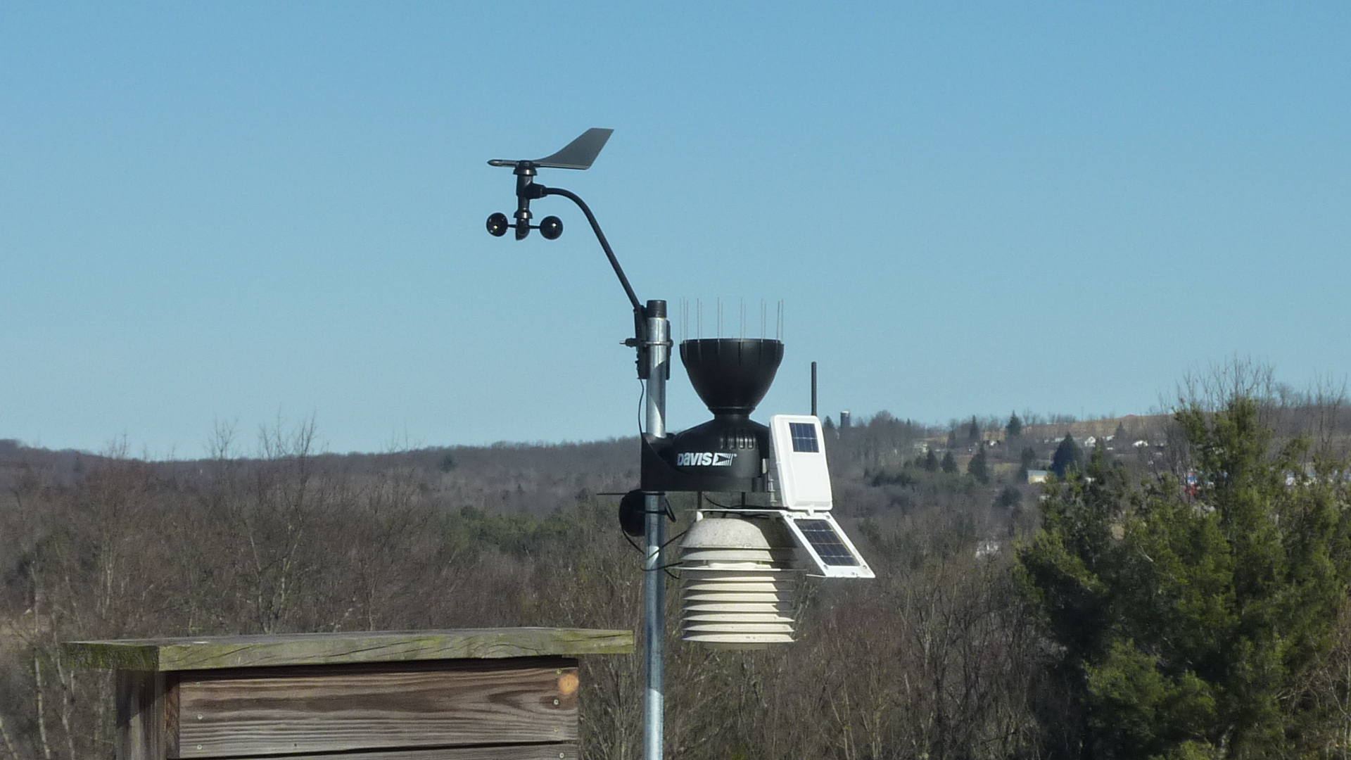

I also have a Davis Vantage Pro2 wireless station. It's been in continuous operation for over 15 years with little maintenance. One of the reasons I chose the Davis station was it's ability to use repeaters to transmit data over considerable distances. I have the sensor array mounted on a pedestal on top of a hill 1/4 mile from the house.
The anemometer can be located separately from the other sensors but I have both mounted on the same pole. I compare rain data with a NOAA approved analog rain gauge and have not noted any significant difference in readings.
