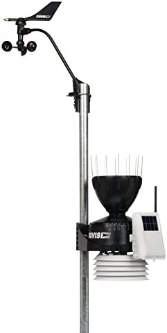

Been considering a Davis to replace my Ambient. Can you comment on how easy it is to connect to the web / computer / iphone ? I have not been able to get a manual to determine the steps and would like to know more about it. Also, I have an existing pole, do you know what the size/s can be to mount the unit ?
View attachment 774548 I am slightly confused about the mounting. Why would the rain gauge be so close to the pole? Seems if the rain was falling from the opposite side, it might block some/interfere?
The Davis WeatherLink software is pretty cool. I don't remember it being difficult to set up. They sent me a small unit that plugs into my router via a short ethernet cable. It then automatically sends data to Wunderground and also Davis' online WeatherLink site. I've had it up and running for 18 months or so now and it's been flawless. I can check the conditions reported from my station anywhere I go. I have the app on my phone too.
Don't quote me, but I think you need a 1 to 2" pole for mounting, OR you can mount directly to a 6x6 post or wall. I prefer pole mounting. I have mine on a section of TV antenna tower that I erected specifically for my weather station. My anemometer is at the top of the tower, my Davis ISS is at 6' AGL which is standard in the meteorology biz. The rain gauge could have interference from the pole, but typically it's only an issue in very heavy driving rain and it's not generally enough to cause readings to be off by much. The bird spikes are a great addition on later models of this station. I do highly recommend the FARS for accurate summer temp readings. The capacitor/battery system onboard has gone 3 years or more without needing a change for me. I love it.

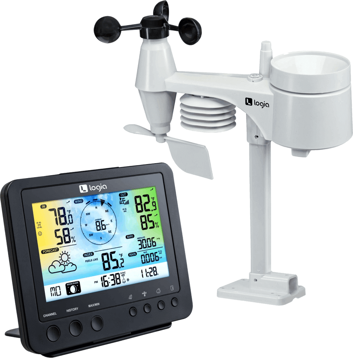

When the AcuRite Iris I gave him fell apart a friend purchased a Logia 5-in-1 which seems to be as good or better but $120.
I am impressed with how much control Logia gives the user. How they are not ashamed to tell you how to telnet into it to play with knobs.
We'll see how the Logia's plastic holds to UV.

Oh man, you can play with the knobs on that? I'm pretty good a jacking things up and needing to do a factory reset.
