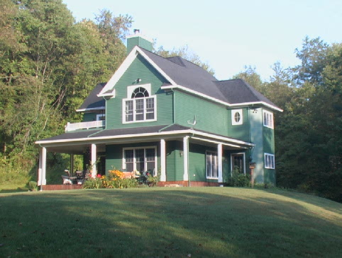

/ Weather Station Recommendations
#25
The nearest weatherunderground station is about four or five miles away from me. Heck, it could rain two inches there and I might not see a drop for the garden.
I couldn't even come close to the tree tops on the west side of the house if I went to the peak of the roof. I know darn well that I'm not going up there either.
Mark
/ Weather Station Recommendations #26
Yep..that roof sure would be a PIA to work on! I see one option that MAY work for you, that chimney seems to be large. Normally I would not suggest to mount an annemometer near the soot but it may be large enough to offset the gauge and if you have it on a 10ft mast or so it may do just fine since smoke USUALLY does not climb that high unless there is NO wind.
But still you are right those trees are going to be tough. This weekend is a good example. Opening day of hunting season and I am at my food plot, the wind was howling at the crack of dawn, had been for a few days and it did not let up. I finally came back home and looked at the station, no more than a single 10mph gust and my sustained winds had to be over 10mph with gusts over 20mph.
The plot is not perfect but if I can get the wireless range it will be better than at the home. It's just going to have to wait.
