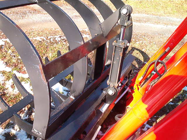

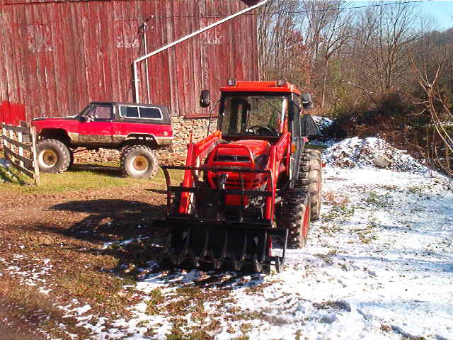

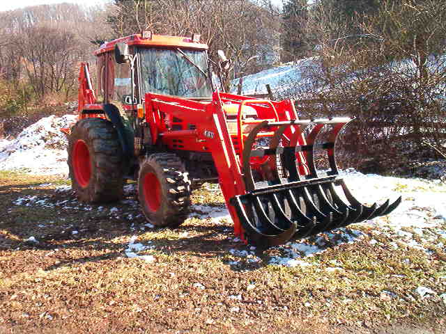

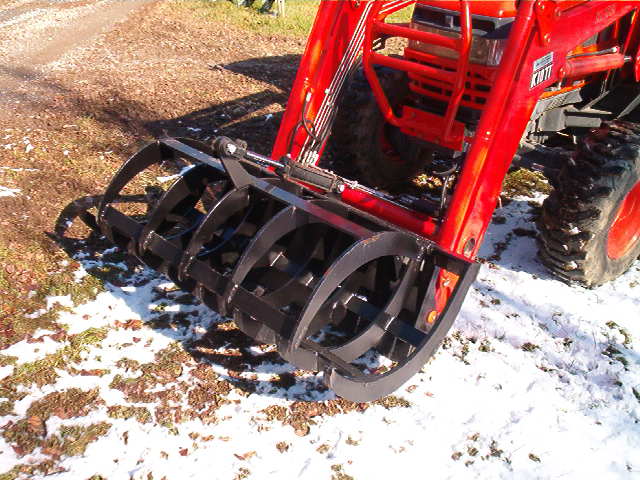

HEY, I'VE BEEN WANTING/RESEARCHING GRAPPLES FOR A LONG TIME. LISTENING TO EVERYBODYS INPUT (THANK YOU) READING PAST FORUMS ABOUT WEIGHT/WIDTH FLAT BOTTOM VS. CLAMSHELL, SINGLE UPPER CLAMP VS. DUAL ETC... SO I DID A GOOGLE SEARCH AND FOUND THIS SITE WEAReduction : Home I E-MAILED PAUL GREEN (GREAT GUY)ON A SATURDAY AND GOT A RESPONSE ON SUNDAY. ORDED ON MONDAY (FROM FLORIDA) HAD IT THURSDAY IN PENSYLVANIA GREAT SERVICE. PAUL KEPT IN CONTACT WITH ME AN GAVE ME A TRACKING # IT'S 60" WIDE ,WEIGHS AROUND 475 -500 LBS, IT'S ALL 1/2" STEEL (NOT 3/8") HAS THE END OF THE BOTTOM TINES DOUBLED TO 1" THE OUTER END TINES ARE 3/4". IT WAS ON SALE FROM $1495.00 TO $1295.00 .THEY DO NOT COME WITH HOSES SO IT MAY BE A WEEK OR SO UNTILL I CAN TELL YOU HOW IT WORKS. THE WORKMANSHIP IS FIRST RATE ITS A SIMPLE DESIGN AND I REALLY LIKE IT . CHECK OUT THE PICS. AND THERE WEB SITE. FRENCHIE.

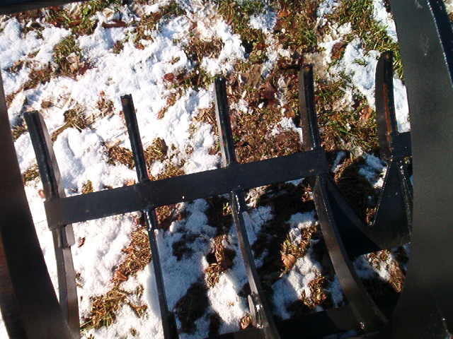

Different looking unit. I wonder how those flat bars between the tines hold up. If your like the rest of us with these things your going to be smiling for a long time!
/ WEAREDUCTION GRAPPLE

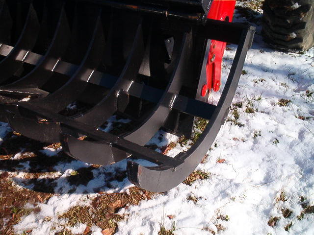

Hey guys, Sorry about the Yelling my wife types with the "caps lock" on thinks it's easier to read? O'h well I leaned something new. I'm going to plumb it off the rear remotes. I got most the fittings today. Thats a learning experience, JIC,NPTM,NPTF,NPSM,BULKHEAD FITTINGS ,3/8",1/2',#6,#8 now I should be YELLING! Hopfully those bars between the tines will hold up they are 1/2"x2" and notched into the tines not laid against them. Check out the center V on the bottom tines it is cut like a knife edge. Nice talkin, Frenchie.

Not to be a party pooper, but the thing looks lightweight (engineered) to me. Looks like the tangs will bend soon.

Ken, I got a shipping quote of 475 LBS and 525 LBS on a pallet. We have scales at work so I weighed it on the pallet it was just over 530 LBS. So I would say its just under 500 LBS his was a big factor for me most grapples that I see with 1/2" tines weigh 900-1000 LBS, Most lighter weight ones have 3/8" tines. when its on my tractor it doesn't feel any different than my bucket.
Jake Only time will tell although as thick as these tines areIi think I'll be ok. When you see it first hand it looks way better than pics. or what you see on the internet. Every seem and joint is fully welded it really apears strong. I will post more pics. when I get all the plumbing done. Frenchie.
/ WEAREDUCTION GRAPPLE #15
On second look, those are some thick tines. Lots of grapples use braces welded along side the tips, yours look pretty beffy. Good luck with it.
