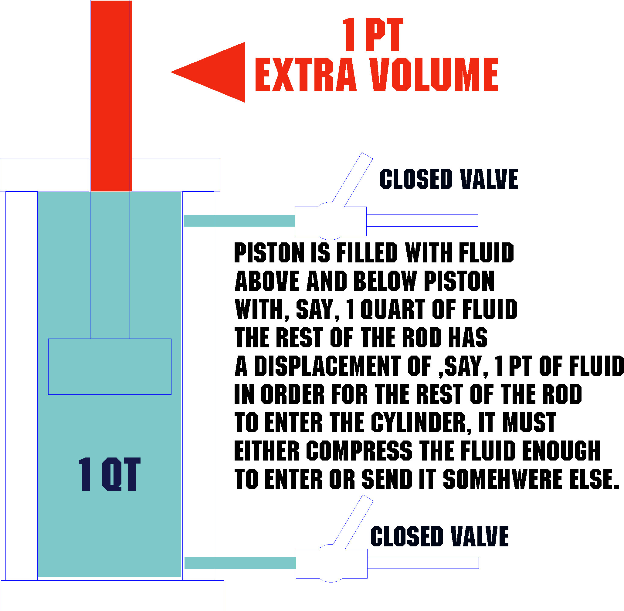

So, basically what he's saying is, for the ROD to enter the cylinder, the rod's displacement volume must compress or displace the same volume of fluid in order to enter the cylinder. It cannot compress that much volume to any extent and cannot displace it because the system is closed off by the valves. So the piston/rod cannot drift, not because of the seals, but because of the displacement volume. I can see that. Ok, I'm going to start with the control valves. Thanks!
This is an excellent animated video explaining why the cylinder won't drift "downward" even if the piston seals are removed and there are no external leaks including the valve. Lots of great hydraulics videos on this channel!
Edit: The irony and, perhaps, confusion, contradictions etc is that the OP's (zete) problem and symptoms may very well be caused by bad (shot) piston seals along with a leaky valve and a pump that is no longer performing to its factory specs.
You seem to have a better understanding now.So, basically what he's saying is, for the ROD to enter the cylinder, the rod's displacement volume must compress or displace the same volume of fluid in order to enter the cylinder. It cannot compress that much volume to any extent and cannot displace it because the system is closed off by the valves. So the piston/rod cannot drift, not because of the seals, but because of the displacement volume. I can see that. Ok, I'm going to start with the control valves. Thanks!
Got it, thanks!You seem to have a better understanding now.
Now re-read my post #22.
