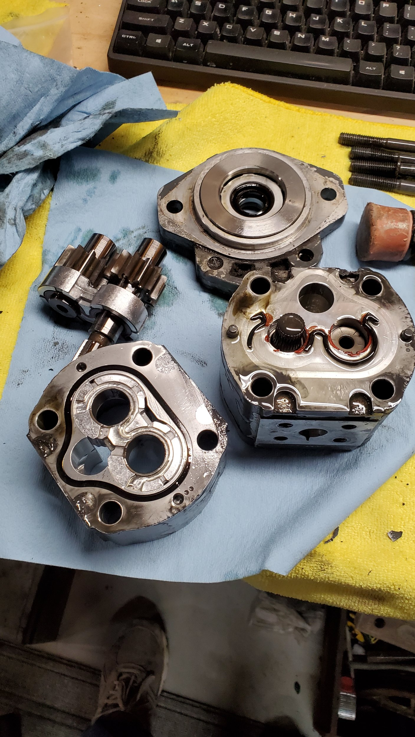

Thanks everyone for the help. I talked to Robertson equipment and the mechanic said he thought the pump was bad also. I removed the pump and disassembled it. First the long bolts that hold the sections together two were not tight (they loosened with finger pressure around the head of the ratchet. Second the seal to the engine was leaking to the point where my engine oil is above the full line. Last the seal between the low and high flow sections was missing about a half inch section of the black rubber and most of the red rubber was gone. It does not look like any signifigant wear to the metal parts. I havnt put the new pump on yet. I am worried about where the rubber has gone. how should i go about flushing the system?

Should be screens on the suction side (in the sump) that are removable and cleanable.
I am not sure what is advised for your machine, after my experience with failed Kioti hydraulic pumps I erred on the side of excessive and fully flush all the fluid and changed both filters. The last pump failure I actually changed the fluid & filters twice, the second time after @an hour of operation. The CK20 holds @6gals of Shell SPIRAX S4 TXM which I get directly from ppc lubricants. On the CK20 there is a large center drain plug with a big magnet and two smaller outboard plugs to drain the rest. Both the pump failures I dealt with (yes I am on the 4th hydraulic pump) were more catastrophic than yours. The gear shafts actually ate through the bearing sleeves and began to destroy the pump case. I’ll try to post some pics. The 1st pump done by the dealer I never saw (civilians are too dumb to understand mechanical things) I was told the cam broke and I was running on 2 cylinders, there was a lot of smoke, Kioti paid for a new cam, hydraulic pump, misc parts and I was billed the labor. Some notes on 1st failure: 1. It happened when I was running scraper blade with the FEL off the tractor so I detached the blade and drove on trailer and dropped at the Kioti dealer to be diagnosed. 2. When I called after 5 days I was told the tractor was split in half, the pump was shot and the cam was broken. 3. After 2 weeks I called again and was informed the tractor was done and the bill was $XXXX.XX, when I started to get hot I was then told I only owed @50% as Kioti paid for all the parts since I was less than a year out of warranty. 4. I reviewed the bill and asked who paid for the 5 gals of fluid and filter & was told fluid was fine & reused never answered about filters. I asked what would have caused and never got an answer.
2nd dealer installed pump failed while clearing snow with backblade and FEL in @ 125 hrs & I replaced, fully drained system, cleaned drain magnet, replaced all filters also noticed tiny leak in hydraulic oil cooler and put into service.
3rd pump failed while trenching with backhoe in less than 100 hrs, fully drained, replaced filters & cleaned magnet. Before putting back in service I had a pigtail made up to fit hydraulic ports with a pressure gauge to confirm correct operating pressure with Bob from Michigan Iron I also purchased a recirculation pig tail hose to connect the rear output ports together so it does not deadhead/labor when the selector lever is put in back position when rear ports not in use. I sourced the exact SPIRAX Hydraulic fluid specified by Kioti corporate and then put back in service for @ 1 hour hooked up FEL and backhoe and ran through all movements to fully circulate fluid then shut down and drained system, cleaned magnet changed filters and refilled.

The new pump is installed. It works great. With the tractor hot (or cold) it will raise the front end off the ground and roll the bucket down lifting the tractor at idle. It will lift my 72 inch grader box to full height with the three point hitch at idle. Engine oil and filter changed. I reset the relief valve to 2600 psi. I will change the tractor fluid and filters after an hour or so.
Kioti had the pump at my door in two days from the time I placed the order. Best service I ever got from them.
Robin asked where the bolts I found finger tight are located. I believe the new pump is a Joy Yang pump. The Failed pump was a Casappa. In the photo below on the left end of the joyang pump is a black socket head cap screw. there are four of them on the the old and new pump equally space on the back plate. The only difference in the fasteners between the pump brands is the Casappa uses bolts instead of socket head cap screws.
There is a thread on here about these screws being loose because the threads pull out of the aluminum pump parts so be careful tightening them on an old pump.
If anyone has to do this job the only pointers are. You have to disconnect all the pipes (suction and pressure) to remove the pump. You cant assemble lines to the pump prior to installation. The large diameter suction pipe does have to be placed behind the pump against the engine before you put the pump in place. The pump to engine bolts have to be installed prior to installing the suction and feed lines. Dont ask how I found this out.
Thanks everyone for all the information and help. I really appreciate folks taking the time to read about my problem and being willing to help!!

Big expense of new pump but glad you got it back to working. Do you think you could have replaced the gasket/o rings on the old pump or was there issues with the metal parts?

We would recommend you reset the Relief Pressure to 2450psi @ 2400rpm.
The pump is most likely repairable if I can find a seal kit. Minor wear on the metal parts I think I can clean up the scoring on the sides of the gears. There are some threads on here about availability of seal kits and my dealer did not have a part number for one. I need to check the female threads in the housing to see if they need a helicoil. I am not throwing the old one out just yet I may rebuild it and keep it for a spare.
