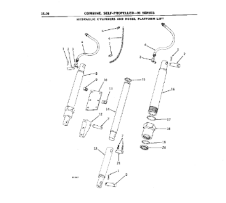

I curious how you would apply your theory to a combine platform lift cylinder that ""never had a piston or piston seal? Item 15 is a snap ring not a seal.
   / Weak Loader; won't stay lifted. #40
and I curious what you are asking. A combine platform lift cylinder would normally have a cylinder rod somewhere in the area of 2" to 3" diameter which also serves as the piston. There are normally a pair of them and, in some cases, they have to be changed out to even larger diameter cylinders as the combine headers available today have become "even larger" also.
No seals required on single acting cylinders other than within the gland.
Edit: This does not apply to double acting cylinders being used as single acting. That case requires seals on the piston as any fluid getting past the piston would leak out of the rod end port. The rod end port could be plugged and the cylinder would work but, again, its output force would only be the result of the rod area times PSI.
