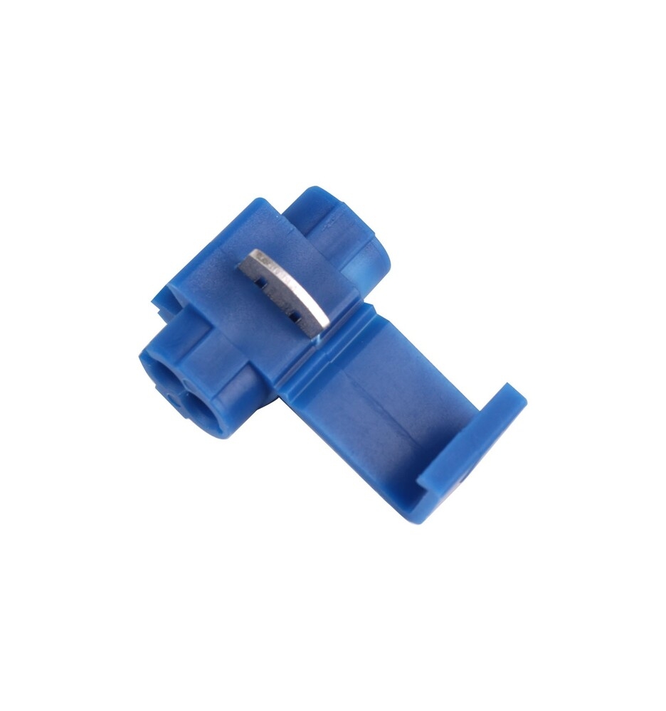

I remember you saying the brakes on your other trailer were still working, so the truck is out of the picture. I agree the most likely problem with the break-away in the electronics of the battery box.
At least you have crimp connectors, all the connections on my trailer when it was bought were vampire splices like these.View attachment 809028
IMHO they should outlaw those things, the way I see it manufacturers use them for cheap fast connections that will work long enough to get the trailers off the lot.
I cut 21 of those things out of a trailer I use to own..I then had no problems in the next 12yrs I owned it.

Ya cheap connectors... If there's enough wire cut them out and use better connectors....
I,ve completely re-wired many trailers over the years, and never use those useless connectors. I might use one to repair some wiring that got damaged on a trip, but it would only be a very temporary connection. I solder all the splices and connections, and use water tight heat shrink tubing to keep moisture out.
I totally agree. My trailer came with those. First thing I did when I got home was replace all of them with shrink wrapped butt splices.
Surprisingly enough, dealer approved repairs have gone from solder and shrink wrap to silicone filled butt splices with the heat shrink as part of the connector.
I no longer get supplied with plug pieces when needing to replace a sensor plug on a wiring harness. I now get shipped the plug already put together with a 4" pig tail instead.

Look for rust on the 2" receiver housing. In my case, the Dodge Ram 2500 came with a 2.5" receiver with a 0.5" spacer so it would accept 2" receiver components. That sleeve and the trailer hitch connection collected water and rusted, breaking the circuit to the trailer brakes in my case. Like a light switch some turned off I went from excellent brakes to absolutely nothing!
If you are grounding through the trailer hitch instead of the trailer wiring plug, you are doing it wrong...

I added trailer brakes to my trailer. New hubs, bearings, backing plates, battery box, brake away, etc......
One thing I did was run a dedicated ground for the brakes on each side. Ground wires were grounded to the frame, but also ties into the ground wire for the trailer plug.
Didn't take much more effort to run the extra wire while running the power wire for the brakes. And seems to have given me more reliability with the trailer brakes.
