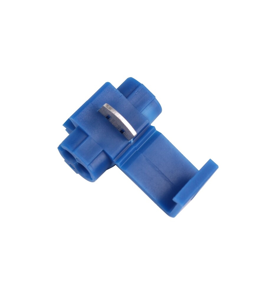

I can't believe in 9 pages of posts that no one has suggested putting an amp clamp on each brake and comparing the readings. Someone suggested that each wheel should draw around 3 amps. If one or two wheels are low, then focus your attention there first looking at each ground or splices at each axle. If all are low then look at the wiring from front of the trailer to the first splice point. Fix or rewire to get rid of sketchy crimp splices or Scotch locks which will be a constant source of failures. And forget about the emergency battery for now. It doesn't serve any purpose except when the trailer departs from the truck. The OP gave all the information to find this fault when he said that all was well with the other trailer. I do automotive electrical diagnostics and would love to have a job this easy in my shop.

I bet its where the trailer wires connect to the axle wires... The battery does nothing until the breakaway switch is actuated....
   / Weak brakes & battery box confusion.
#86
I noticed there were non-weatherproofed crimp connectors there.
   / Weak brakes & battery box confusion. #87
Ya cheap connectors... If there's enough wire cut them out and use better connectors....
At least you have crimp connectors, all the connections on my trailer when it was bought were vampire splices like these. Vampire.resized.jpg
IMHO they should outlaw those things, the way I see it manufacturers use them for cheap fast connections that will work long enough to get the trailers off the lot.
   / Weak brakes & battery box confusion. #90
Absolutely! Heck, they are lucky if they work that long. I’ve done trailer shopping in the past where not all of the lights worked and the sales guy tried telling me (or the person I was shopping with) that it HAD to be an issue with the vehicle, since ALL of their trailers get tested EVERY morning. Right…and you guys only use the top of the line tires on your trailers correct?
