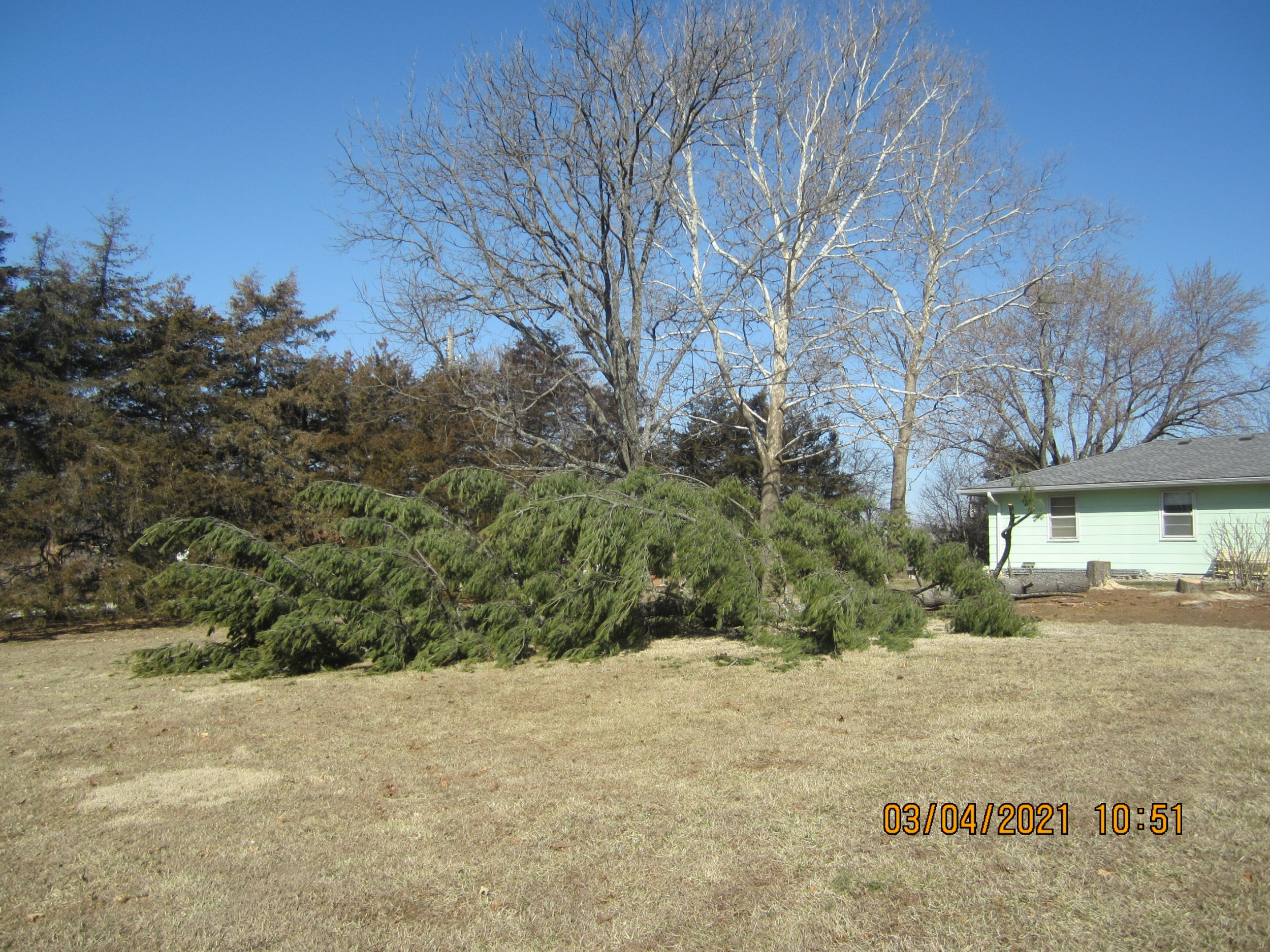

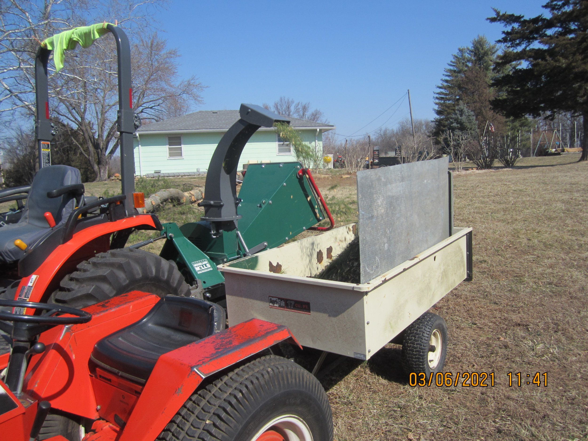

In about 40 hours of operation, my WC68 has had a clogged chute only once. That was the time that I ran a lot of green White Pine branches thru it. Normally I burn the pine branches, but this time I wanted to just run them thru the chipper. I won't do that again. It was no big chore to hand dig the sappy sawdust out of the jam.
