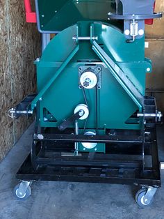

The Woodland Mills chippers come inside a box but with a metal reinforcement frame inside the box.
Here are pictures of what we made with the metal frame. The top was made into a table. The bottom was made into a dolly to sit the idle chipper onto to allow rolling it around. Cost me $70 for 300 # metal castors from TSC and $100 to get them welded.
You can also see the 2 by underneath the front of the bush hog with steel casters underneath it.

The table and skid were good practical ideas. Nice.
Got it on the dolly now. Should have had them weld another metal piece or two across the hole in that bottom structure. In shipment, they had a couple upward pieces of metal to keep the unit from slipping into the hole, but these are not consistent with use of it as a dolly; had the welder cut them off. I'll get a piece of plywood and a couple pieces of 1 by to screw to and put plywood over the hole.

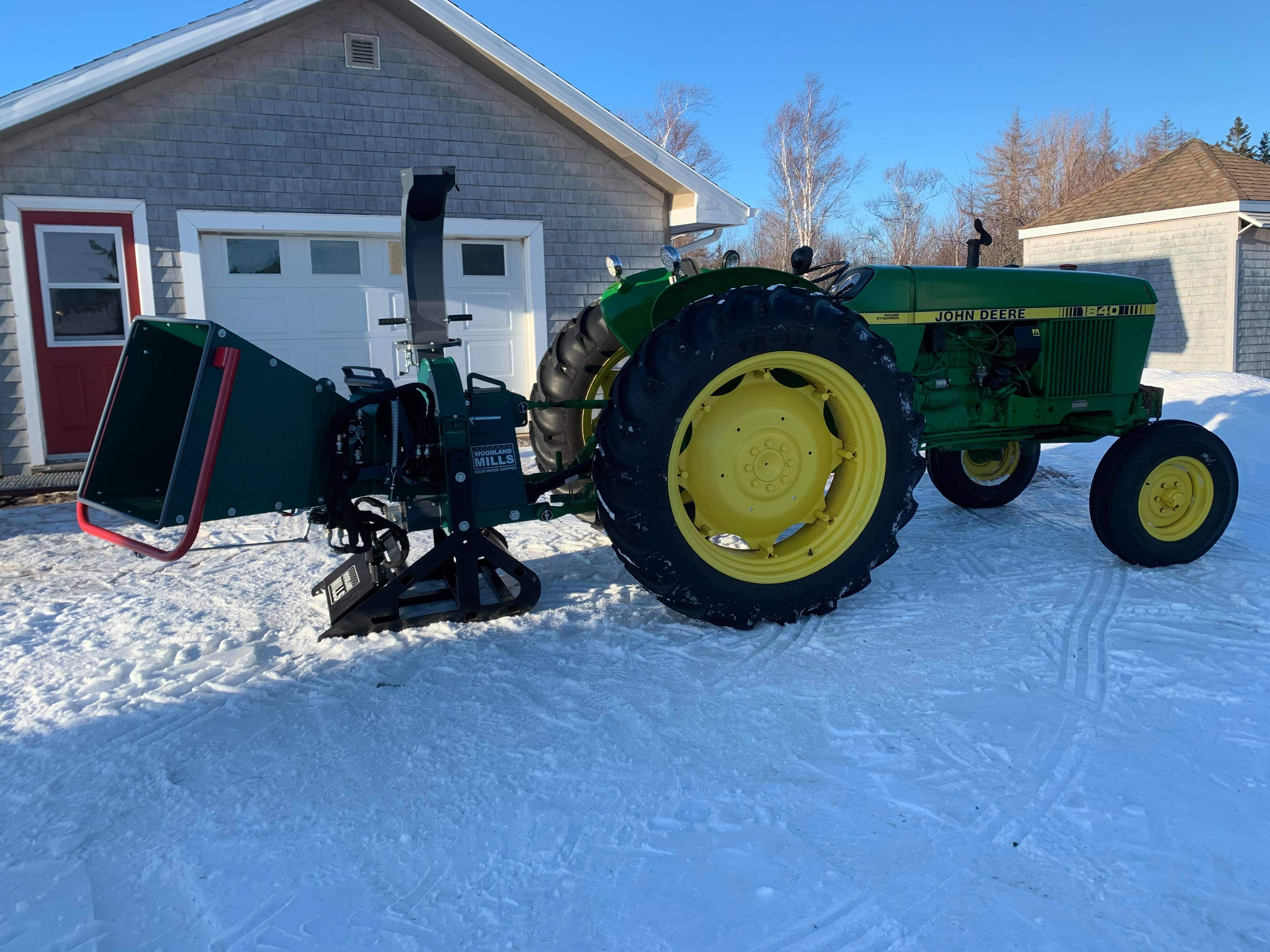

Finally got a good gap without snow so had a chance to mount the WC88 and tomorrow will give it a functional check in the woods. With 60 hp at the PTO it should not have any problem.

Nice machine for your big tractor. The WC46's 510# weight is very noticeable on the slope behind the house. The 2025R would not be safe with a bigger machine.
I bought a 4x4 piece of 15/32" plywood and cut it to fit into the dolly. Covers the whole inside part and that hole.
