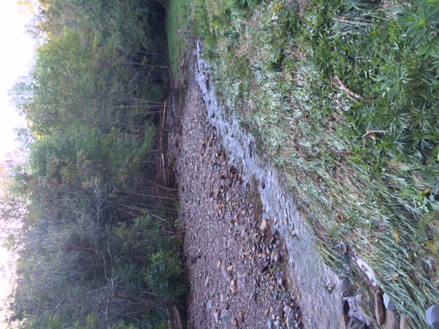

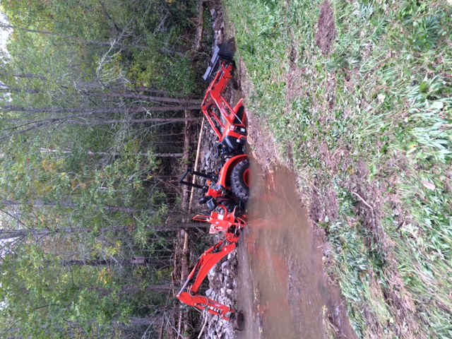

Seen of the crime . This used to be a hayfield until we got 6 inches of rain in about four hours.image.jpegimage.jpeg
/ Water logged DK35 SE #15
Wow that's quite the washout, we didn't get nearly that much rain.
