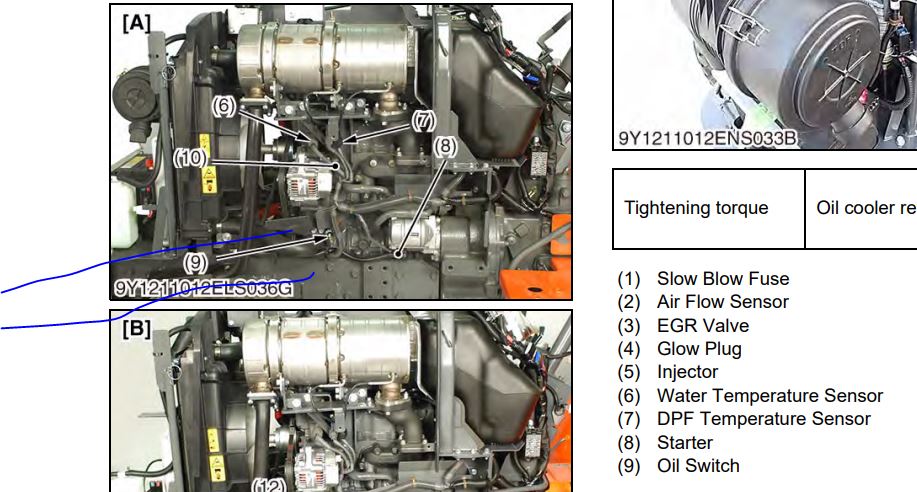

1. How old is it? 1,200 hrs could be a 2014 or 2020.
2. How did it get a hole in the tube? And where in the tube?
1. I have owned it for two years - Bought it new
2. Dealer says it was in a small tube beneath the engine. Not sure what the tube function is. I assume some sort of return or sensing tube. No idea how it was caused. Could have been a stick hitting it.
Thanks
I do not disagree with you completely. I also understand that most engines work on this premise. However, I do not know a single person that opens their hood on a car or tractor and checks the radiator for fluid prior to operating. If the fluid all leaked out while parked, how would anyone know. We always checked fluids, oil, radiator reservoir etc regularly. No obvious sign of a problem
The critical question is what caused the tube to fail? The causal part will be the tube, the cause of the failure is what determines warranty eligibility.
I had a customer bring in an L3901 because the DPF would not regenerate. Turns out he had run a stick through the radiator which drained it and the water jacket in the engine block. The temp sender would not read air temps, would not allow the regen to proceed due to low coolant temp. Why he did not cook the engine I will never know. His insurance paid the repair, not warranty. In that case and this, a coolant leak amounting to over a gallon of fluid should have been seen or smelled.
Lacking the opportunity to inspect the damaged tube it is impossible to speculate on warranty eligibility.

I'm guessing since the OP hasn't offered any answers in regards to this mystery "tube".
I'm guessing it's the tube from the coolant reservoir to the radiator.
When the engine gets hot it expels any excess fluid thru this tube to the reservoir. After you shutoff the engine and it cools it sucks the fluid back into the radiator. Great setup. When everything is working you never have to top off the radiator. It reuses what would normally be spit onto the ground.
If the tube has a hole it will expel the heated fluid onto the ground. When the engine cools it cannot create a vacuum and refill from the reservoir. It only sucks air thru the hole. Eventually an overheat situation will occur. Very possible that the gauge won't reflect this.
